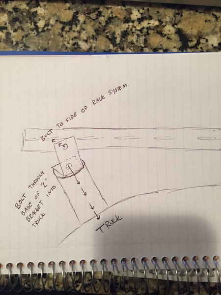

    thats cool bro. i hope more people see this. definitely beats spending hundreds. now its time to go measure. need to see exactly how tall to make these spacers

    Okay, here's my question. Why are you running the strut sideways? How do you plan to mount the cross members to it? I think I understand your idea but I might be confused on how you plan on designing the rack. Are you not having it extend past the mounting holes?

    I was thinking he would still a hole in the side of the strut

    so the vertical portion of the "L" or "U" bracket will be holding the side struts in. yes, i will have them go past the spacer maybe 2 inches. just enough to leave space for the bolts to connect the struts that run over the car.... get me?
    and i will drill a hole into the side strut, and run a bolt through the L or U bracket, through the strut.

    Ahh, yep that would work.
