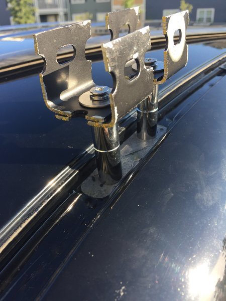

    Rough draft for front mounts.
    So far:
    2x 1 inch spacers stacked in top of each other for each hole.
    6mx70mm bolt through each.
    Washer, lock nut
    Looks and feels decent. Things I need to change, I need a 80-100mm bolt. Need more grab. And I'm wary about stacking 2 spacers like this. It looks and feels fine. Just sketchy to me.
    Thoughts?

    1,850
    Edit post:
    After crossing front to back and side to side I will need about a 3 inch spacer. Didn't account for the distance under the weather strip. I will be going with a cut pipe st 3" for a spacer

    #158286
    1,850
    I had them at 2" from the base inside the weather strip. Which was only about 1" above the roof edge by the mount. The roof curves up slightly, so 1" isn't enough. I'm going to cut pipe to 3, mount the rack and see how much clearance I have. Then cut down the spacer respectively.
    But I'm looking for a 6m bolt long enough and that's giving me problems.

    #158286
    1,850
    Well no hardware store near me has m6 bolts long enough to run through the spacer. So I might shorten the spacer and make the "L" bracket a lot taller. Just need to find one that's more sturdy.

    #158286
    1,850
    Well the spacer I have now is 3". I plan to mount it all, and cut it down depending how much clearance I have on the roof.
    But there are plenty of 3" 6m bolts at the stores around me. But the thread only goes up 1 inch. So if I shorten the spacer, the bolt won't be able to tighten any more... I could just add washers under the head of the bolt, but I'm trying to keep this clean. Lol.
    I like the idea of a longer "L" bracket anyway. It will look better IMO.
    Sorry for all the long winded and somewhat pointless updates. I'm just trying to keep people updated in case they are trying to do the same thing.

    2015 SR5 Access Cab 4x4 V6
    TRD PRO Grill, mobtown offroad recovery bar, SCS Ray 10's
    If you own a tap and die set you could run the threads all the way up the bolt to what you need.

    '21 Army Green TRD OR DCSB
    Car seats
    Would 2.5 work instead of 3? Or is the spacer going to be somewhere in the middle.
  20. Sep 29, 2016 at 6:48 AM
    #380
    CO_0321er
    CO_0321er Well-Known Member
    Jun 27, 2015
    #158286
    1,850
    That's what I am trying now. 2.5" from bottom to hole where the rack will sit on. It looks very close. But I also got some washer I'll throw under the "L" bracket if I need a few more mm clearance.
