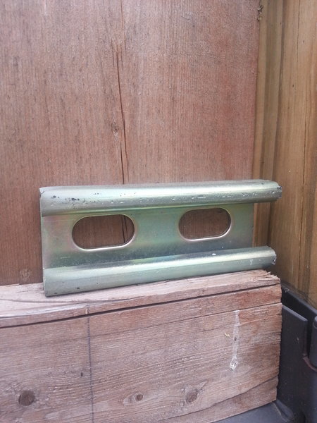

    Thanks, that just happened to be the added bonus when I stumbled upon this product. What really sold me was the coating that is on it called Galvagold, I think. Its a zink coated galvanized product.
    I've had a piece sitting out on my fence raw for the last 4 months and looks great.
    It may take me awhile but I definitely have more planned for both interior and exterior... Stay tuned :D
