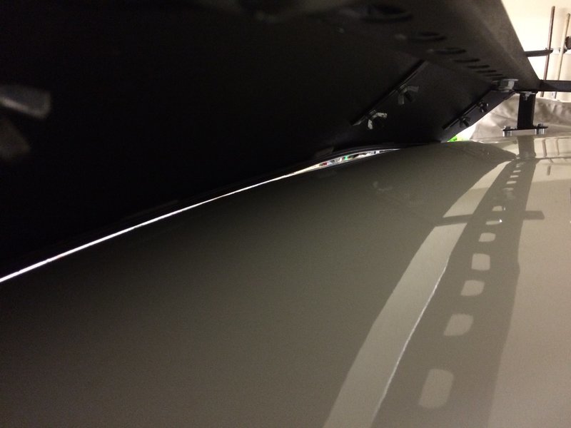

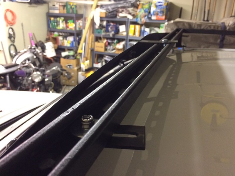

    Okay so here's my update. Had to junk a lot of hardware I bought cause I couldn't get enough height. Waste of money :frusty:
    But I went with 3" spacers (galvanized pipe cut). And I cleared the roof. It has a slight forward lean to it. But I can live. What do you think about the space between the roof? Only about an inch.
    I just need to find long enough bolts to go through the spacers.
    (Pictures of progress so far. I know it's not all clean yet. I'm just getting measurements and test fitting)

    I think the inch gap is more than adequate. could even tuck it in more if you wanted.

    That's about the same gap I have at that point on my rack too. I think your good to go as well. Looks great man can't wait to see it all done. Some fine on the fly engineering going on in here lately! :thumbsup:

    So I have everything made and test fitted. All good :)
    I'll be busy this weekend. But I will post up pictures of completed project when I get it all painted and done.
    I used a 3" pipe as a spacer. Used two "L" brackets to make a "U" on each spacer. And it slides right into place.

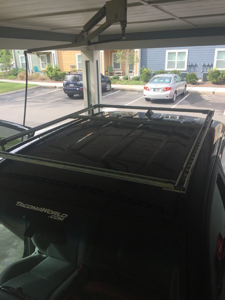

    Here's what I did. This was intended to be a prototype, I just haven't gotten around to building the real deal. I need to alter the shape of it and cut it out of some thick ABS or aluminum. IMG_3327.jpgIMG_3326.jpg
