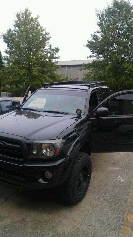

    Trying to get homemade brackets to bolt into the top and save the weather strips are a pain. Hard as piss to find a M6 bolt longer than 3" around here to lift the rack high enough that there is space between it and the cab. Finally got 3 brackets on each side in place but had to cut one of my weather strips to go around it. Gonna have to silicone around it good tomorrow. Going to drill side holes through the rack tomorrow to bolt it up and hit it with one more coat to cover up the scratches I made moving it around. Should have the rack up tomorrow then it's working on my side pieces to cover the mess. It's hard to do when you get home from work at 6:15 and it gets dark at 7:15 without a garage.

    Driving around this morning with 6 random redneck mounts coming out of my roof! Where did you all find your aluminum side pieces for the design long enough. Every hardware store (Lowes, Home Improvement, Ace, etc.) doesn't have a piece cut long enough? Looks like I'm going to have to find a metal business to cut me some.

    Waiting on the side fancy parts to dry. I'M definitely going to have to put a front on it. Has some wind noise.
