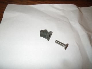

    Those rivnuts look pretty interesting.The last time I was at our local junk yard to by the rails and rack I have now I grabbed a couple of the factory inserts from some sort of minivan I took the rack from but I don't even know what these are called,they are rubber with a nut inside rubber_zpsugj4scby_51b1cca6201ebf915a7ab3b7183fe0c9567645f8.jpg

    I google plus nuts an just found metal ones,any idea where to find rubber ones,I pretty sure these were factory installed..

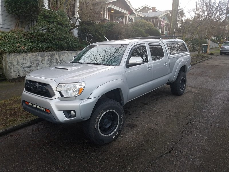

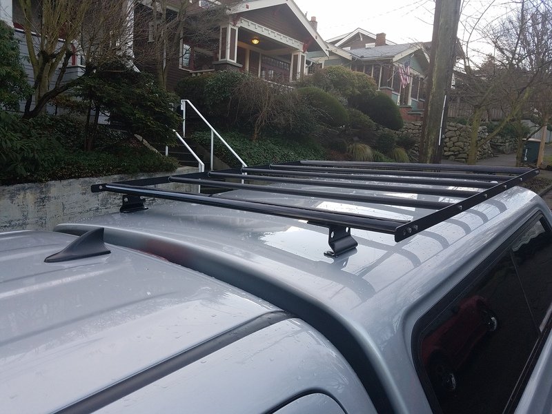

    Here's my take on this. I already had a VanTech J1000 rack on my canopy, so used that as my base. The sides of the crossbars each have two threaded holes in them,
    The sides are 1/8x1.5" flat steel, the round cross bars are 1" conduit. To attach them to the side rails, I used plumbing end caps that fit inside the conduit. Then everything got painted with Rustoleum spray-on bedliner and assembled with stainless hardware.
    When I was building this, the steel sides seemed pretty strong and a good size. However, once I mounted it on the truck, it seems a bit "dainty" now, and not quite as solid as I was hoping it would be (if I grab the sides and try to shake it, I can get more flex out of it than I'd prefer). So, I'm going to have to re-do that part sometime soon (probably with angle iron instead of flat), though it is plenty strong for what I will be putting up there (kayaks and some recovery tools).

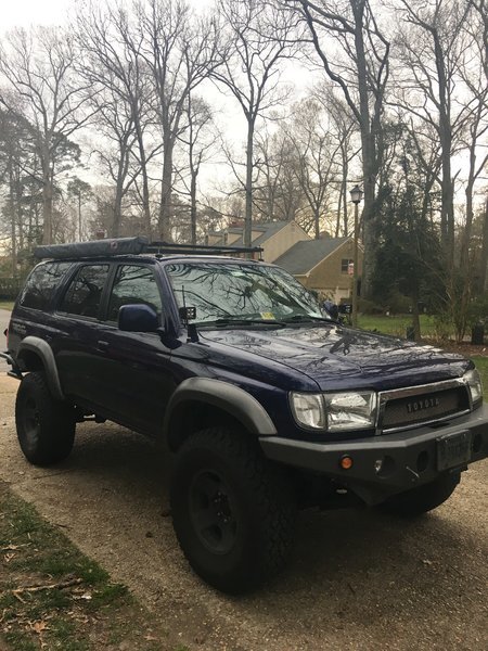

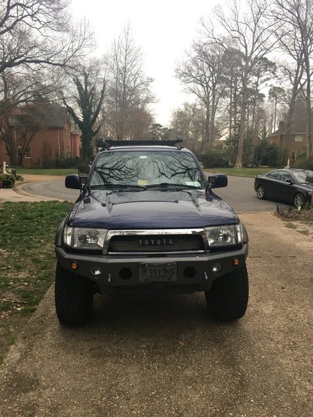

    Add slim one row cheap LED light bar to rack. One pic off. One pic on.

    I'm wanting to add one to mine as well. How did you run your wiring?

    Their a little channel running down side of windshield. That the wires fit perfect.

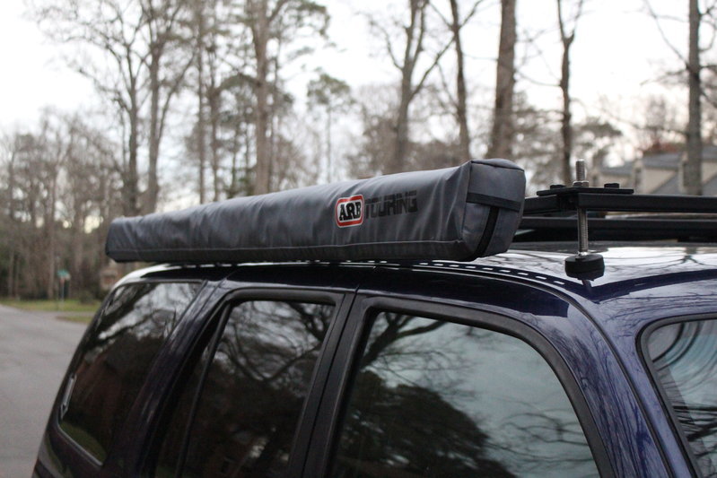

    Finished up the rack and mounted my awning to it. Looks good and feels very sturdy. Excited to load it up in the next few weekends

    Looks awesome Matt! How was the hookup for the awning, did it go smoothly, seems like there wold be plenty of options out there for hangers.

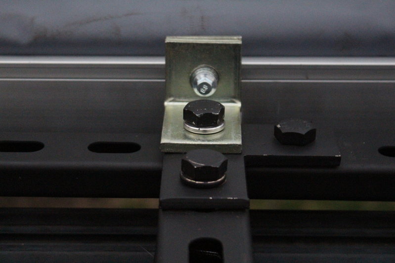

    Very easy. I used some of These off the rack and into the awning. Bolted up very nicely
