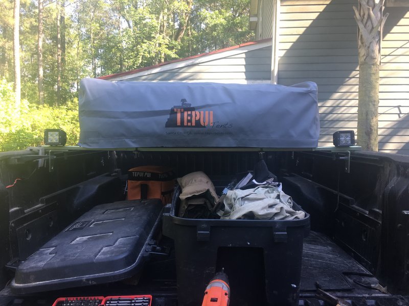

    has anyone on here used the unistrut to make tracks for the shell? I'm about to trade my bed rack for a shell with no tracks. if you didn't use unistrut, what did you use?
    also, anyone here with a topper using an RTT? I'm slightly concerned about the weight on a fiberglass topper. looking at an ARE Z series. I've seen tons of people doing it, but also dont want to crack my shell...

    @12thmanhawkfan has onever on his and @PHTaco had one on his as well...I think. I don't have one, but if I did I'd put it up there and not think twice about it. I have struts on the interior of the cap as well which I think would help too.

    I have put my RTT on mine several times without issue. My shell has a reinforced roof, so I can't tell you it would be fine without. Unistrut would be fine for the track, but IMO the Yakima or similar track system makes for a cleaner install. There are pics of mine somewhere in this thread.

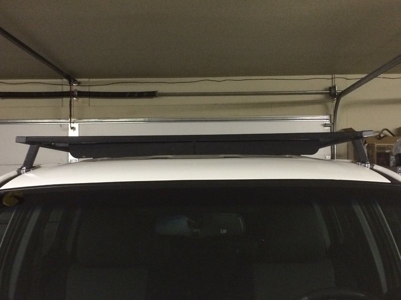

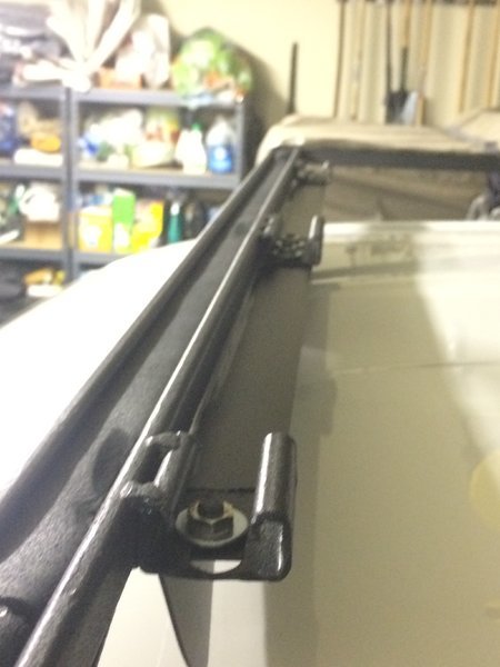

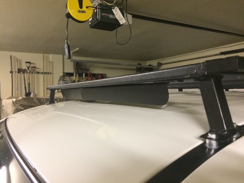

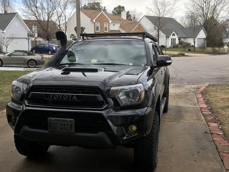

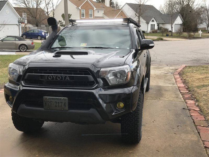

    So a buddy of mine bought a Front Runner rack for his 100 series Land Cruiser and swears he has less wind noise with the rack than without. I pulled my front rack off a few months ago because I just couldn't deal with the noise anymore. After hearing his story, I ordered a wind deflector from Front Runner, and it is 100% better. I had to weld a little more unistrut to my front bar to make it work, but I'm stoked with the result.

  7. Apr 21, 2017 at 6:53 AM

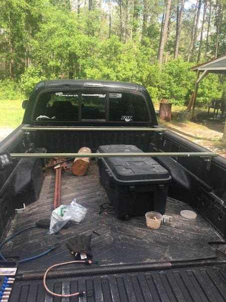

    This thread inspired me to make my bedbars from unistrut for my RTT

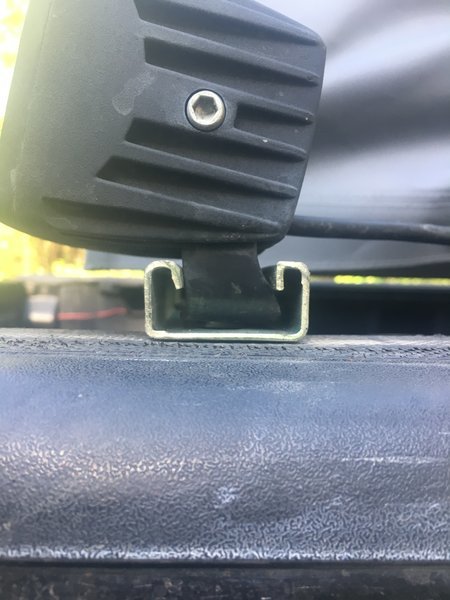

    Figured out that led pod bases snugly fit into the channel of the unistrut

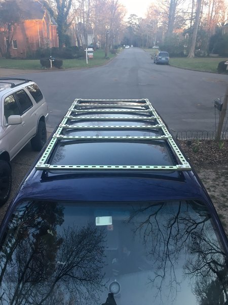

    Hi, everybody is making some sweet racks in this thread, but I was curious as to how people were mounting them to the roof of the cab? Is there threaded holes or do you have to drill? And what is everyone using for brackets for mounting?

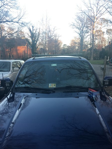

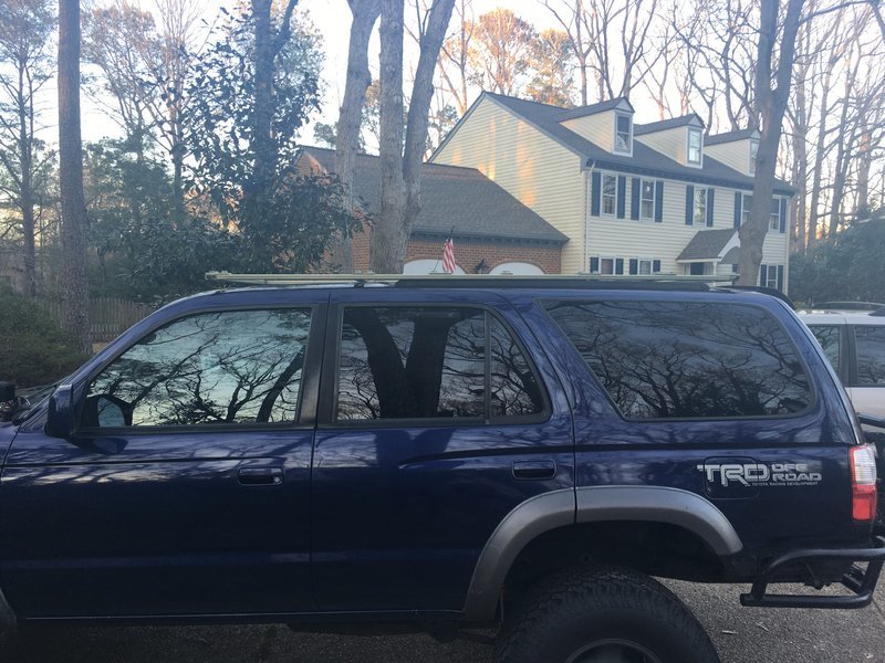

    Looks great! i'm starting to build mine today and planning on putting my rtt on it. the thule bars just sit too high. can you explain how you mounted it to the factory tracks? what did you use?

    How are folks accounting for the left-to-right, front-to-back curvature of the cab and cap when mounting?
    I guess it's not a problem if you only have four mounting points. But if you have six mounting points, you need to have some room for adjustment. Otherwise, you end up with an arched rack and stressed mounts once everything is buttoned up.
