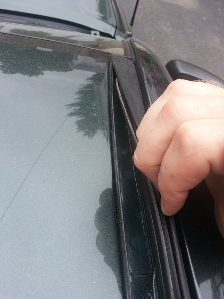

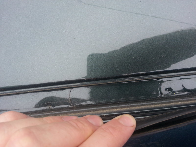

    Stage 3: The Cab Rack
    So I got around to taking some measurements this past weekend finally! I have a pretty good plan in my head as to what I'd like to do for my cab rack I'll be building to compliment the cap rack. Over the years I've seen many designs that are functional but there's only been one that when I saw it it looked to me like it would function for my purposes. A few years back @ragincajun35 had a front runner special ordered for his access cab. what I liked about it was that it only spanned the rear half of the cab, which is all i'm looking to do here as well. I find myself often running long items, mainly dimensional lumber using my truck and rather than having them extending off the back I figure it's safer and easier to manage if I had them more centered over the middle of the vehicle spanning both the cap and the cab of the truck.
    The cab rack dimensions will be;
    Width - 47" (same as Cap)
    Length - 34"
    I think I'll run 4 crossbars total possibly 5 depending on spacing. I took some measurements of the rivnuts mounted in the roof and others can correct me if I'm wrong but I ended up with the following;
    2 rear rivnuts - 2.75" apart
    center rivnut - 17.75 apart from the 2nd rivnut in the rear of the cab.
    For my purposes this was all I needed for measurements and I'd like to thank Doc and Joe @DrFunker and @Blackout14 and @Boogyman for helping me figure out how to get at them as well as supply me with some much needed newly discovered supplies (Doc). :D:fistbump::cheers:
    Something that was extremely helpful that I did not realize was that the rubber moldings on the roof are not stuck down across the length of the roof with adhesive as I figured they were. I was able to just simply pull up on the molding from the middle and take measurements.
