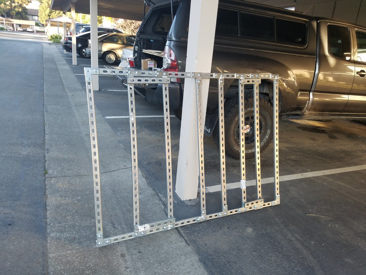

    Thanks for getting back to me. I ended up taking a stab at making one, it was a little over the weight I wanted at 55 lbs. Mine was a bit longer (64") and I have too many of the unistrut cross bars.
    I'm going to try removing the last 4 cross bars and shortening the length of the rack this weekend.

    Yeah, that's a lot of cross members. If you can find an aluminum material to substitute you can cut down on a good amount of weight. I happened to have a few broken aluminum easels that had useable parts for my application.

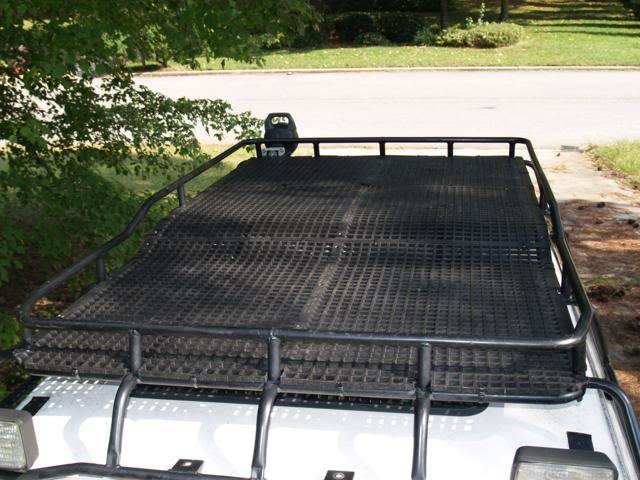

    I've been wanting to build one of these ever since I got my cap a few weeks ago, but finally just took the time to read the whole thread, and I'm glad I did. I absolutely love the DIY design and how damn versatile the unistrut is! One thing I may add to mine is a mesh flooring. I got this particular material idea from Overland Bound. Apparently this overlapping chicken coop flooring is stout as hell, and pretty light. One guy put it on his rack so he can stand and take photos from it, and it doesn't deflect.
    https://www.farmtek.com/farm/supplies/prod1;ft_building_materials-ft_mats_flooring;pgha2215.html

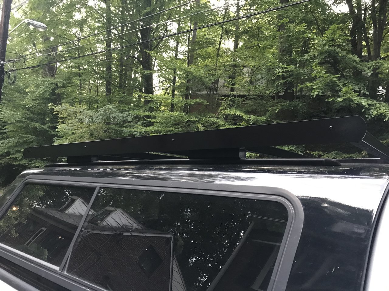

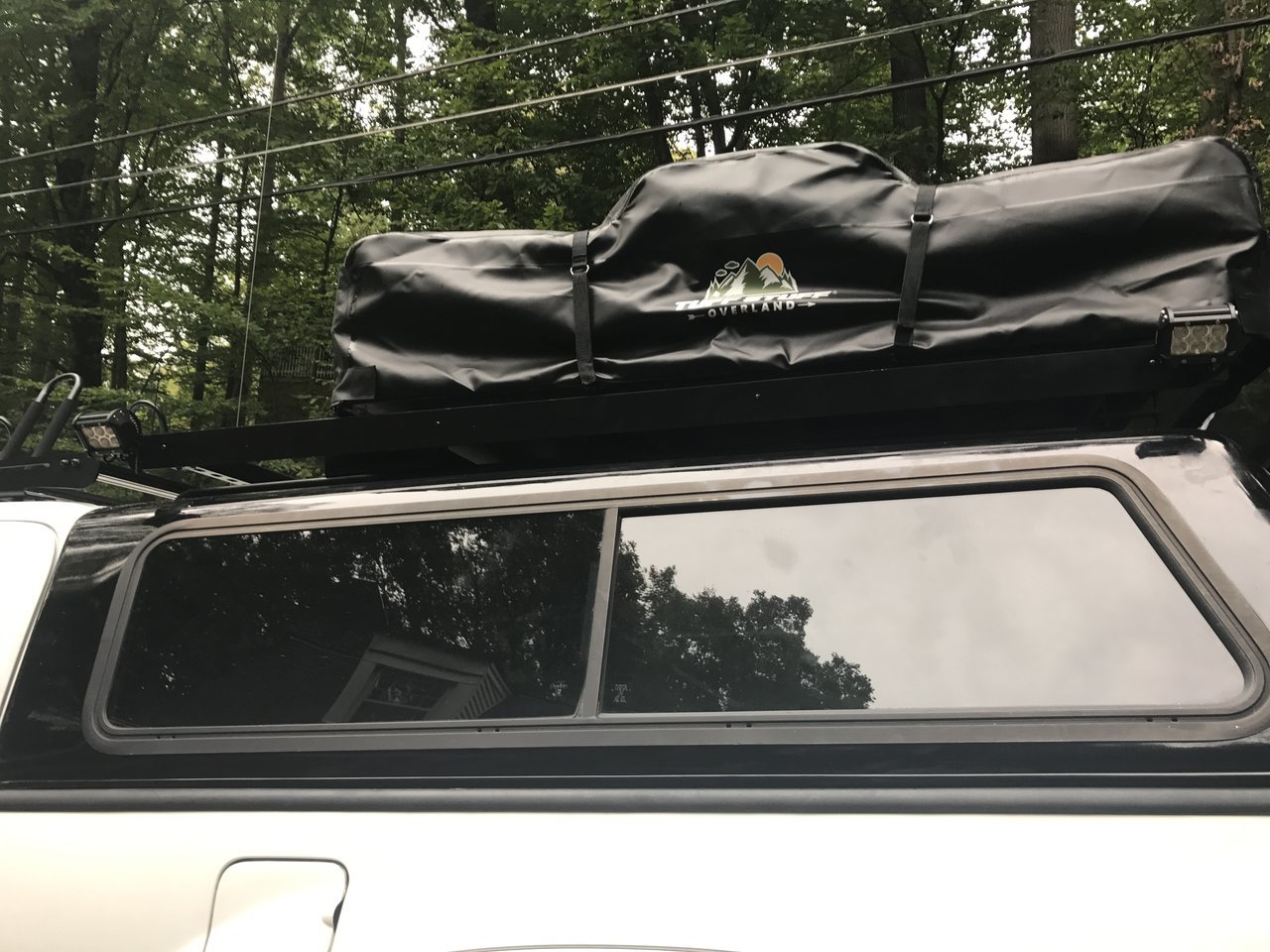

    I don't think I ever actually contributed my final product to this thread! Just put it through the first test by taking the truck wheeling with the RTT and the rack help up great. I will say that the decorative side pieces make a hell of a lot of difference, and highly recommend them. I ordered mine online as I couldn't find anywhere local.
    https://www.onlinemetals.com/merchant.cfm?pid=1129&step=4&showunits=inches&id=997&top_cat=60
    I bought the 72" long one and rounded the edges with my angle grinder and a flap disc.

    I did use the same screws as him, and I wish I would have used regular bolts instead. It would have been easier to get them tighter. I did use nylock nuts in addition to the regular nuts on each one, so it won't come undone at least.
