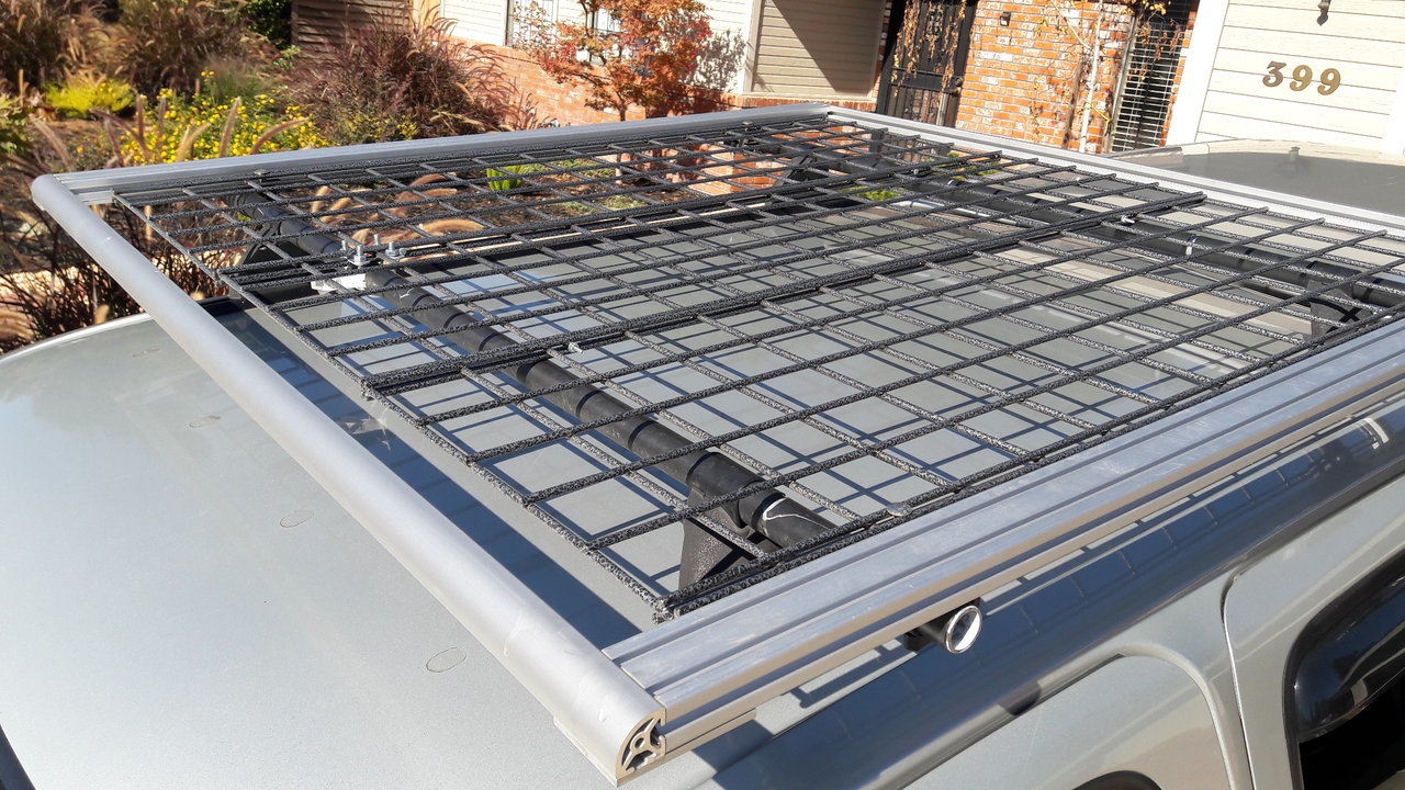

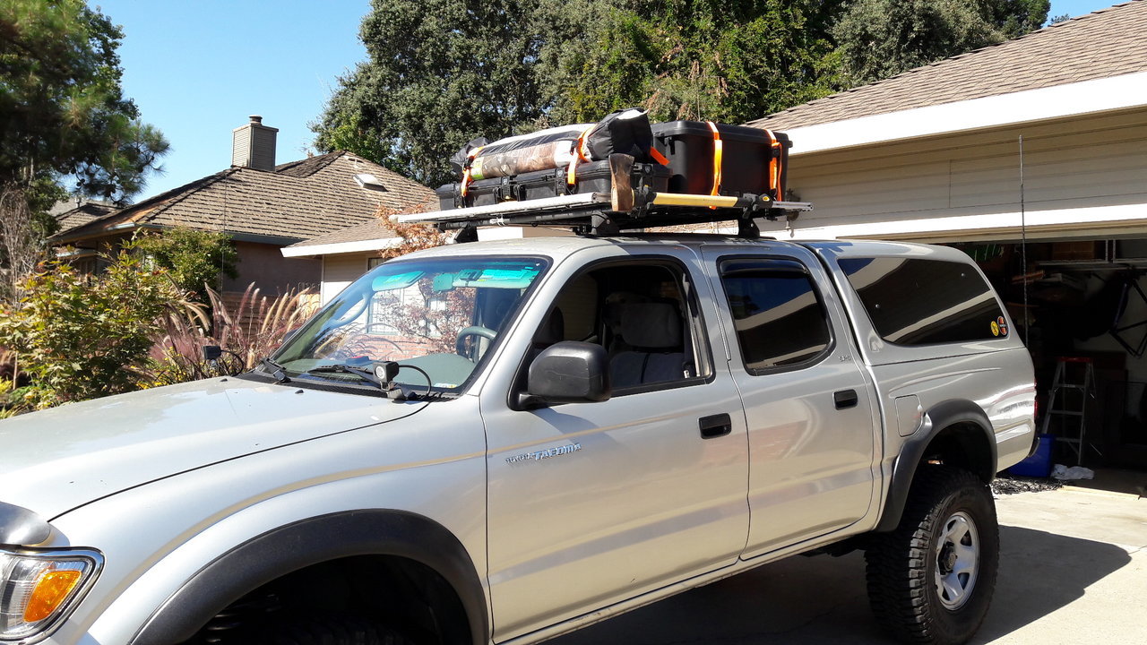

    I used 1x2 10 series t-slot extrusions from tnutz for my work-in-progress. I have 4 more pieces I'm going to run perpendicular to the crossbars. The steel wire grid is a temporary solution, but it works great. The t-slots are great for mounting just about anything.

    i may be missing something(most likely) how are the racks attached to the roof? they appear to bolt into the fact holes

    2002 Land Cruiser
    Yes on mine they are bolted into the factory rivenuts under the rubber molding on the roof. I'm not sure if the 1st gens had them though? I had to fab up risers out of pipe cut level on top to account for the slight angle of the roof line at the different points where the factory mounting points were located. I actually have a design for a front one to be made out of formed steel I just haven't made it yet. Only exists in cardboard form right now.

    No factory holes for first gens. Dealer-installed Yakima tracks.
