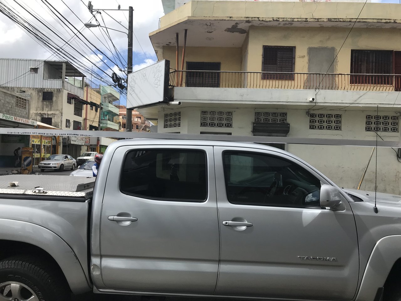

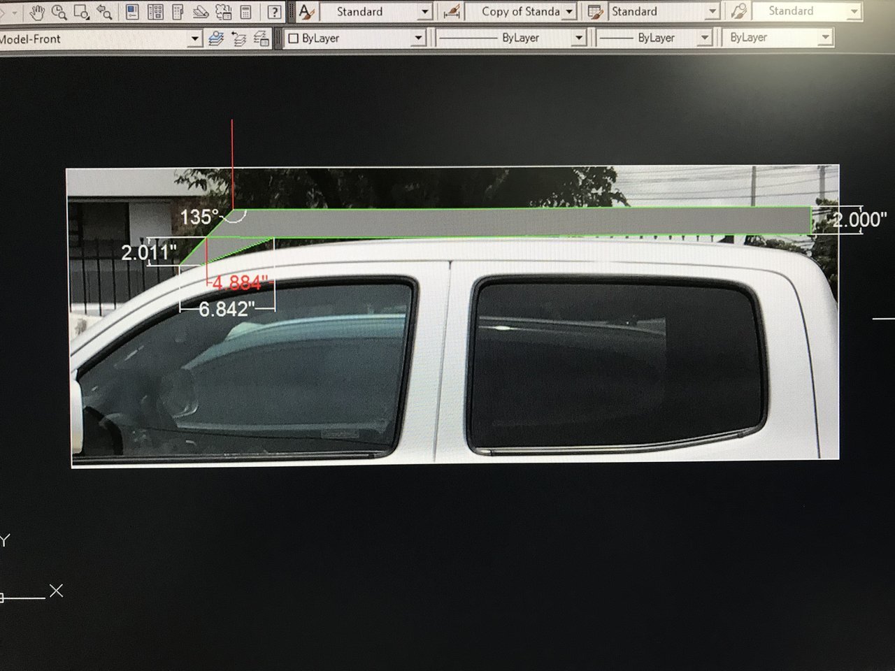

    Drawing something. The idea is to have two independent rails, just like OEM, and detachable cross bars to avoid wind noise when not in use.
    This is a 2” , 1/4” aluminum angle for rails.

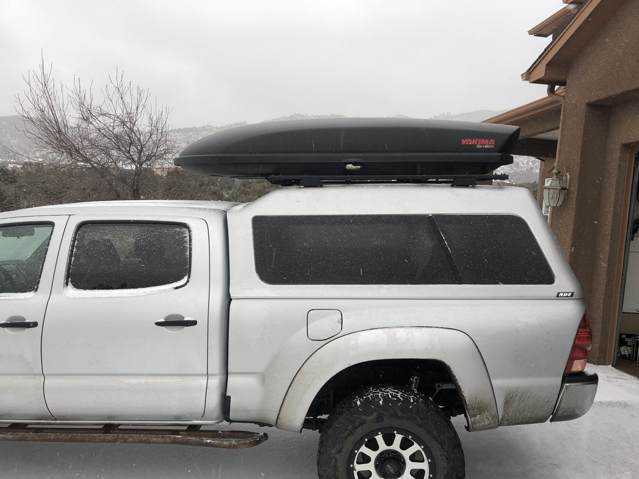

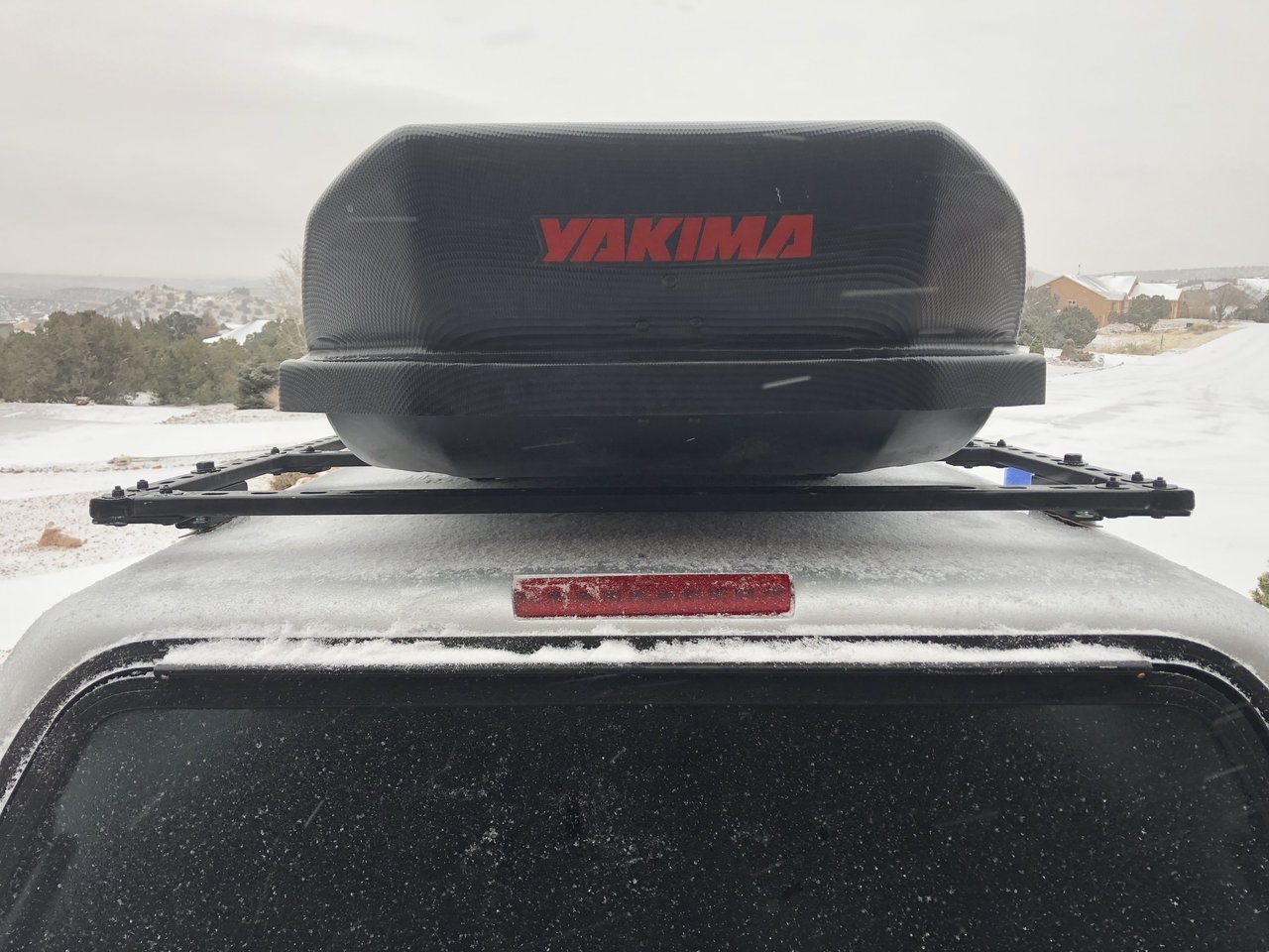

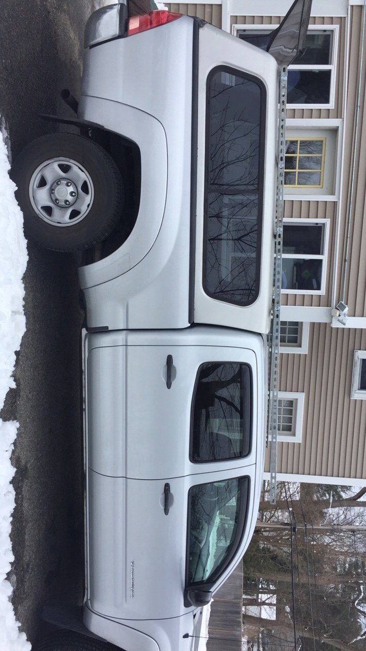

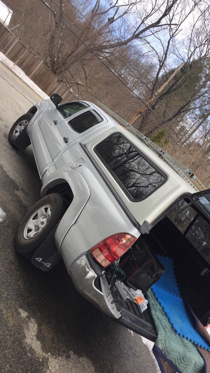

    Gave my go at this project and I love the way it looks. I will eventually do the side panels to cover up my not so pretty mounts. My cap (mid height A.R.E) doesn’t have a flat spot anywhere on it so I had to improvise. It is still sturdy as hell and will love the space up top for skis etc and allow space for the dogs in the back.
    Thanks for the write up.
    Total cost for me with paint was ~$175

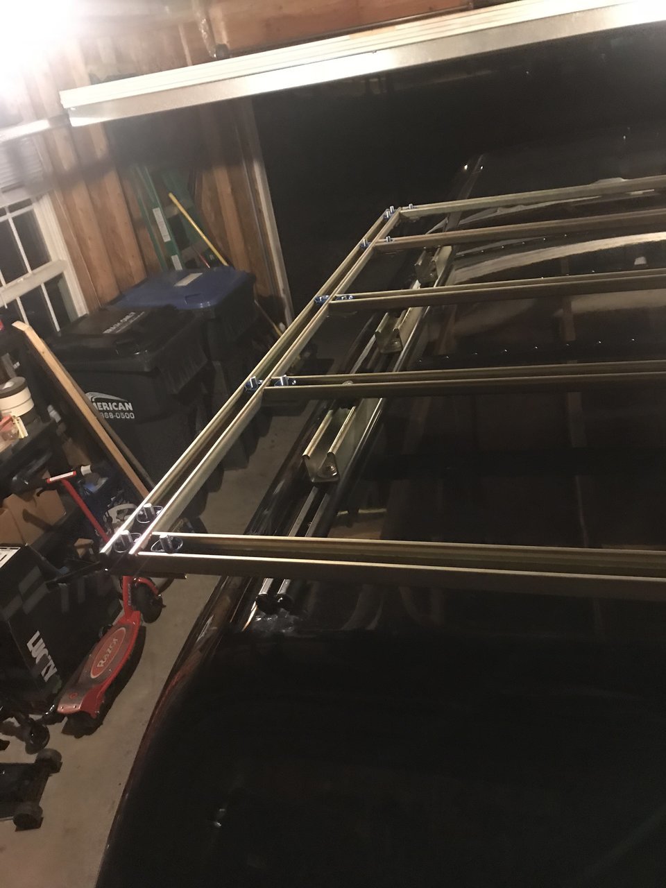

    Im still debating making the cab rack and still sourcing the spacers, bolts, etc but i was just gonna use the thicker strut for feet at the mounting holes and the thinner strut as the actual rack but run short of windshield and fab a fairing or get one from a company and attach it with angled brackets.

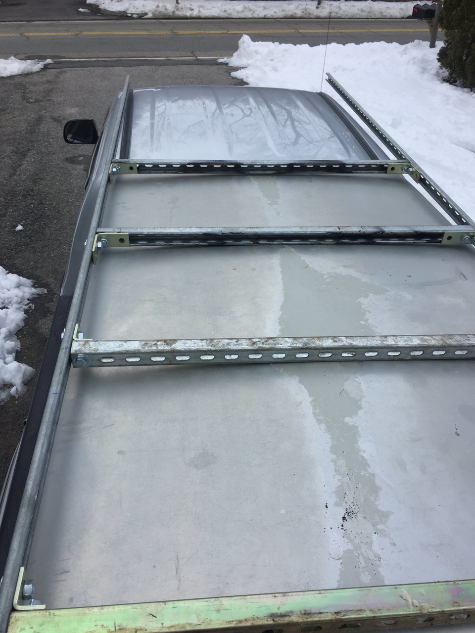

    Thinking about leaving the cantilever over the cab and just attaching some rubber bumps tops incase it flexes a lot. Also not to sure how I'm going to mount it to the camper cap. I picked up some more L brackets I may just put one in each corner of the cap

    How did you attach this to roof? Yeah using the thicker stuff in middle is tough cus it isn’t flat across. I used bigger pieces outside and thinner across.

    It's not mounted yet, waiting for another nice day. I'll be drilling through cap and using some pieces of strut to build it up.
