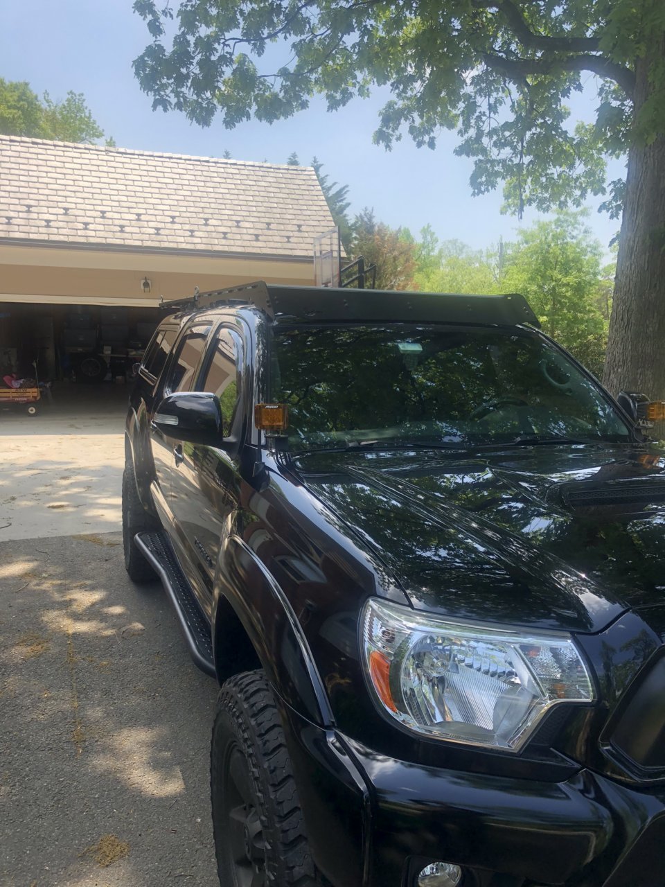

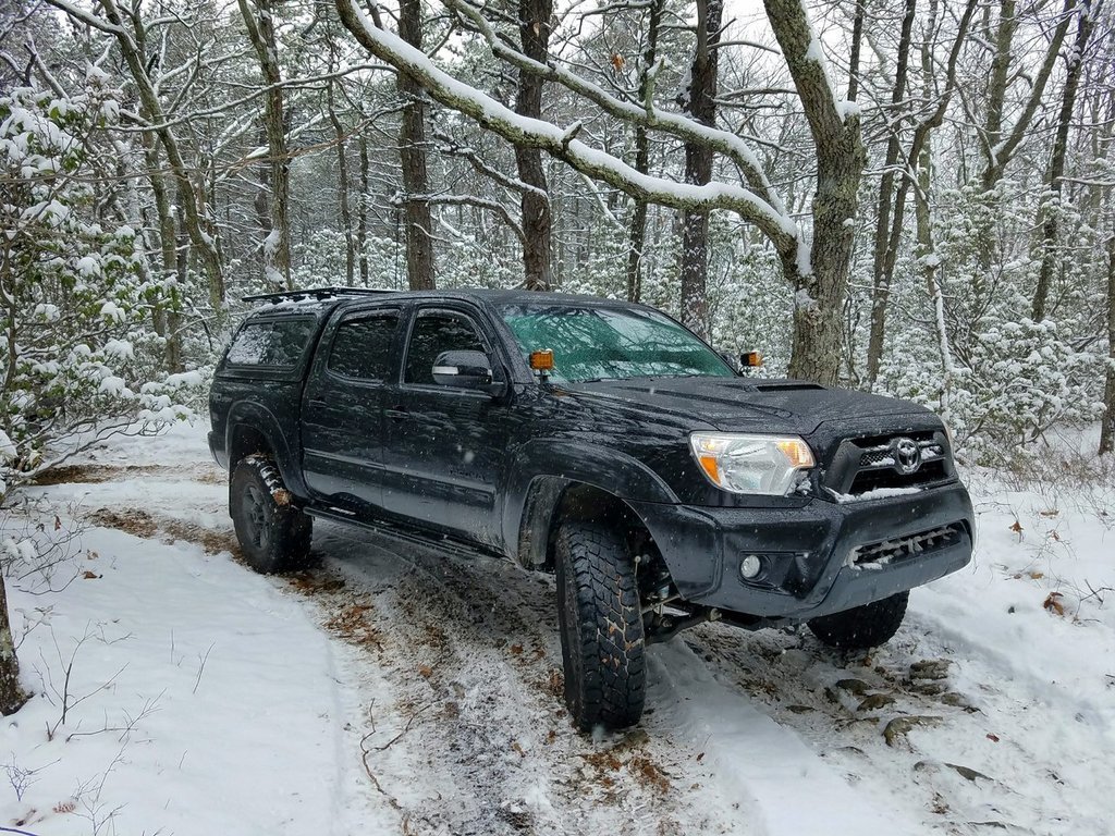

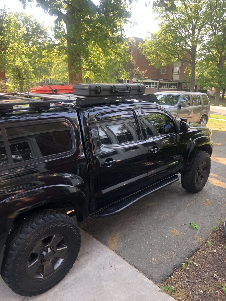

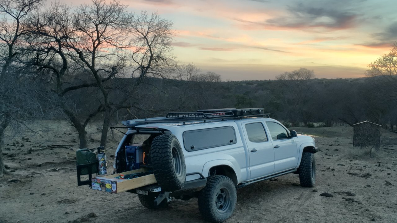

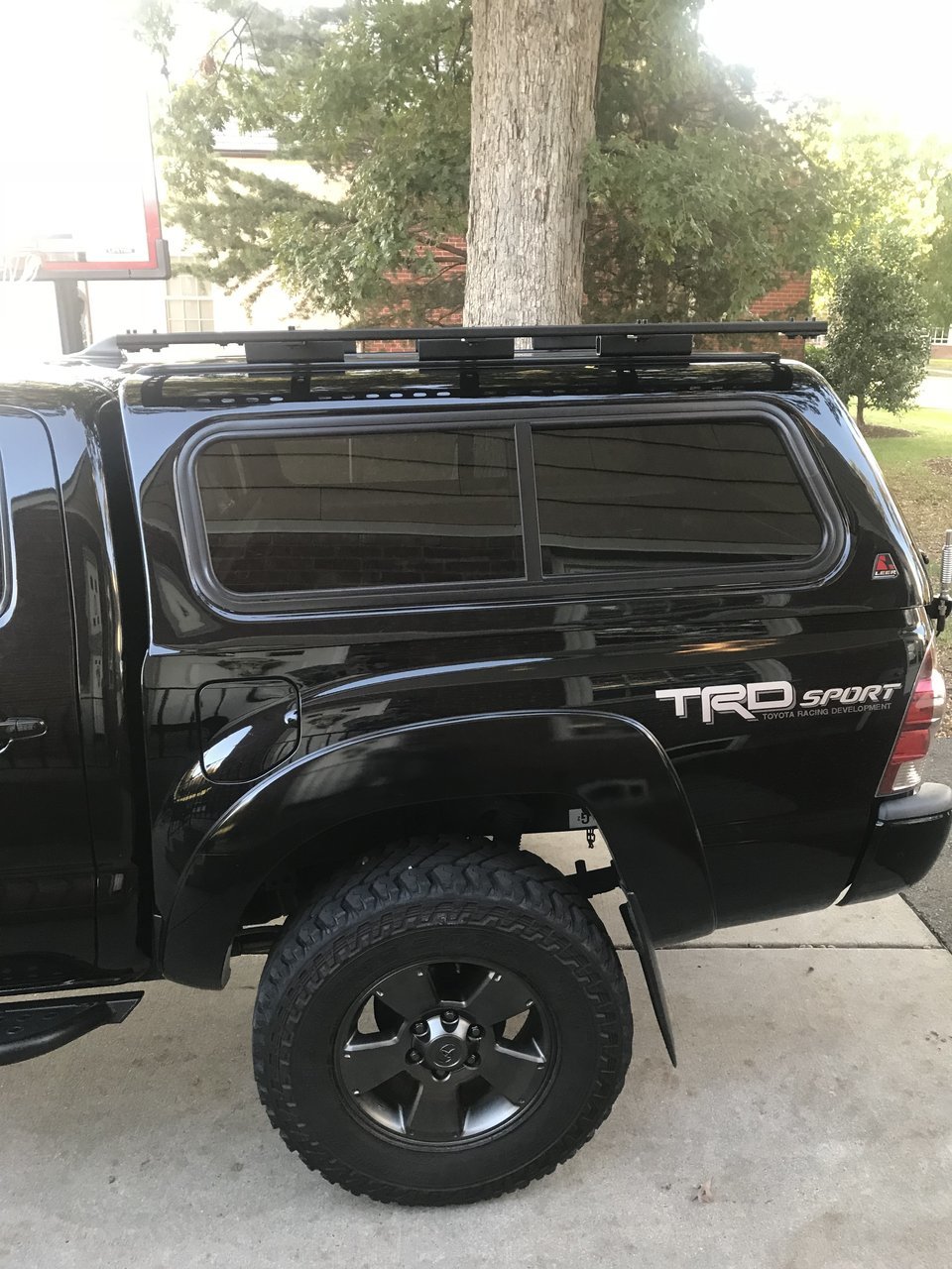

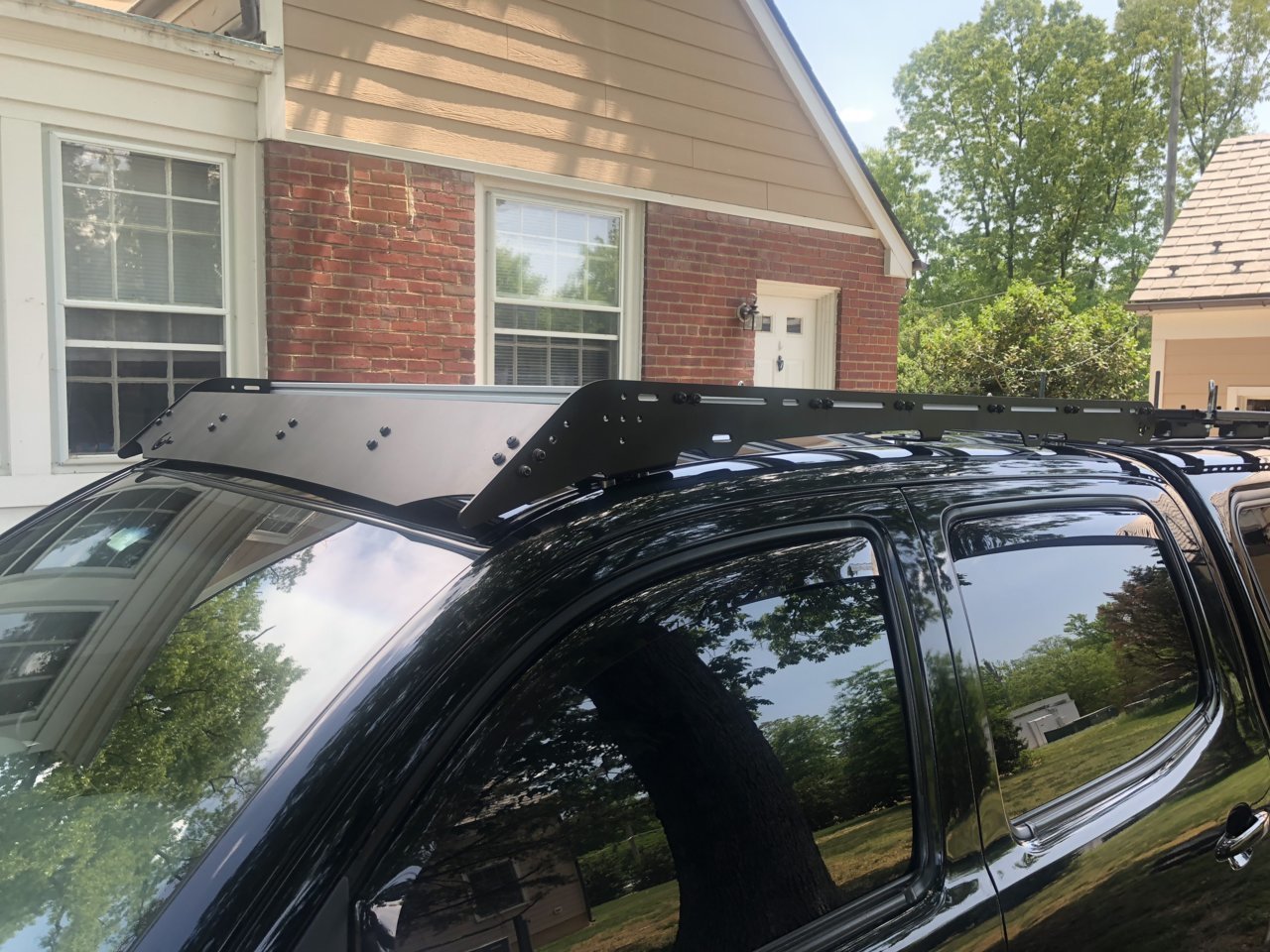

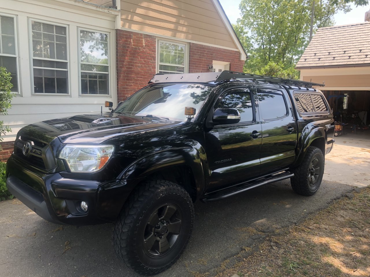

    7C2F8FFC-01C4-4F95-846F-930C4342FACC.jpg F093D946-CAE8-4987-901A-B2FB5929EA35.jpg 3810AABB-719F-4BA7-92E1-02951DA306DE.jpg CE03D4FB-3D00-4199-8B5F-A17D6E165DBB.jpg
    finally broke down after I got a sweet deal on a local prinsu.......need to adjust my rack to match up or build a prinsu style one now that I have the blueprint.......

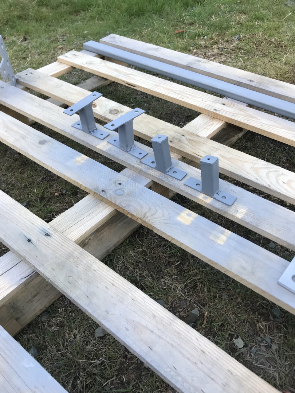

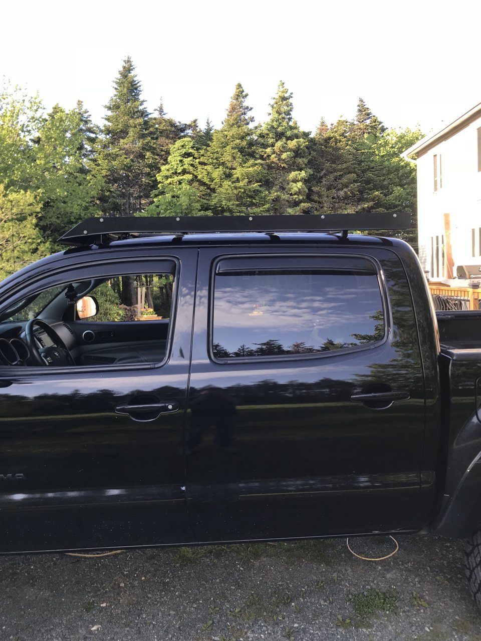

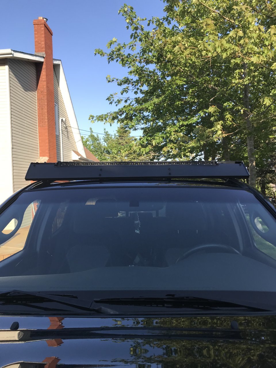

    First of the thread is awesome, got some awesome ideas. I figured I’d give it a go. I wanted to utilize the threaded inserts in my cab so I made up a set of feet for the rack to set on. I have a bit of work to do yet as I plans to make a rack for the cab and cap of my truck. My cap does not have any rails, so I planned on using unistrut as spacers. Unless some has a better way to do so?

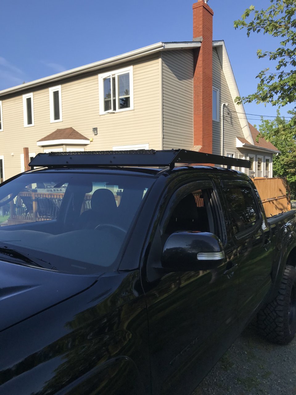

    Thank you to everyone on this thread! It was a huge help and really inspired me to make my own. I just completed my cab rack and will soon be starting one for my cap. 80161862-9535-4AC6-8DDD-BC9432A001B4.jpg15232B8D-624D-4CAE-B5E3-91A6B7DB98CC.jpg1A114C95-8FF4-4260-B573-9CF43FB51DA6.jpg
