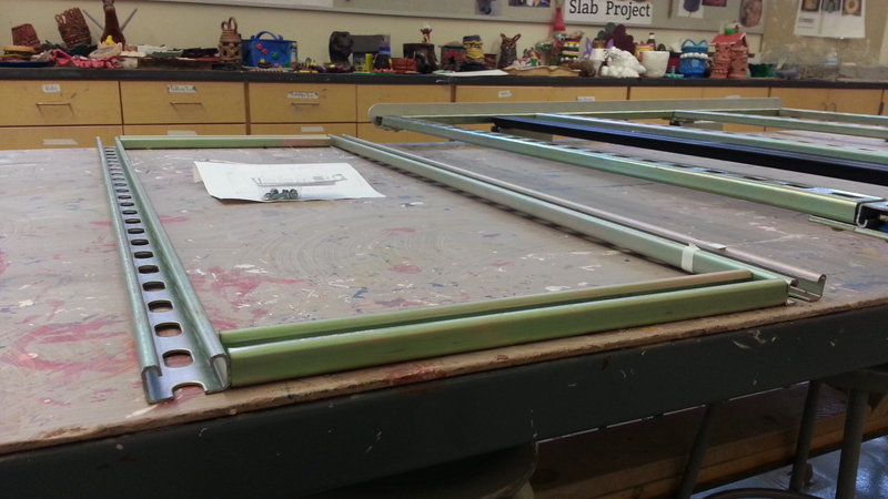

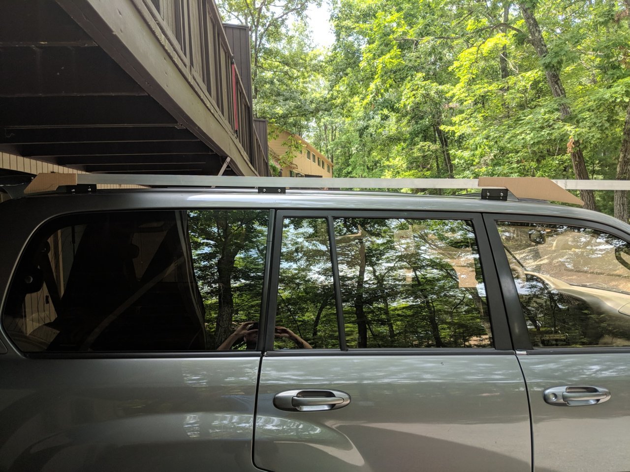

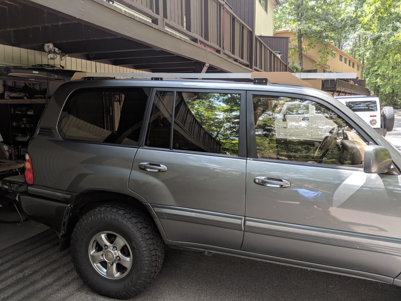

    Started on the roof rack mock up for my 100. Just playing around with some cardboard and some shapes to close off the front and back rather than just cutting it at 90* or 45* once I have a design I'll transfer it onto some aluminum sheet material for the side panels. My cross members will actually be the ones from my taco.

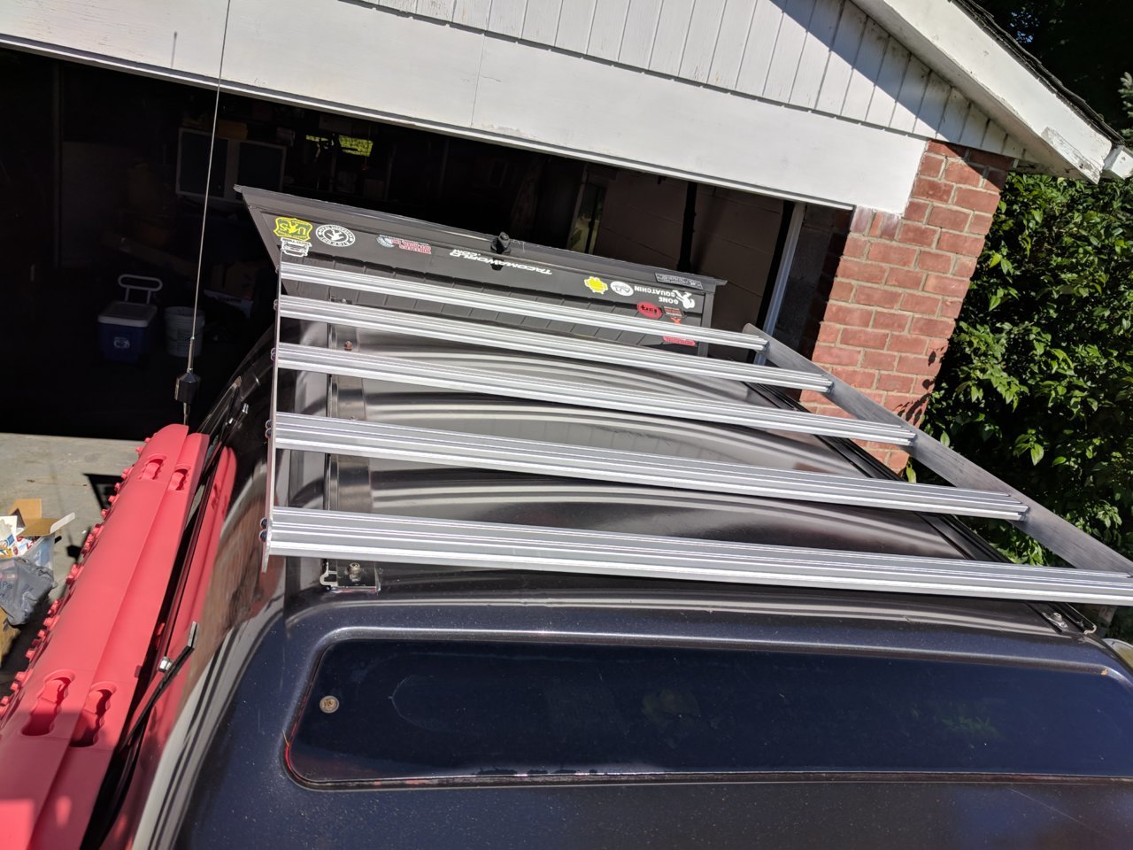

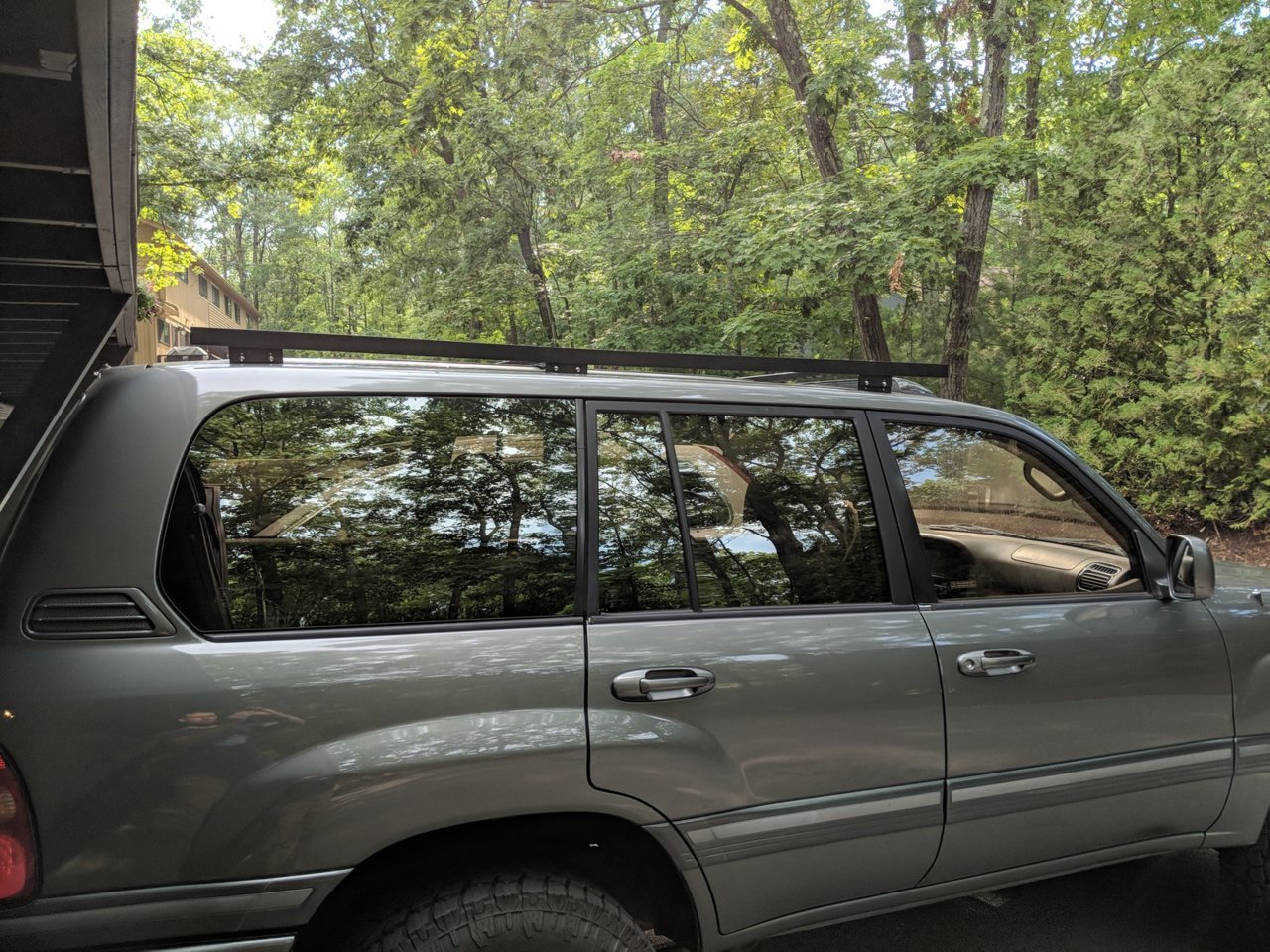

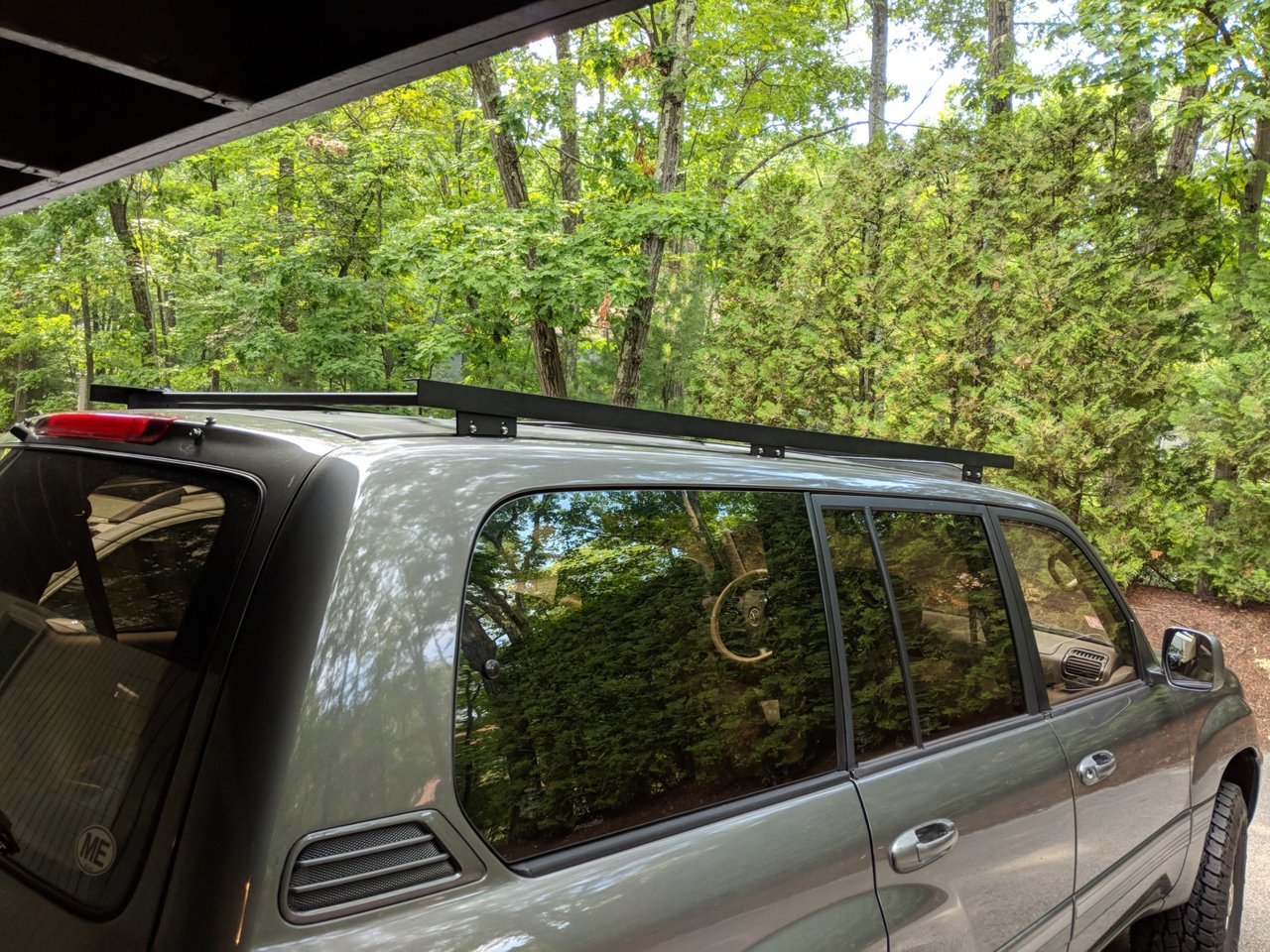

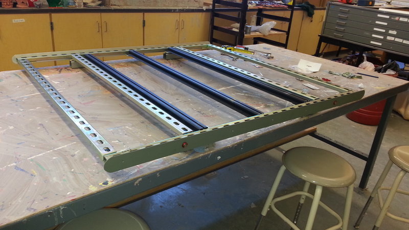

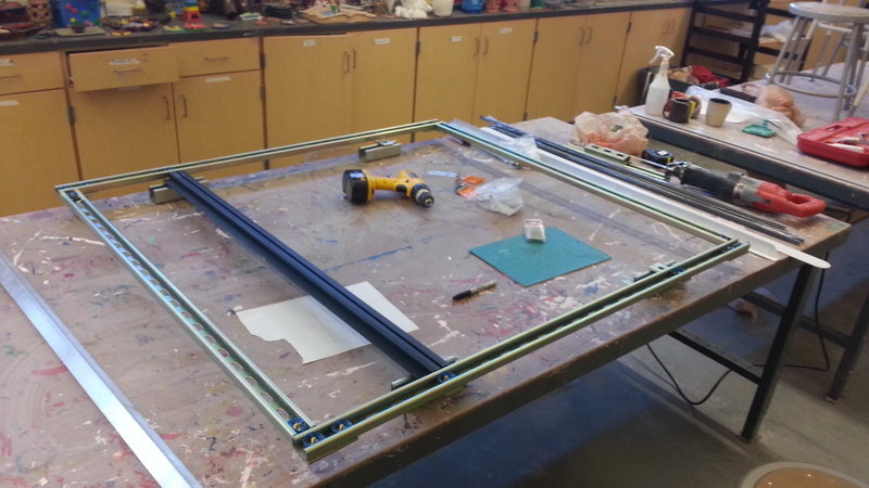

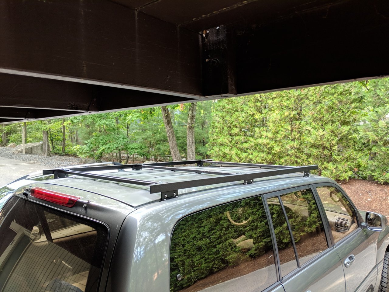

    Another update on the cruiser rack!
    Realized I need to raise it up from the setting I'm currently at, I thought there would be more room in the middle but it's just barley hovering above the rubber strips in the roof.
    I still have the middle cross members to add and the front fairing.
    So far all in, I'm at $220 and most of that is from the trail taylor brackets. L channel aluminum and unistrut I'm only at 70.

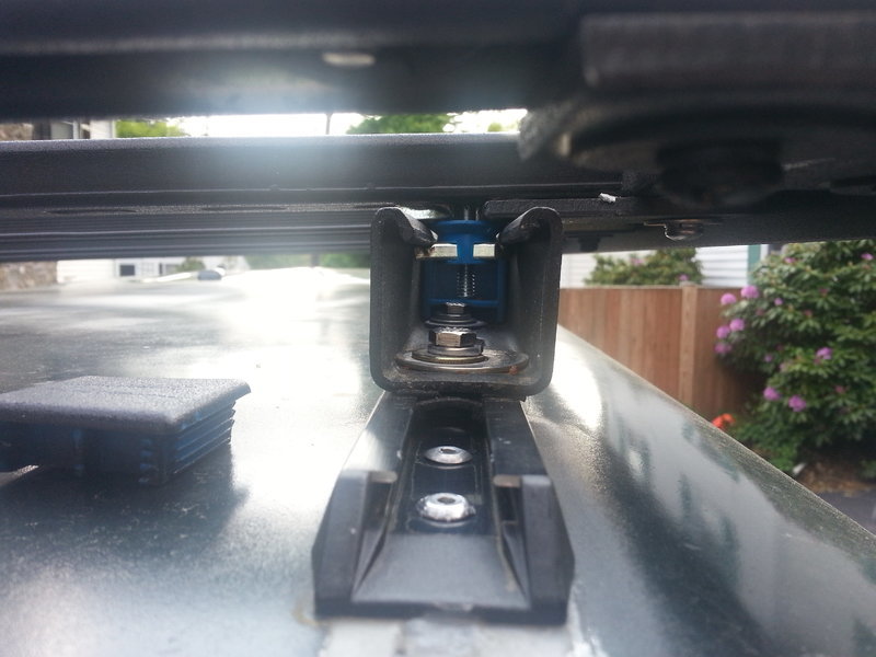

    I ended up making my own posts out of copper pipe and running a long bolt through it to the rivenut. Only thing I didn't like about that was the angle it put the bolt on because of the shape of the roof. The best solution would be to use a bracket of some kind but it would have to be one made by an existing company or custom made.
    I bought some heavy duty brackets from a place called Trail Tailor for my Land cruiser 100. I'm currently running my homemade rack off of that. I would bet that these would work on the Tacoma as well.

    This looks great, thanks! Do they hold a decent load? I thought about the pipe too, but ifI imagine that you have to have your cuts near perfect to avoid and rattling.

    I would say yes definitely, he uses these brackets for his own custom made roof racks too.
