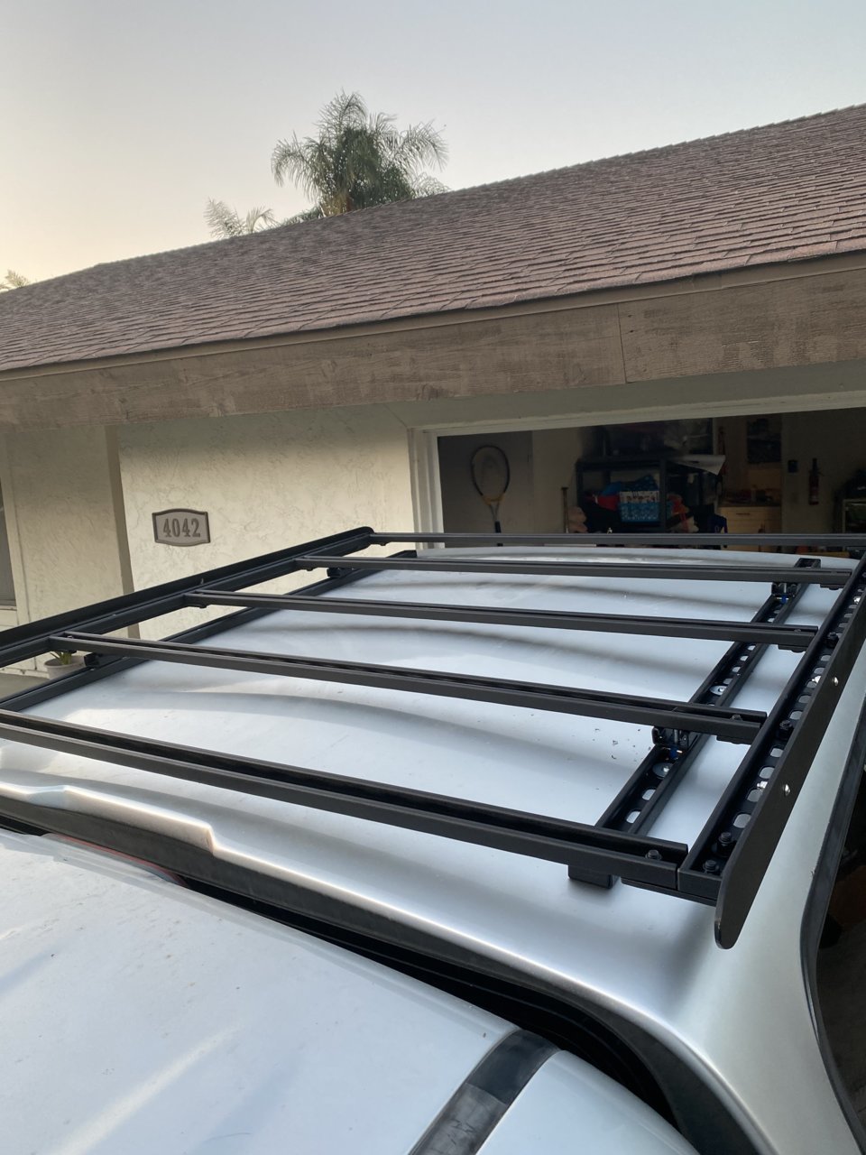

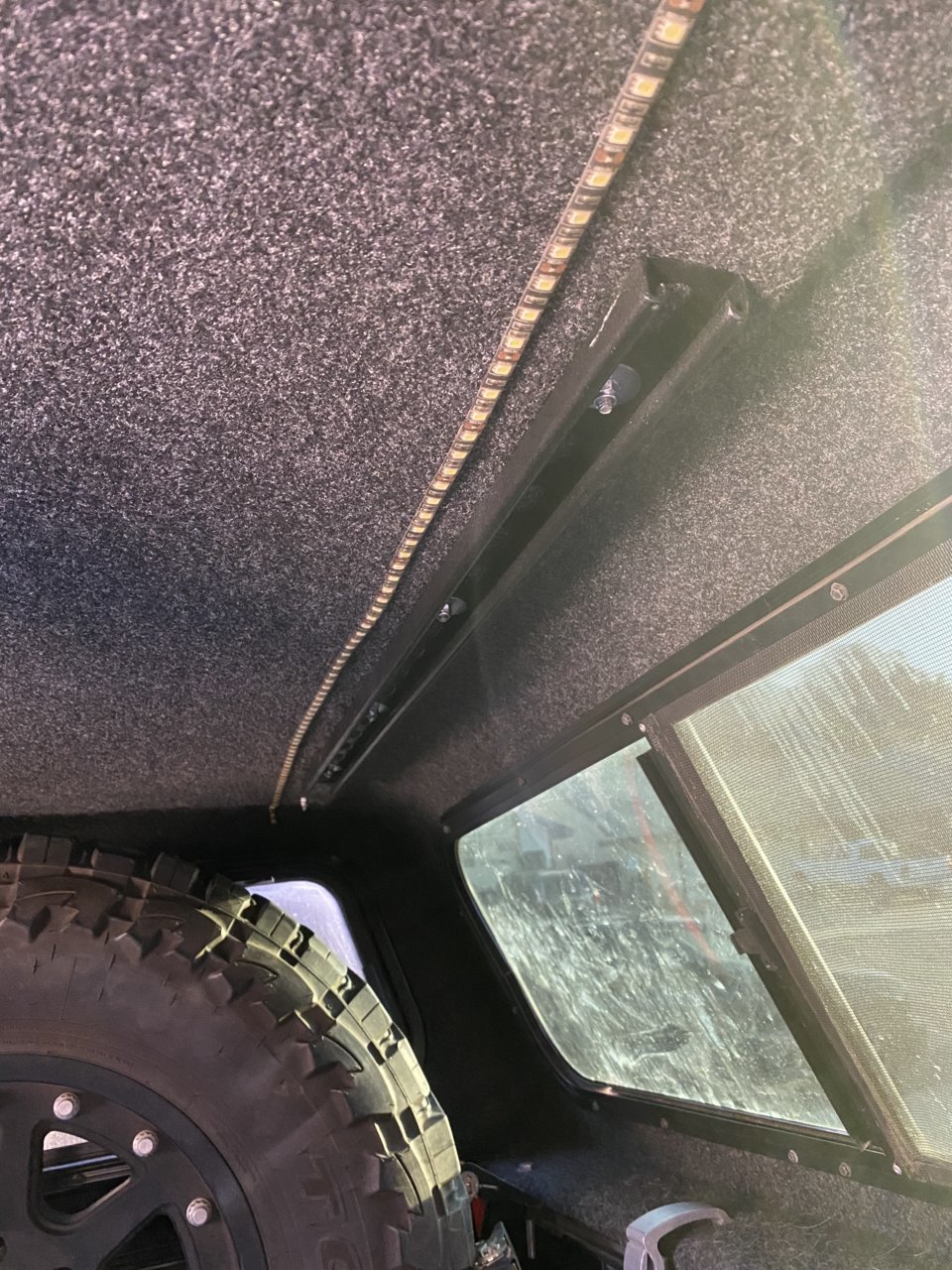

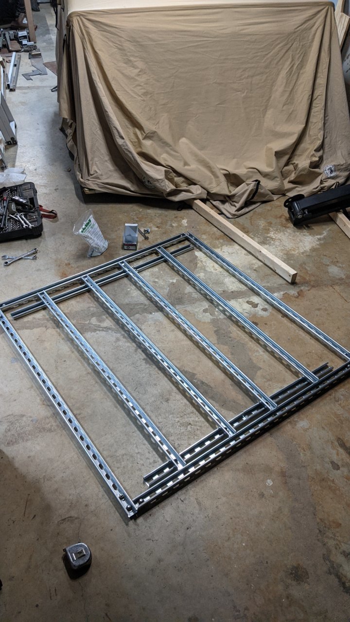

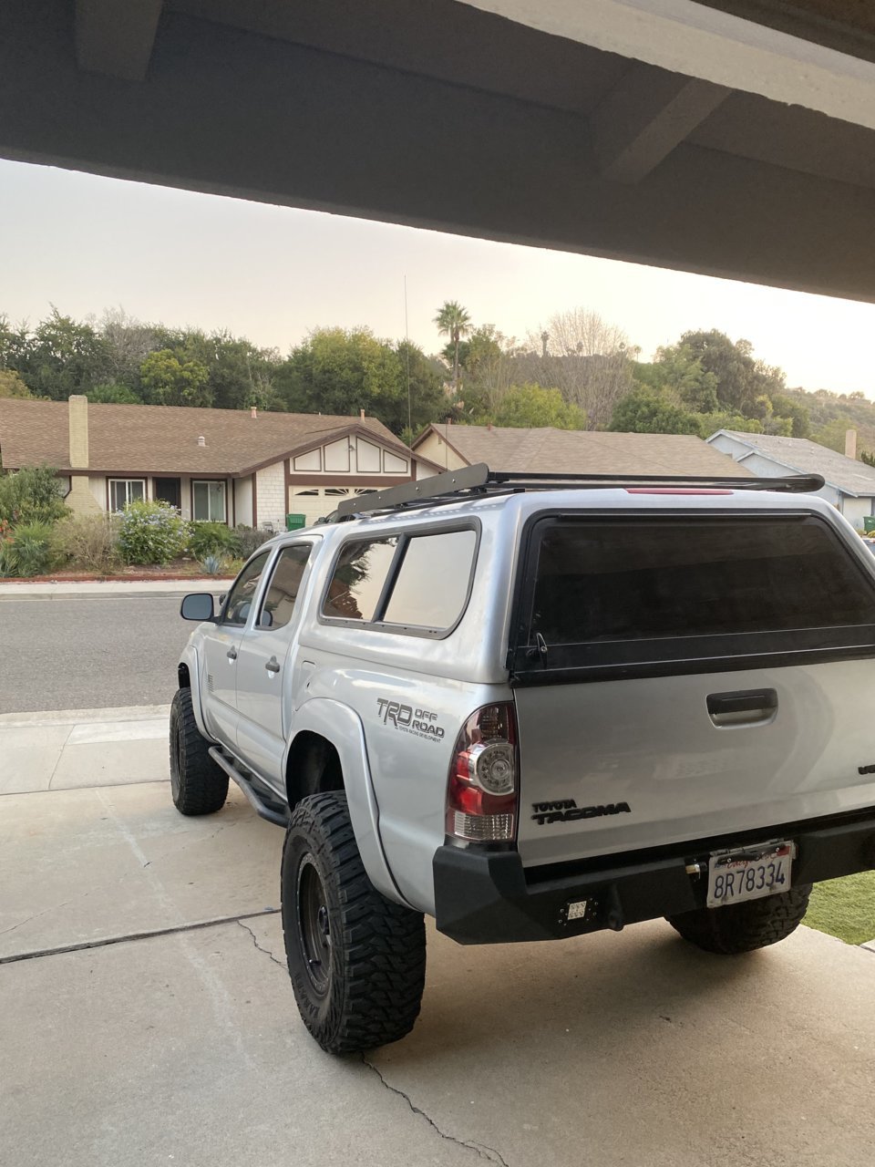

    Just got all the material. My shell had NO tracks so I was planning on using unistrut to make tracks
    is 4 1/4” bolts per track enough to attach the tracks to the shell?
    On my shell I pretty much have to go through the honeycomb reinforced section.

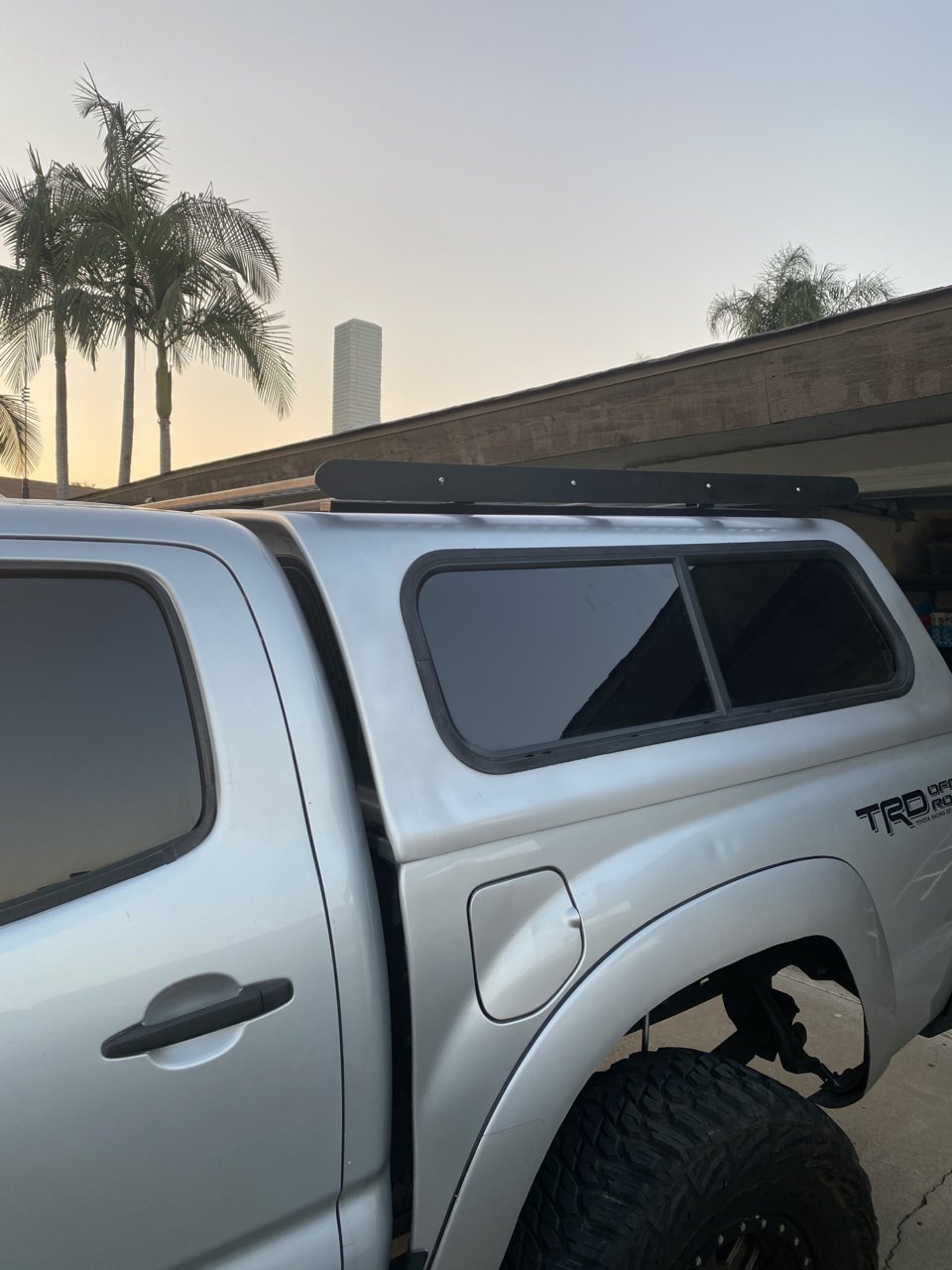

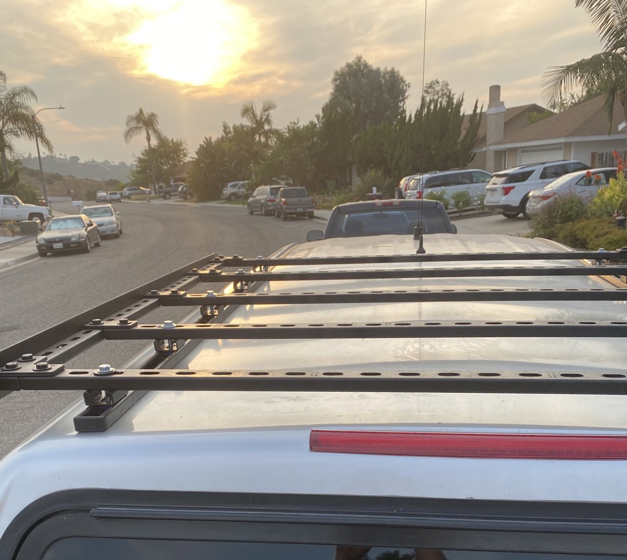

    Done
    seems pretty sturdy, but the middle bars that don’t have a support on them definitely flex. Couldn’t imagine standing on it.
    anyone else’s do this?

    I've had hundreds of pounds of Lumber on mine on many, many occasions which is I what I originally built mine for. I don't think you would have much of an issue with an RTT. One thing I might suggest if you do the RTT is to try to tie in your inner roof support to your bedside rail. The weight of the RTT is distributed pretty well across the bars, but when you stand on them which I've done, they do bend but your stepping on a singular point with your full body weight.

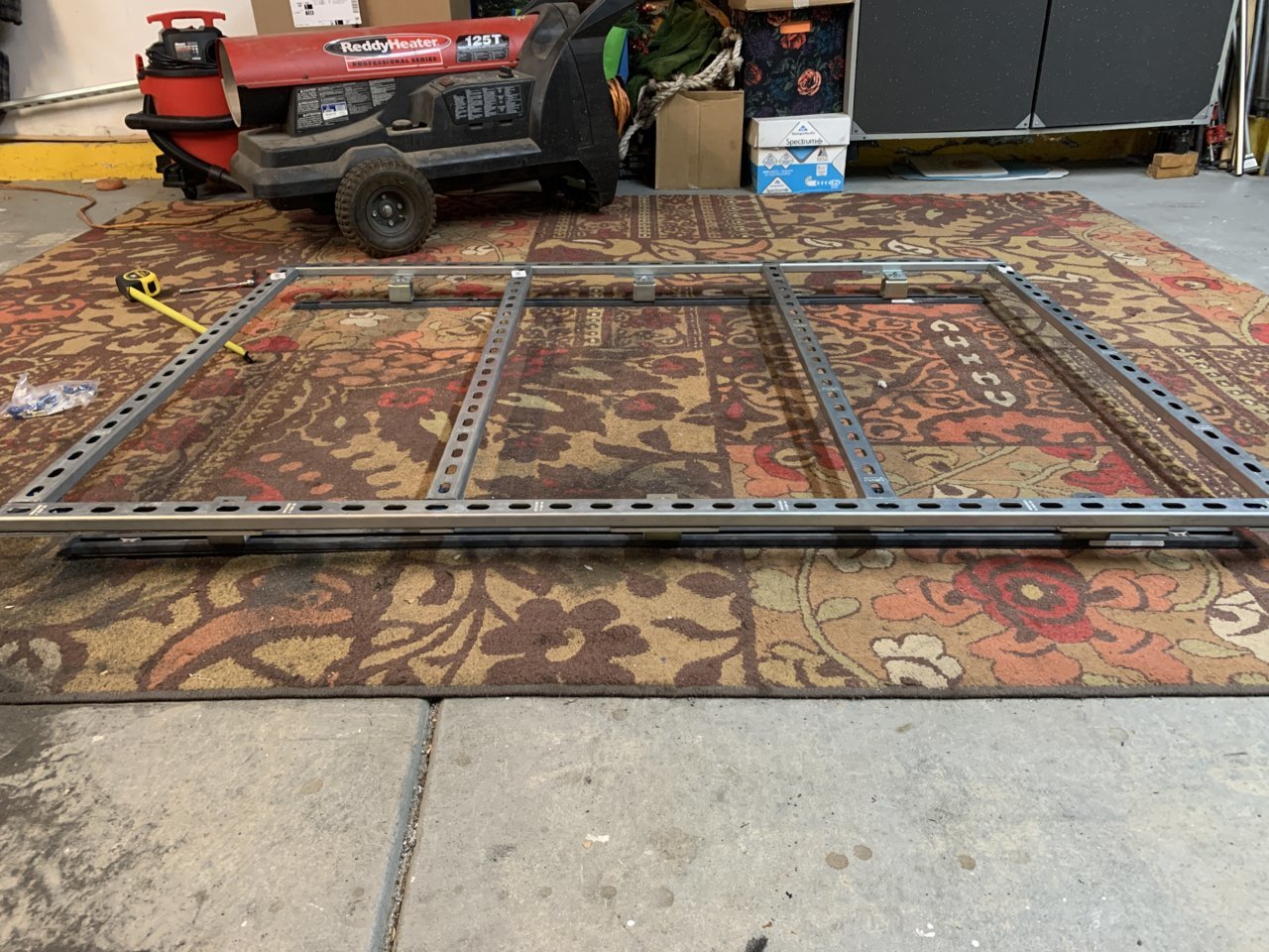

    I re did it with longer tracks and supports on every bar. Super solid how. Had some trouble getting the track holes sealed but should be okay now

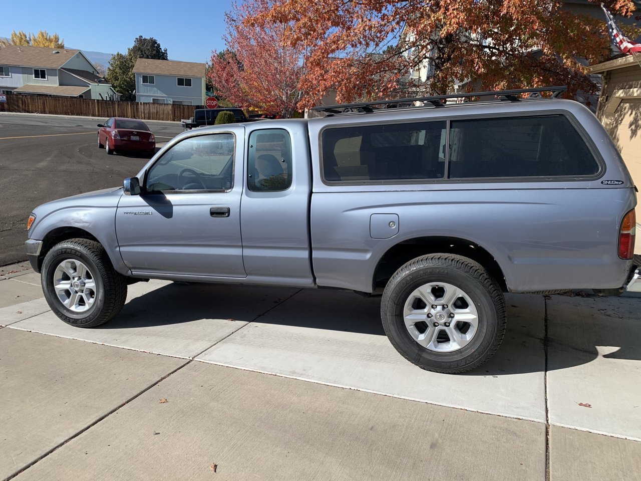

    Long process and I’m not sure I’m done. Hauls a lot of camping gear so far like this and held up great!25A8AFCC-145D-45E9-9D9D-D4B494210FF1.jpg46DB97C2-00CF-4CEA-BCAE-D497B9A5387A.jpg

    @anthony250f the rack looks great! I'm on a budget and am planning to make a rack w the unistrut. Did you drill through the sides of the unistrut to mount the side panels? And did you get the side panels shaped like that or have to cut yourself?
  11. Nov 21, 2020 at 7:42 AM
    #751
    anthony250f
    anthony250f Well-Known Member
    Feb 18, 2012
    #73066
    16,544
    Anthony
    San Diego, CA
    2008 dcsb trd offroad 4wd
    I did drill through the sides. I used short bolts instead of long, so the nut is inside the unistrut. I got a 12’ stick of aluminum and cut it in half and then shaped the Ed’s with a grinder. Very easy to do.

    I like your rack setup. I don't know if I missed it, but where did you get the tacks for the mounting rails to your shell?

    The tracks are actually just unistrut

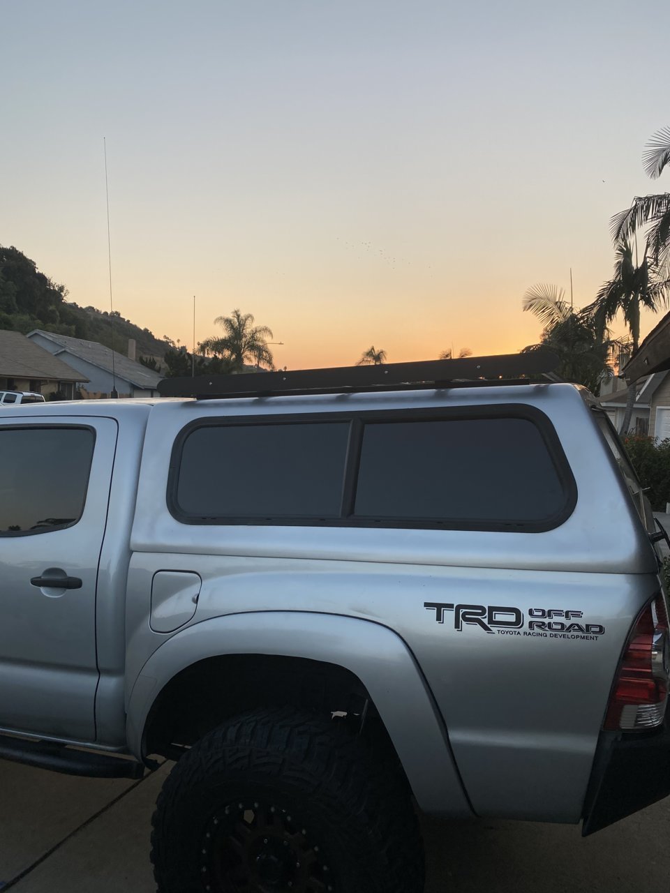

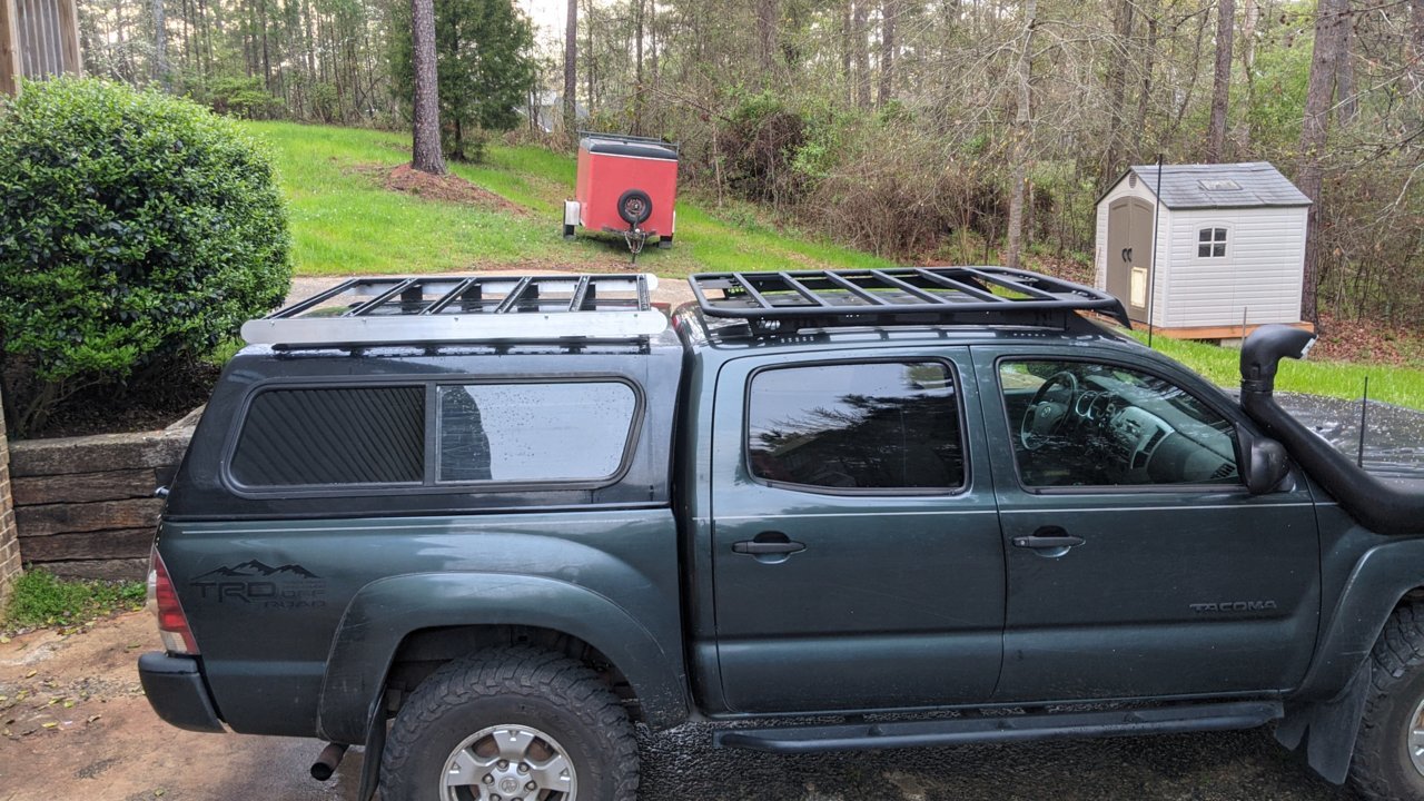

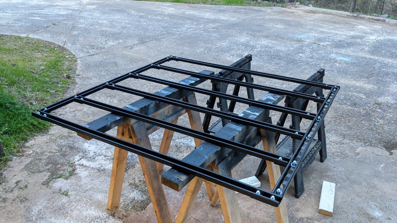

    Have been working on this the last few weeks. Still need to paint the aluminum sides but it started to rain last night.
