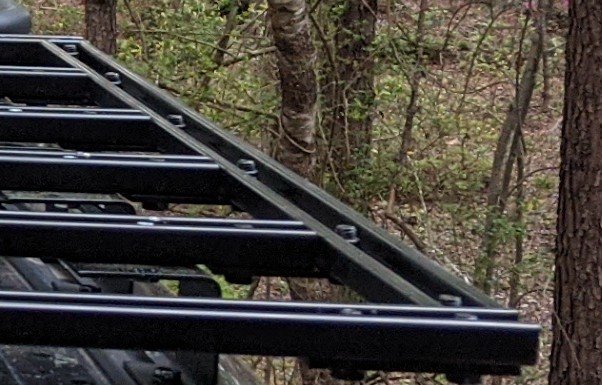

    Is there a reason everyone has bolts perturbing on the top of the rack? Wondering if there’s a way to conceal the bolts in the channels so the top of the rack is flush. I will be using this for lumber and surfboards and hoping to not have bolts that will scratch either when sliding them on.
    Really appreciate the post. Can’t wait to get started!

    All my bolts are in the channel and the top is flush. I didn't want the bolts or boltheads
    sticking up either. In the picture they look like they stick up but they are below the lip.

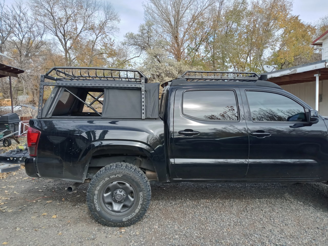

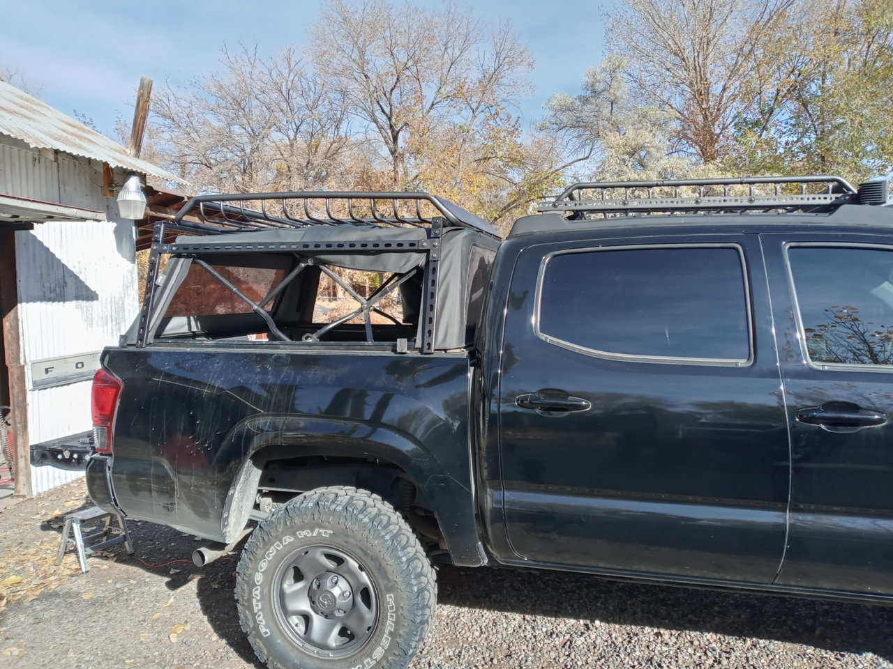

    This thread was inspiration for this little project,
    Still a work in progress but mostly just detail stuff that is more OCD than anything else. Kicking around a few ideas for added functionality but mostly just havin' some fun.
