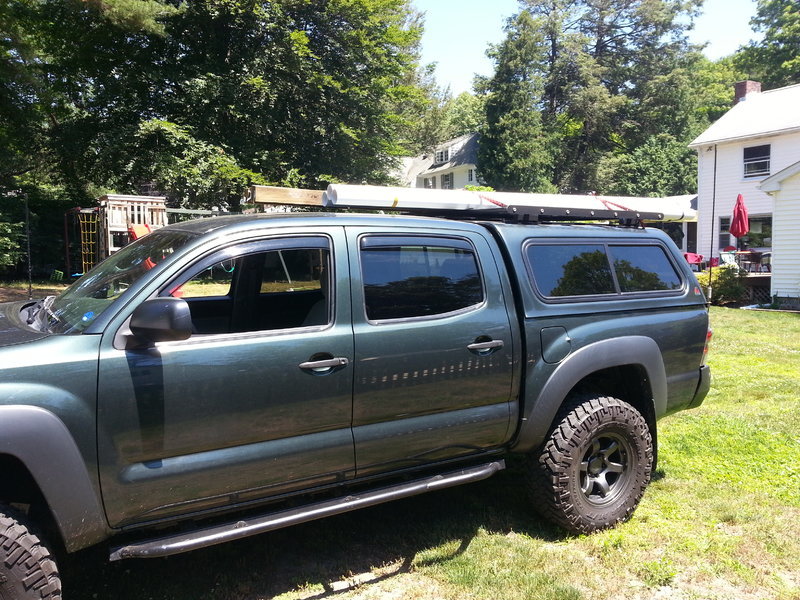

    In that first image, it looks wider than your cab rack. Yes?

    Yep, the cab rack is a prinsu. It's 3/4" difference on each side to be exact. That little bit of space helps a ton when two kayaks are side by side. The widest part of our kayaks are right in that area at the start of the bedrock.

    Thanks man. I was a little skeptical with the cab rack being a prinsu that they may look odd together. But I think they actually look pretty good together.

    They really do. Great job!

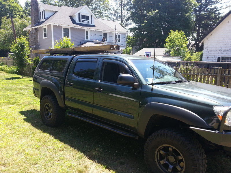

    Got some use out of the rack today Makes me feel that the need for the cab rack is that much more important to get done. Build will commence soon.:D

    Same here, when I was hauling a bunch lumber it was great to have the holes for my ratchet straps. Worked like a charm! :thumbsup:

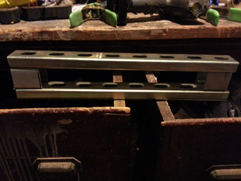

    Scott you think this unitstrut stuff could be used to make a cargo basket?

    I do, but it would be pretty beefy. If you used the 1.5in unistrut you could stack them on top of each other. I've also see some online that can be ordered that don't have the holes either. Those might be nice for the top rail.

    @DCSBFTMFW Sort of like this with the bottom 3/4in strut being the base and the other the top rail of the basket.
