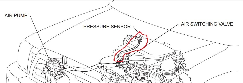

    Is the vacuum line from the valve to the pressure sensor connected?
