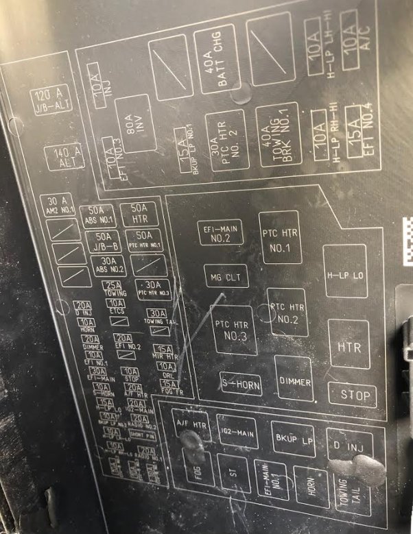

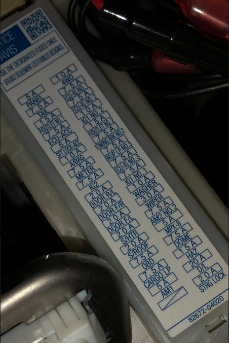

    Last night I drove down the highway and realized the right turn signal suddenly not working. Thought it may be a bad connection of the bulb but it wasn't. I swapped left bulb to the right and it still not works. So I stopped the vehicle and restart the engine, put the hazard lights on but then all the sudden the lights work again. Drove the truck another mile and put up the turn signal to exit the freeway, then realized the signal light is not working again. Parked at the garage and play with the emergency light again and it works again. Also, notice that the tail light is on and have no issue, so it is not the bad bulb (I believe)
    Is that a bad fuse or relay issue due to cold weather? wonder if it is a CANBUS error or anyone has any clues.
    PS. I check the fuse box and don't see any fuels indicated to Turn signal. See photos.
