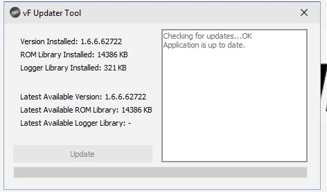

    I am starting to run out of ideas and figured someone on the forum might be able to help:
    2017 Tacoma TRD OR with 04B04 ECM, Magnuson Supercharger and 5.29 gears.
    Initially I was able to flash the Magnuson tune, with much frustration and trying many times to get it on. Not sure of exact why/how it was eventually it was able to flash but I got it to work. I then purchased the Yotawerx tune. Got it flashed but had to use the ECU recovery steps, and I don't think it flashed properly due to some "quirks". I reached out to Yotawerx, great support BTW, and we did find a couple issues with the tune which they fixed and sent me a new tune file. But for the life of me no matter what I do I get this error message:
    Tractrix cable is connected and the truck is in the "ON" position but not running.
    Here are the things I have tried so far, none of which worked:
    - Different USB cable and port.
    - Different laptop (clean reinstall of VF Tuner)
    - Different Tractrix device (Got OVTune to register my old Tractrix, not the one from Magnuson)
    - Reinstall of OpenPort Drivers
    - Replaced the ODBII female port (Spliced new port into existing harness, confirmed it works with another ODBII reader I have)
    - Removed glove box to confirm no issues with ECM and a loose connection (no problems found)
    - Checked every fuse under dash and in engine bay that has to do with ECM or ODBII. (all fuses were fine)
    Truck starts and runs just fine. Despite all I have done I still get the same error. But now I am out of ideas. The only thing I haven't replaced is the wire harness and the ECM. I don't think it is the wire harness since my other ODBII reader (Torque Pro) works without issue.
    Anyone have any suggestions of what else to check?
    Any help would be appreciated.

    You're vF Software is fully updated, right?

    Yes vF Software is fully up to date and licensed.
