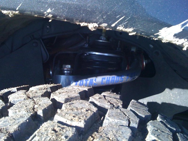

    No, but the frame it's mounted to will in a body-on-frame pickup.

    Ya that's normal. I didn't think it would flex that much, but apparently it does.

    A few bolts are different.
    It is a tight rope walk with the clearances on this truck for sure and the rope is only the width of a human hair.

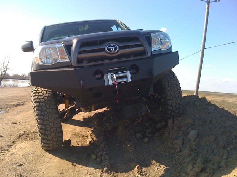

    Fo' realz.
    I'm pretty sure once you get to 33" or larger, the only way to eliminate rubbing 100% is to limit travel or cut metal.
    That said, as long as I'm only rubbing on smooth surfaces, I don't much mind.

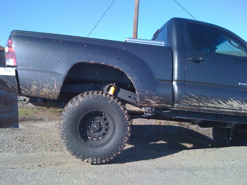

    Here are some other random pics from today

    Did you do a chalk test on your tires to find the optimal pressure? Looks like you are a bit over inflated.

    No, I havent yet. I noticed my tires flexing/compressing quite a bit while offroding yesterday so that's a good sign they are not over inflated though.

    Try those KM2's at about 18psi in the rocks. You will shit your pants at the traction they get. If I didnt have to drive on packed snow I would have a set.

    Ya I could imagine how well they would wrap around rocks. They were already doing that more than normal at double that.
