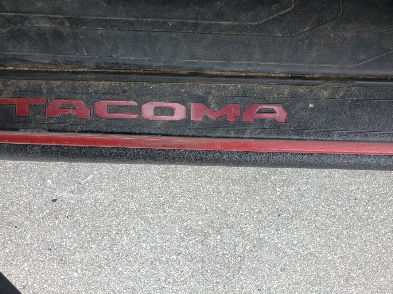

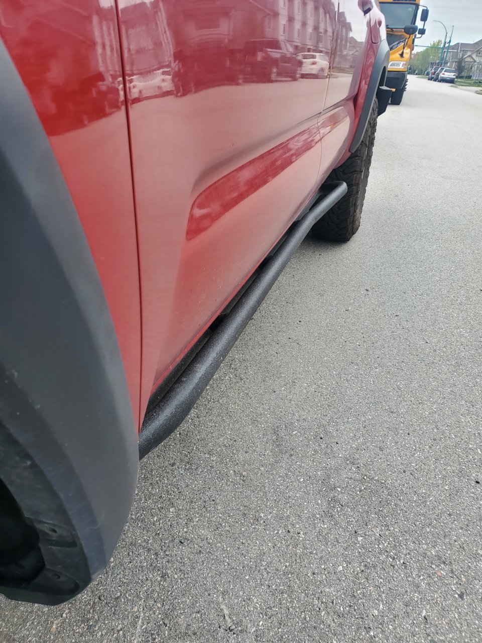

    Agree that sliders make horrible steps. I also had mine spray painted initially but the rust and durability wasn't there. Ended up getting a really good primer and raptor liner. They've been holding up great now this past year.
    Not very useful as a step

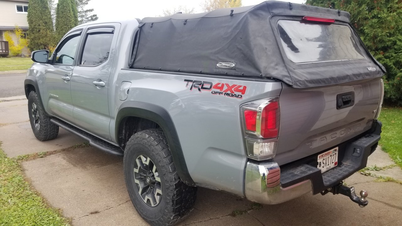

    Flat sliders are definitely better than angled sliders as steps, but I would still never advertise them as being good steps. Flat sliders are still only 3-4" below the cab floor, so unless you need to use them as steps, the extra width to step in/out over them is a pain. Obviously YMMV, but my opinion is the more useful they are as sliders (high and tight), the worse they are as steps, and the more useful they are as steps (low and wide), the worse they are as sliders.
    Sliders are also significantly heavier and more expensive than conventional steps, so unless you need sliders for the type of wheeling you do, 99% of people would be better off with actual steps.
    Here are my sliders, which aren't nearly as high/tucked as @tyepel (no idea on the angle, they were custom made by a friend). I step over them rather than on them 100% of the time. Just my experience.

    I'm definitely not suggesting that someone go out and buy sliders when they don't get off the pavement and actually want steps. If you're in that situation, definitely just buy actual steps. But if you do wheel, I think you're getting >90% of the benefit of sliders by having flat sliders and if you're also looking for something that has some functionality as a step, buying flat over angled might get you there.
    I don't find that they protrude from the frame enough to be an issue to "step over" and I find them handy when getting out of the truck since you can pivot on your ass and put your feet on them to step out. But like you said, YMMV.
