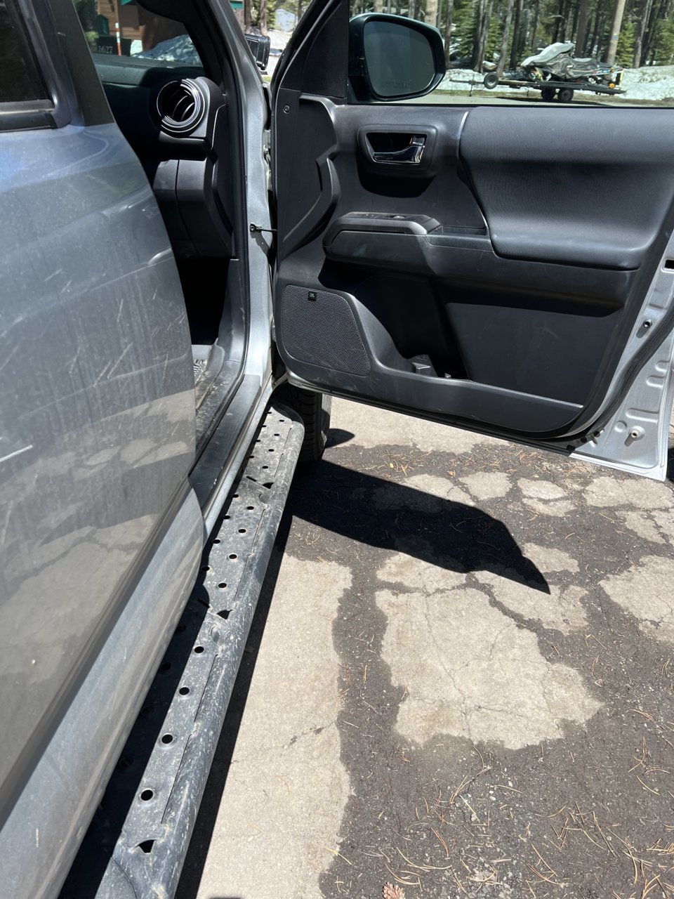

    As an aside, I've never been convinced on the clearance argument for the angled sliders. You're more likely to be dragging your rear pumpkin and the 25 degree still bolts at the same spot, so the bottom still has the same clearance. The clearance you're gaining is only over an area 2-3" out past the frame of the truck and as you get closer to the truck the clearance you gain gets less and less until it's equal at the frame.
    I can't say I've ever been dragging my slider and thought that a 25 degree angle on the far edge would have solved my issue any better than just dragging the slider.

    True, but I need to justify my mistake somehow! Lol honestly if anything the angle makes it feel worse when coming down on something and hearing a crunch or thunk. Was it the sliders or door.
    Which is the opposite of my transmission skid. That thing hangs wayyyy below the transmission with a healthy gap so you definitely know it's just the skid.
