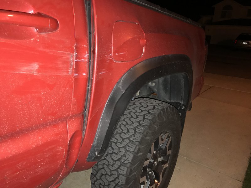

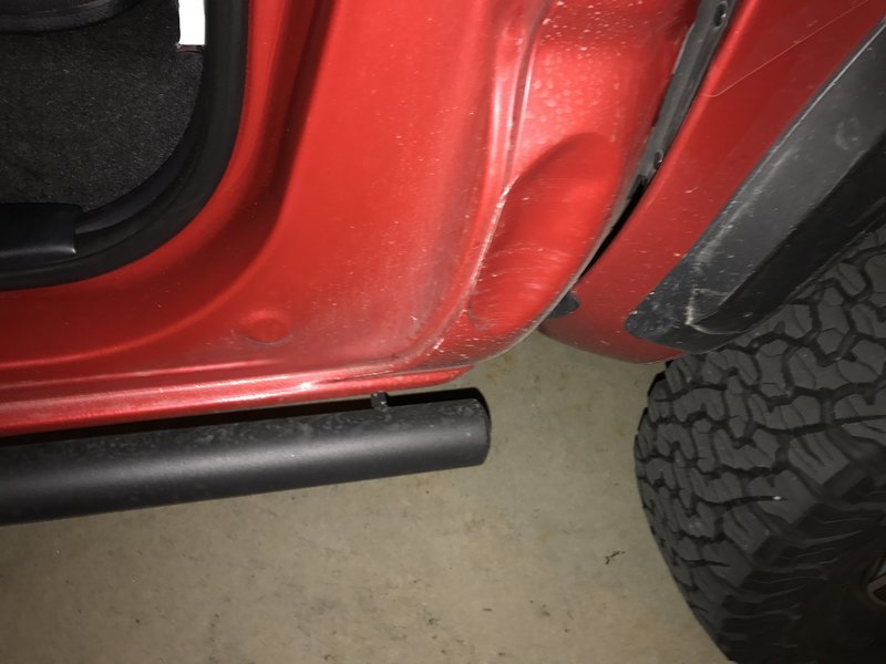

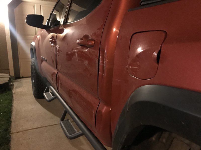

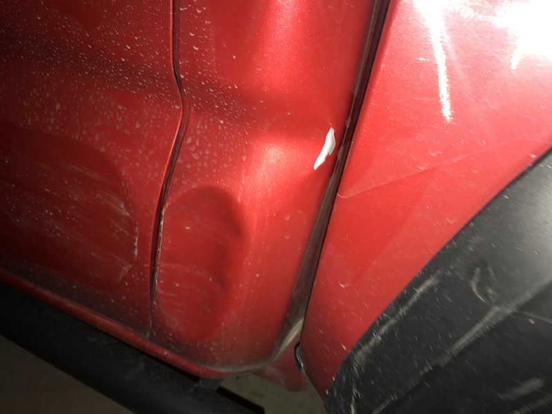

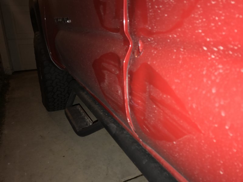

    well.... I did a dumb thing today... I decided to run a pole in a parking lot down the side of my 2016 tacoma TRD OR DCSB 6MT. Has anybody experienced similar damage to a 3rd gen? I'm just trying to get an idea on repair cost and what the insurance may do... Driver's door, rear door, cab, bed, fender flare.IMG_6290.jpgIMG_6288.jpgIMG_6295.jpgIMG_6292.jpgIMG_6293.jpg

    Looks like the bottom leading edge of the bed is pushed inward as well. Good luck with repairs OP

    Definitely a claim looks like 3hrs front door rear door skin weld studs and pull time on cab corner and 6 hrs repair there little time on bed side and replace rt fender flare then blend front fender r&i door handles belt strips and int door panels At least 3k in damage and whole side of truck will get refinished/blended.
