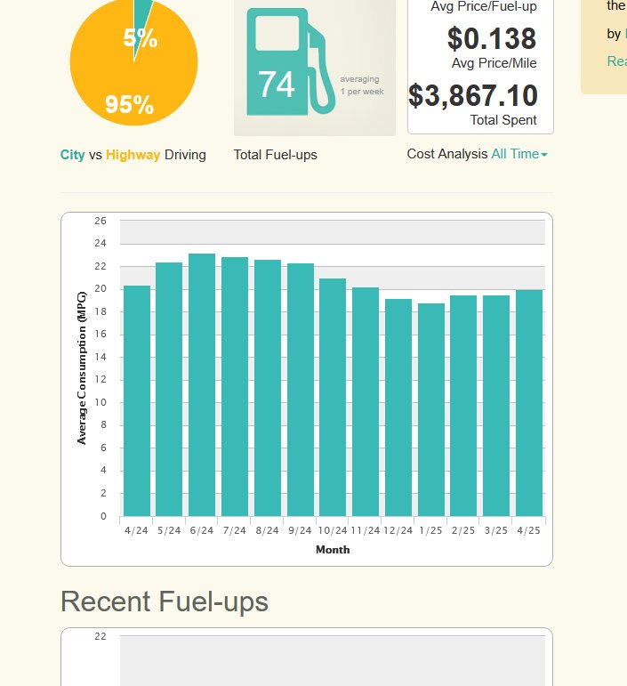

    Check my fuelly...
    I run the stock firestones at 36psi.
    I will tell you the oddity of the v6 on the 3rd gen... 80mph or 70mph 21mpg..... 75mph 20mpg...I think it hunts gears more at 75...
    Summer gas is 2mpg better than winter gas in the northeast.
    I'm at 22+mpg right now. I use "dumb" cruise control to prevent the slamming brakes...
    When you are at ZERO miles left you have 10% of your gas tank left which is 2 gallons basically. So you have 36-42 miles depending on your active MPG and driving style.

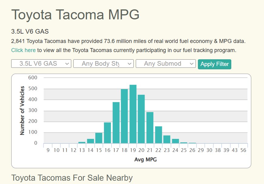

    I'm pretty much stock with tonneau cover. At 18.8 MPG over the entire life of the truck (70k miles), I"m right in the middle of the chart average.
    I think the data speaks for itself - 19 MPG combined is just about what to expect.

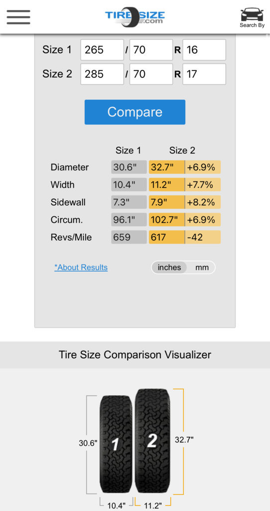

    My gas mileage decreased about 15% after I got larger all terain tires.

    1,244
    Billy
    2020 TRD
    Keep in mind that with a larger tire size the mpg estimate and odometer will read incorrectly in proportion with the percentage difference in size.
