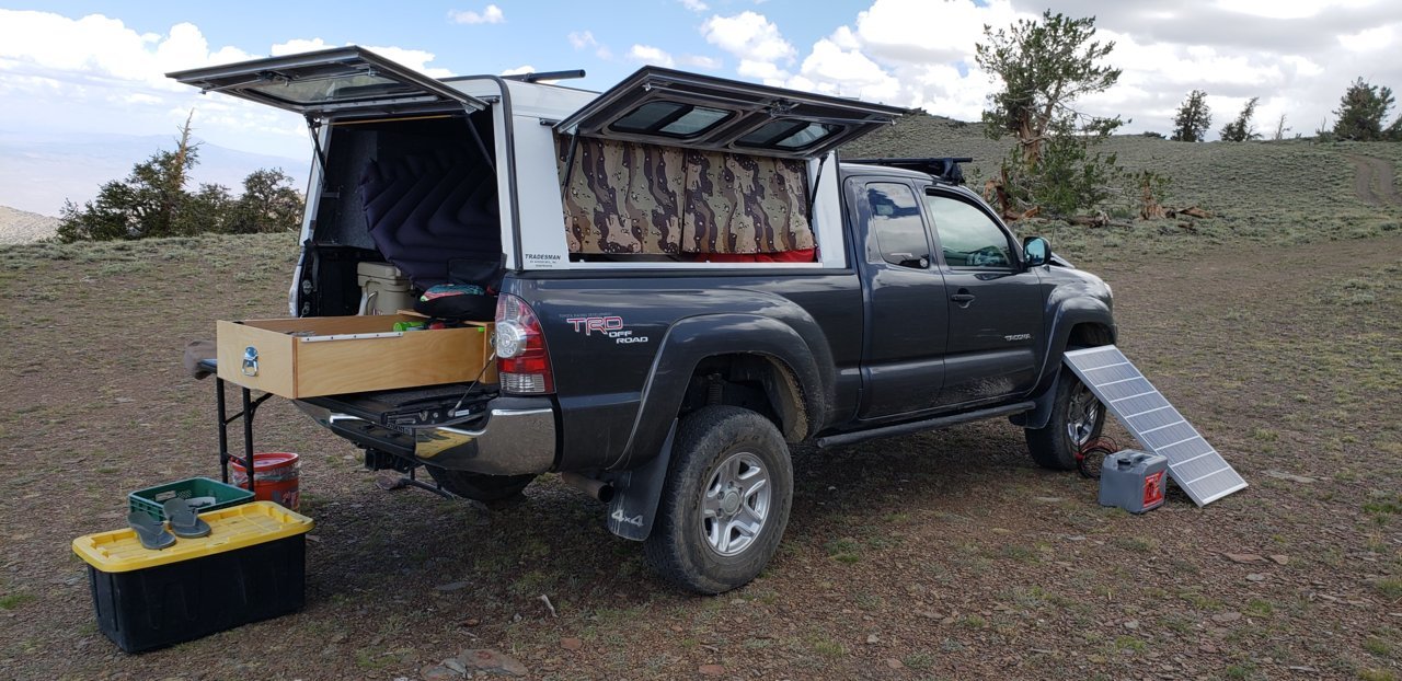

    A quick report on my new set up. My built drawer/sleeping platform works. I used skateboard rails for drawer slide and there are some hiccups in use. For the most part they work and are cheaper than any slide system I found so far. The shell, while far different than the FWC, works. Not sure how to fine tune it for two people. I just need a few trips to get it dialed in.

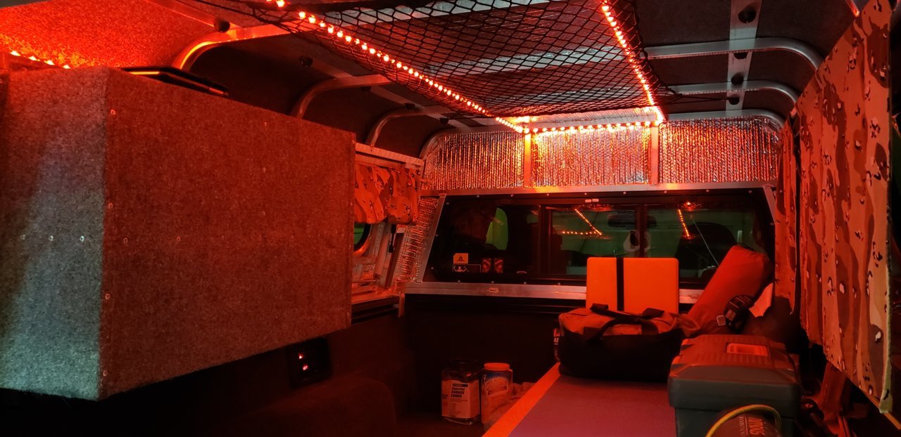

    Finished up my modular drawer and sleeping platform. Feels stout. I discovered Ganahl Lumber during the build. They are great if you don't have the ability to do cuts to large portions/sizes of wood. I had a parts list and did the optimization to decrease loss during the cutting process. They did all but two cuts and that's only because I had to have that part in place to make the measurements.
    The drawer section is primarily where I'll be sleeping. There is a small shelf piece which runs along bedside and it is easily removable. Various things are stored under the shelf. One item which fits perfectly and provides support are the Camco leveling blocks.
    The driver's side is one piece which is supported by the wheel well and two glued 1x1 pieces. I'll probably put a third 1x1 piece towards the tailgate end. Under this section is my hi-lift, compressor, recovery bag, and other miscellaneous items.
    So far I'm pleased with the end result. Gotta give thanks to HBMurphy for loaning me some tools to get this project done. One of the best things about this forum is the friendships I've made here.

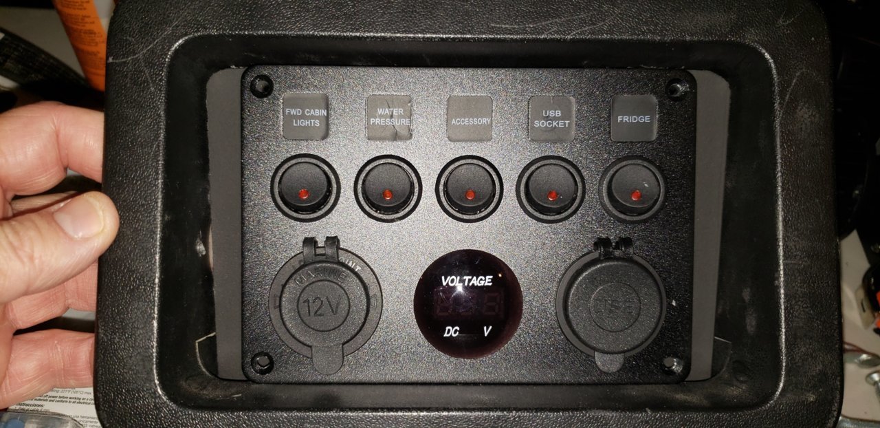

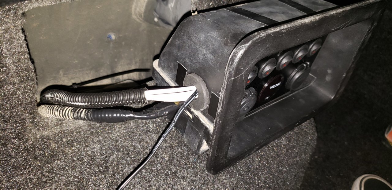

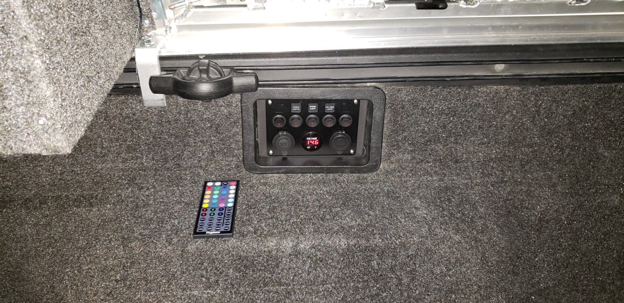

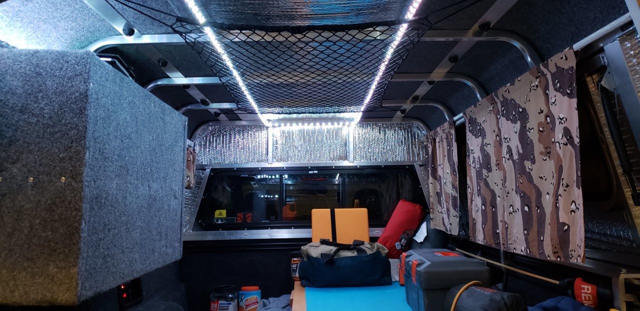

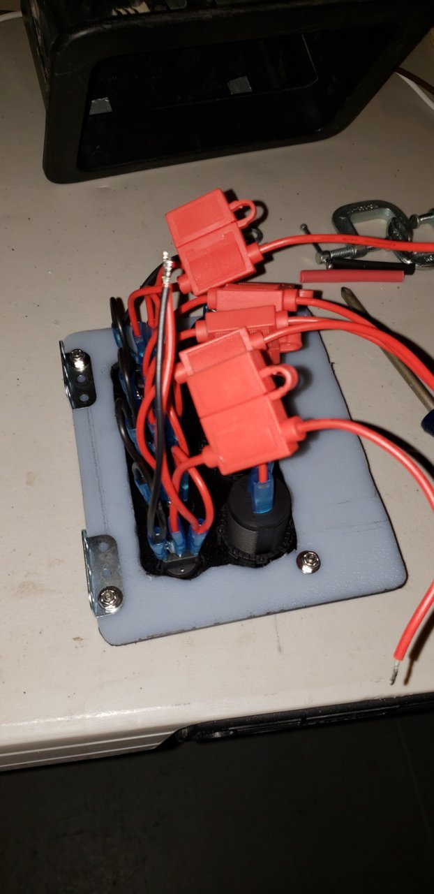

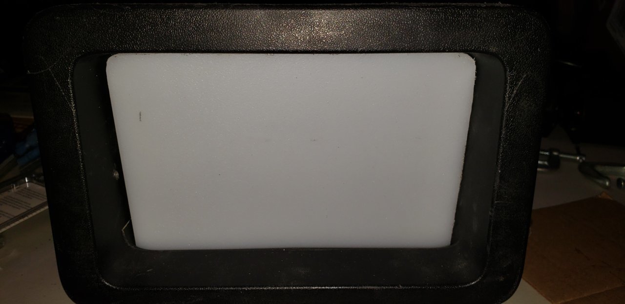

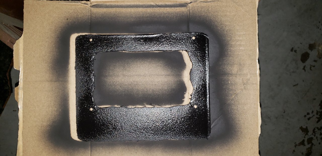

    In between semesters and one goal was to complete the installation of the 6 gang switch plate and hook up my four nilights and interior LEDs.
    For the installation I used a plastic cutting board from wallmarx that was less than $2. Next I made a cardboard template. Measure and measure again. After some trial fittings and trimming it was time to paint the cutting board and get everything hooked up. I'm no electrician but for now it works. I will need to re-address the ground for the starboard side lightin in the future.
    From the inside of the cab I have a master switch for all the power to the switch plate. Inside the truck shell I can turn on the rear lights and individually both left and right side lights.
