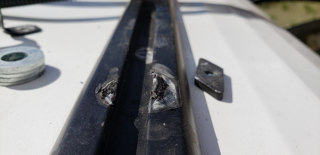

    Shower update:
    I believe it was two years ago when I decided to try my hand at building a ABS shower tube. With the transition from the FWC to the Tradesman I had to figure out a new way to mount the shower to the roof. On the FWC I used some foam blocks carved out to cradle the pipe and straps to tighten it to the crossbars. It worked well on the first trip I took it on. Using it wasn't that easy if the FWC top was popped up. It was quite stable though during the trip-highway and offroad.
    During this years (2019) May-June trip I was using pipe hangers mounted to the Yakima tracks. Problem is the height of the crossbars I use to mount my lights and awning are higher than the base of the pipe hangers. I couldn't find any raised blocks of aluminum at the local hardware stores. So it's ghetto mounted using flat washers. I have four square nuts in each Yakima track. For some reason these are not easily moved along the track. They bind up at certain spots. On a different forum someone suggested using cam nuts. So on the May-June trip I had the shower tube mounted using the cam nuts. The shower tube was filled up prior to leaving a campsite near Bishop. I took a wrong turn onto a main dirt road and soon realized my error. Upon turning around I see my shower tube in the road. The tube was emptied back into a 4gal container I carry for shower water and a field repair took place. The failure occurred due to the cam nuts tearing out of the tracks.
    The next trip in June to the Lee Flat area I did another field repair due to the mounting bars being loose. I moved the inboard square nuts from the crossbar mounts to the shower and used the cam nuts for two of the four mounts on the passenger side of the crossbars. Hopefully that makes sense. I did use the shower again on this trip but noticed the faucet mount leaking a bit, no doubt associated to the fall onto the road.
    Once back at home I sawed off the cap with the Schrader valve and faucet. The faucet was able to be used again but due to the proximity of the glued pipe inside the cap, the Shrader was sacrificed. Good thing they come in a two pack. Another end cap was fabricated and glued up.
    On my most recent trip to Owens Valley I was ready for an evening shower before dinner. I had filled the tube earlier in the day and the temp was good. Sorry I rarely record the temps but should try to do so in the future. With the compressor and water hose attached it was time to feel like a million bucks. I turned the compressor on and within a very short time the newly made end cap blew off and four gallons of water quickly flowed out of the shower tube. Well that sucks. It's always good to have extra water which I had on board. Having a back up shower system is also good and my MSR Hydromedary shower was filled and utilized with some water to spare.
    The next day the remaining water in the shower bag was used before I left camp. It was very hot after sitting on the truck roof all morning.
    After the last trip and shower malfunction I knew exactly why the end cap blew off. I had only put glue on the inner surface of the cap and not the outer surface of the tube itself. The inside of the end cap was cleaned out and prepped for remounting. Following 24 hours of cure time (more than necessary) I filled up the shower tube with 3 gals and went about hooking everything up to test it. I tested it before the recent failure but not with water. Air only. The can of ABS glue even says to pressure test but not only with air which is what I did before the last trip. With water the glue on one surface was not enough to hold the pressure.
    Currently the shower tube is mounted and functional. The mount system will be reevaluated for any future trips this summer. School starts in late August and the next trip after that will most likely be a winter Saline/Death Valley trip where the shower tube may not be necessary. I will say that I'm still quite happy to have gone about making my own shower system. Being able to take a shower in the middle of nowhere is great! The ABS/PVC type of showers can be done anyway you want. There are tons of videos on YT showing various configurations people have come up with. It may not look as slick as a Roadshower but it works nonetheless.

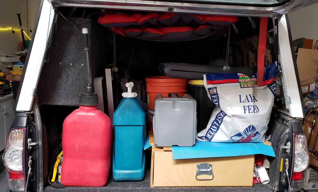

    Typical summer load out

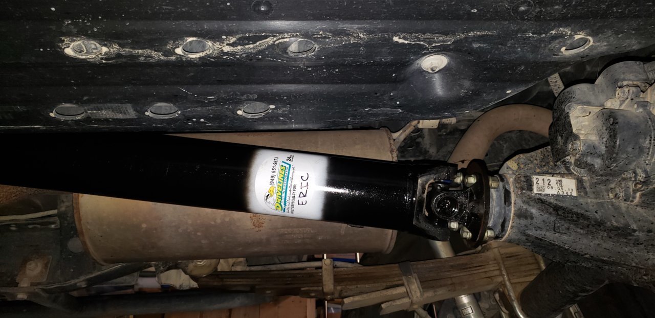

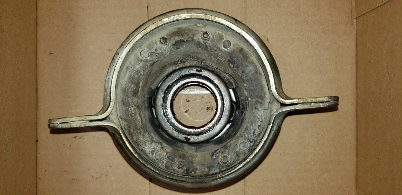

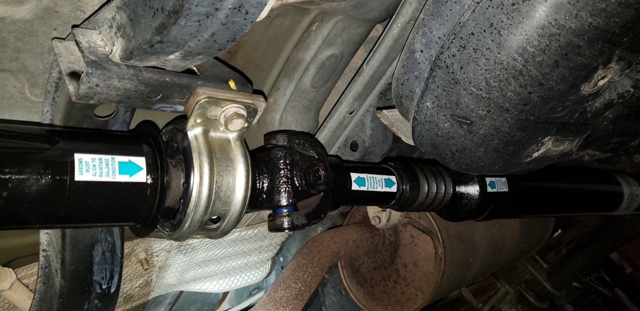

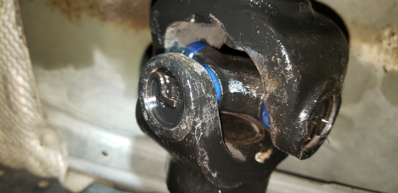

    2019 Carrier Bearing update
    This is the 2nd carrier bearing I've put on since new so 3 including stock from factory. Many know this can be a problematic part on our trucks. There are two Spicer options to replace the factory version. One of which is used by Toyota. There are some polyurethane options out there too. I ordered the bearing and sought out a reputable shop to do the exchange, replace the u-joints, and balance the drive shaft.
    Driveshafts Incorporated in Mission Viejo is an outstanding shop and @HBMurphy recommended them to me. The owner is a former Marine and may provide a discount to veterans and other former Marines. The service averages about $400 and the work was done by noon on the same day I dropped off the truck. The owner also shared that it was good I came in when I did because there weren't many miles left on the bearing/joints. Grateful not to be stuck on a road in the middle of nowhere due to a malfunction which could have been prevented.
    Attached are photos of the new/old carrier bearing, old u-joints, and the freshly painted and balanced drive shaft.
