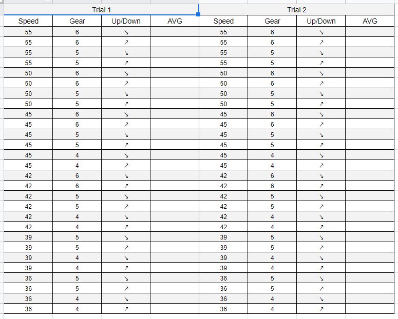

    I don't pay attention to timing or AFR, but I do pay close attention to fuel flow rate. If I'm driving along in S6 and I see a hill coming up, I will preemptively shift to S5 or S4 to give the torque converter time to lock before the hill actually starts. If I shift way too early, I can tell a 10% increase in fuel flow between S6 and S5, and about a 25% increase in fuel flow between S6 and S4 with the same slope and this is after the torque converter locks (an unlocked torque converter is miserable for power, efficiency and ATF temp, so if it unlocks, I downshift, and if I know it will need to shift, I try to shift in advance before it's needed to ensure the TC is locked already.) and those are obviously not scientific figures, but they're statistically significant enough to tell me that it definitely uses more fuel when in a lower gear than the highest suitable for the conditions.
    I will conduct a test with my scangauge this weekend to satisfy my desire for scientific data. I know of a 1 mile stretch of rural road with a 1.3% grade that is always empty on saturday morning. 1/4 mile for decel, turn around, and 1/4 mile for accel each test. I'll go down there and drive up and down 28 times at different speeds and in different gears, basically I'll fill out the spreadsheet below. I'll get up to target speed, set the cruise in S mode with the tested gear, and reset my trip AVG MPG with my scangauge at the start line, and pen down the reading at the finish line when I stop for the turnaround. I'll do trial 2 in reverse order (filled out from bottom to top) to get the best possible averages. Then I'll graph the data and we can draw some pretty good conclusions from there. So far I have only a scientific score of 2/10, but this test procedure should be a solid 7/10 for scientific credibility. I would need a really good indoor dyno, a machine driver and a more accurate metering device for that coveted 10/10, but I think it'll be good enough.

    Holy shit. The time you're wasting on this could fuel your truck for a year unless you value your time as zero

    I'd "waste" 4 or 5 hours and 4 or 5 gallons of fuel. Science doesn't come free, but that's a cost I'm just willing to pay.
    If I find out that it makes no difference what gear I drive in, I have knowledge that will enable me to drive in whatever gear I want effectively without consequence, and I can share that knowledge with other 2.7 Tacoma owners.
    If I find out that driving in the highest gear allowed for the situation saves fuel, I'll also find out a rough margin, and I can decide if that margin is worth more frequent shifting, and I can also share that knowledge with others and they can decide for themselves.
    If I find out that driving in a lower gear is actually more efficient, I can figure out how many miles I need to drive by driving in a lower gear before I make up the fuel this test costed me.
    Either way I think the knowledge I gain will be worth the time and money.
