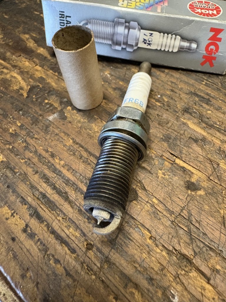

    last time I heard knocking/pinging
    This is what my plugs looked like:
  17. Jun 18, 2025 at 3:41 PM
    #17
    ControlCar
    ControlCar My Moto: Help & Learn…period.
    Jul 22, 2023
    #429578
    3,376
    Steven
    Sugar Land TX
    1996 Taco 2.4L 2wd Automatic
    Clock Volt meter/LSPV Delete/Hyundai 16’s/FP gauge/after 9months of wrenching ZERO oil leaks
    This was only using 93Oct
    not the fuel but fuel delivery issue
    New short block needed

    Hesso
    Hesso Member
    Jun 2, 2023
    #425905
    12
    Colorado
    2001 Tacoma TRD
    Yikes! That's what worries me about all the repairs I've done, because none of them will account for some bad crankshaft or rod bearing. I'm noticing Toyota is beginning to drop the parts for these 1st Gen Tacomas. Ugh!
