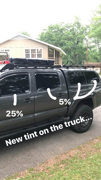

    Tint is done on the truck. Unable to see into the backseat or inside the shell unless your face is against the window... and still it is hard to see into it and make anything out. Fronts were redone with 25% instead of crappy 35%. Should help keep the truck and the fridge cool during the summer for sure now.
