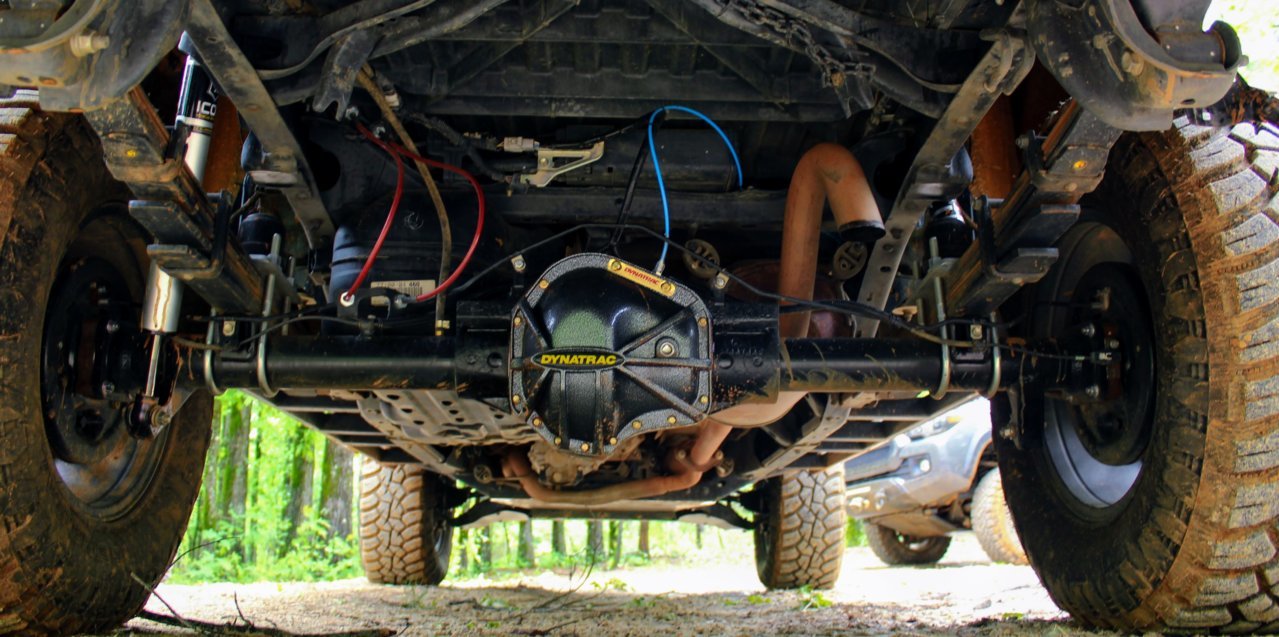

    Now to try and get the rear suspension even more upgraded before Jambo...

    Whats the plan?

    Need to get some spacers for the bump stops so they are a little higher and contact more instead of bottoming out the shocks.
    Am going to attempt to get an shackle flip kit so I would be able to fully extend the shocks and get as much flex as I can from the rear end.
    Right now the shocks are only able to extend 9.5" instead of the intended 11-12"

    Steven are you putting your flares back on?

    Right now... no. I am wanting to get some cheap bushwackers that I can cut and trim like @trekker but going to wait until the summer to do that I think.
    Main thing is trying to fab up some simple fender liners for parts of the fender that I don't really want mud in.
    It is pain to clean now...
