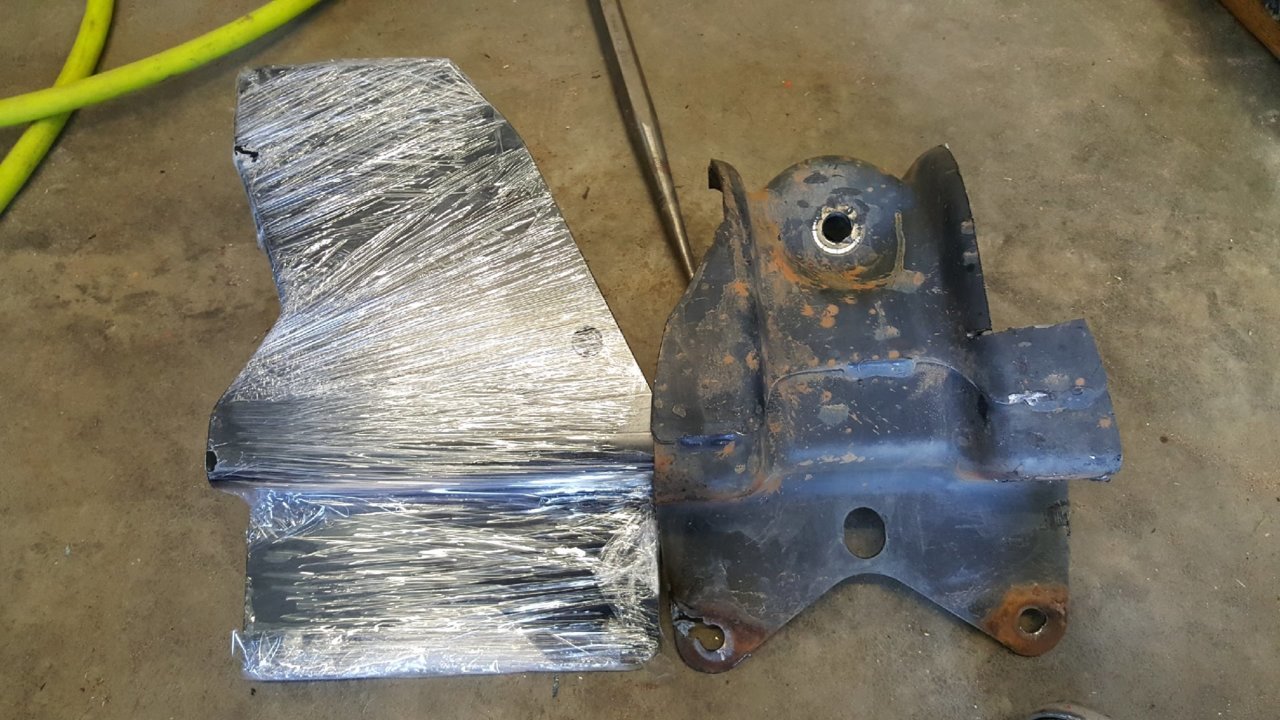

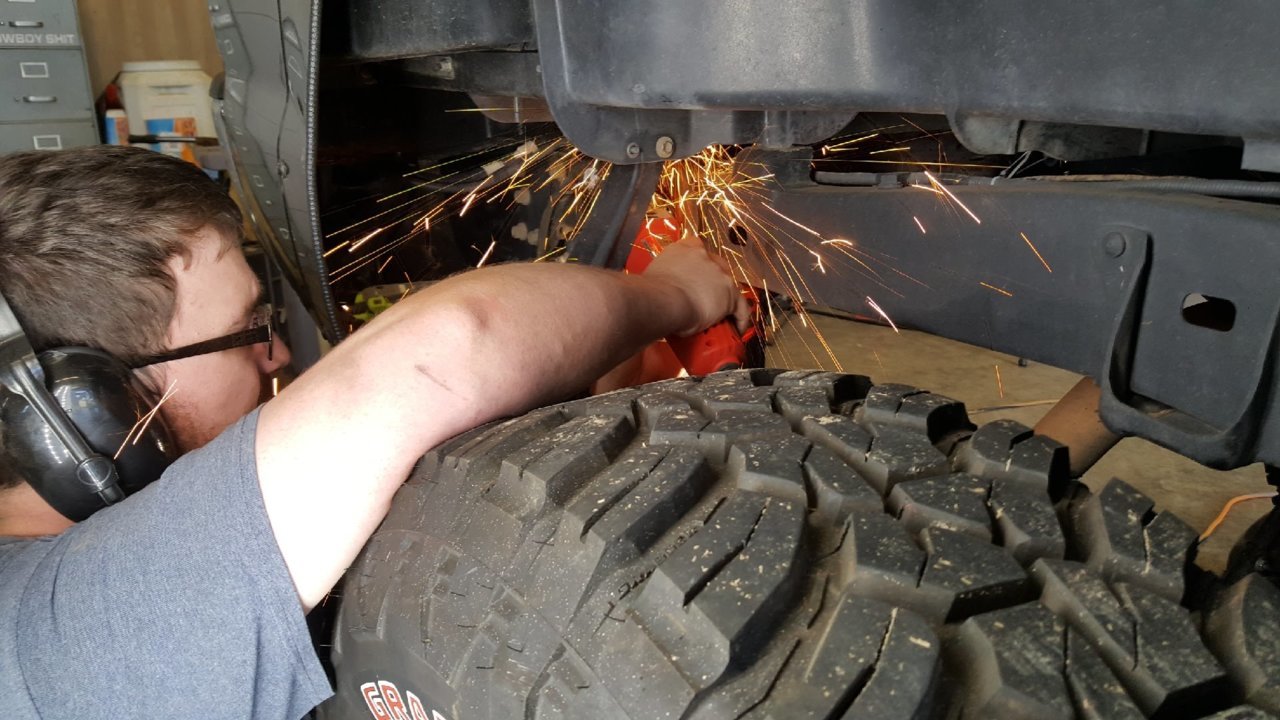

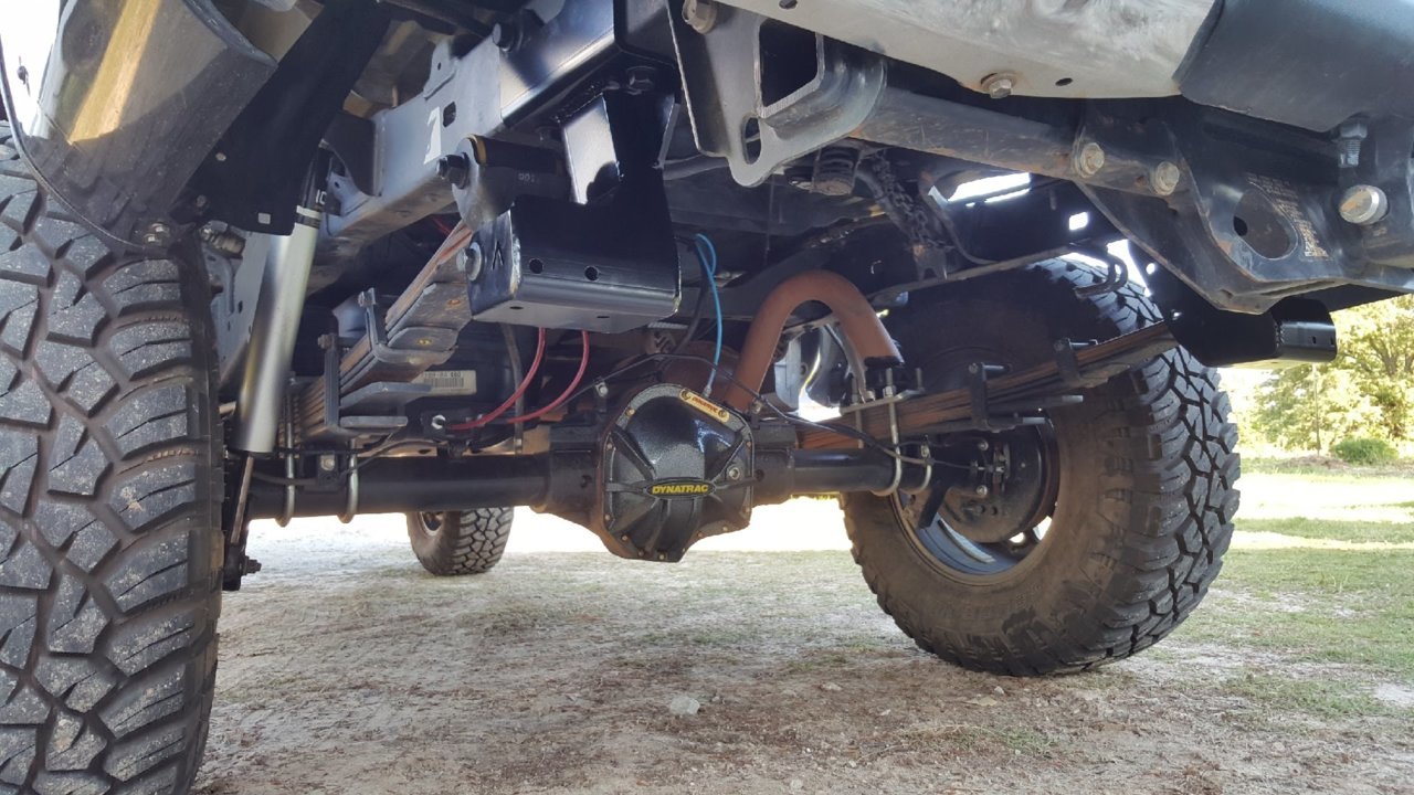

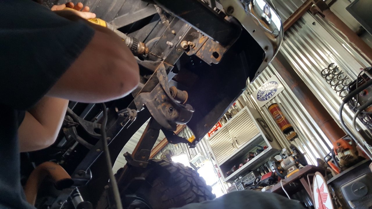

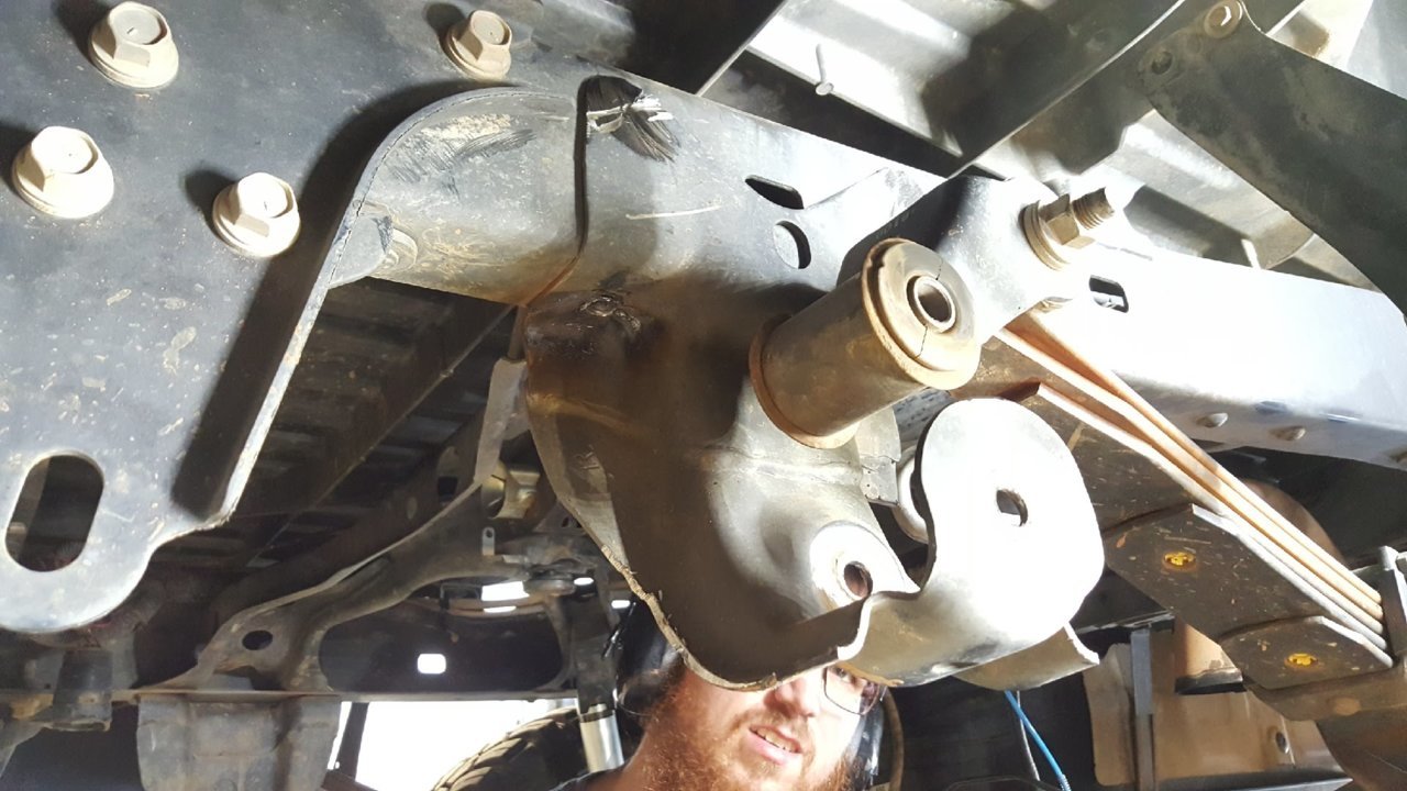

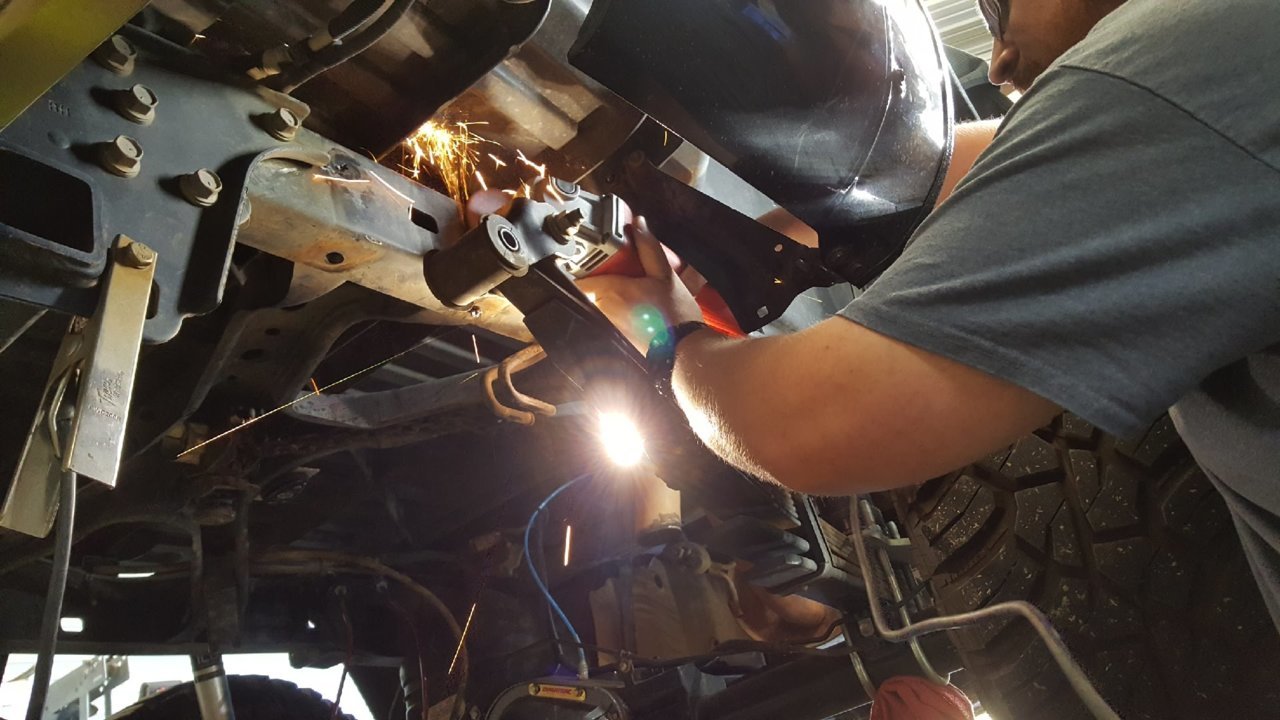

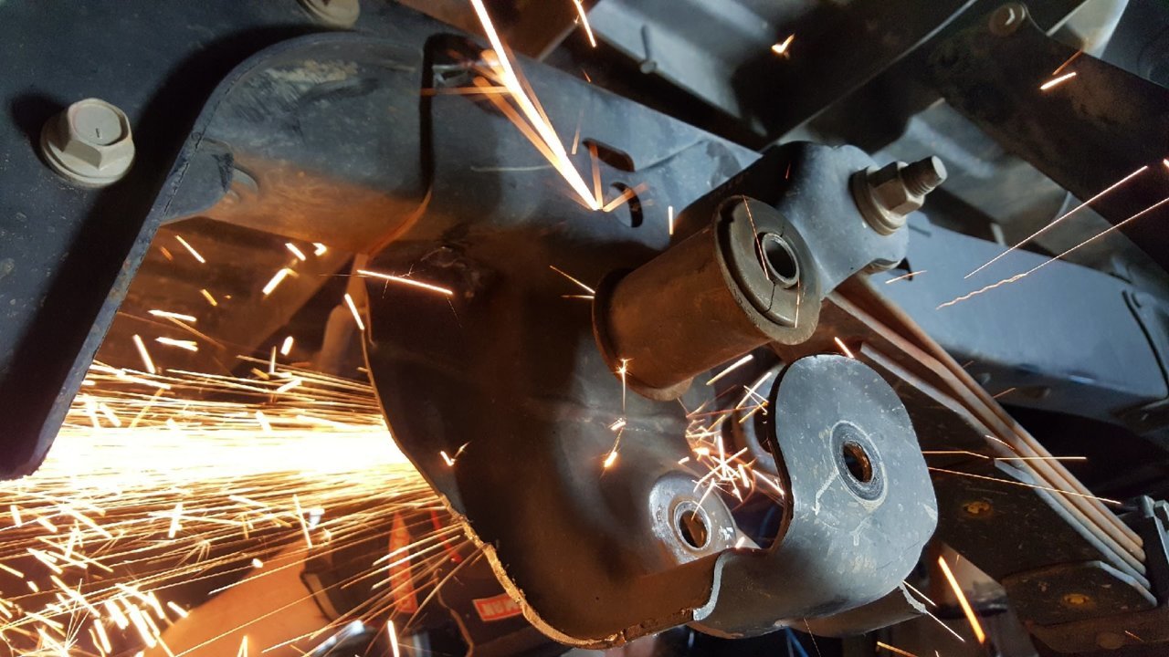

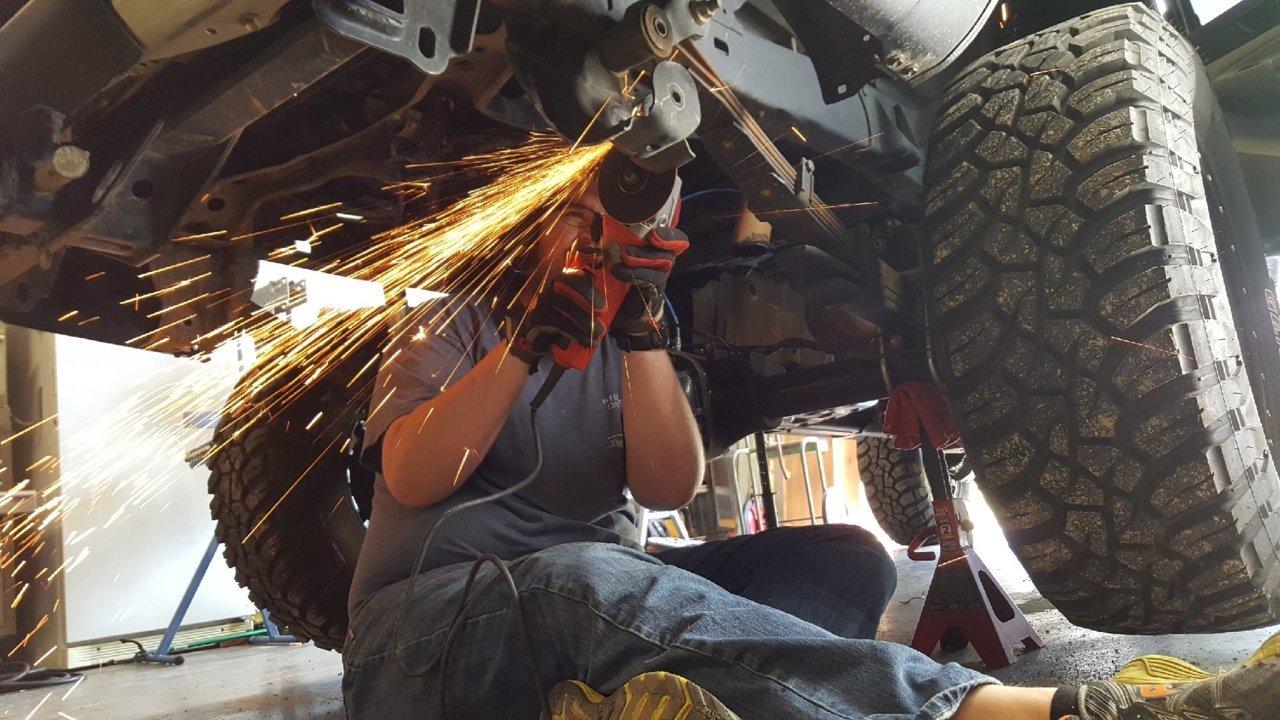

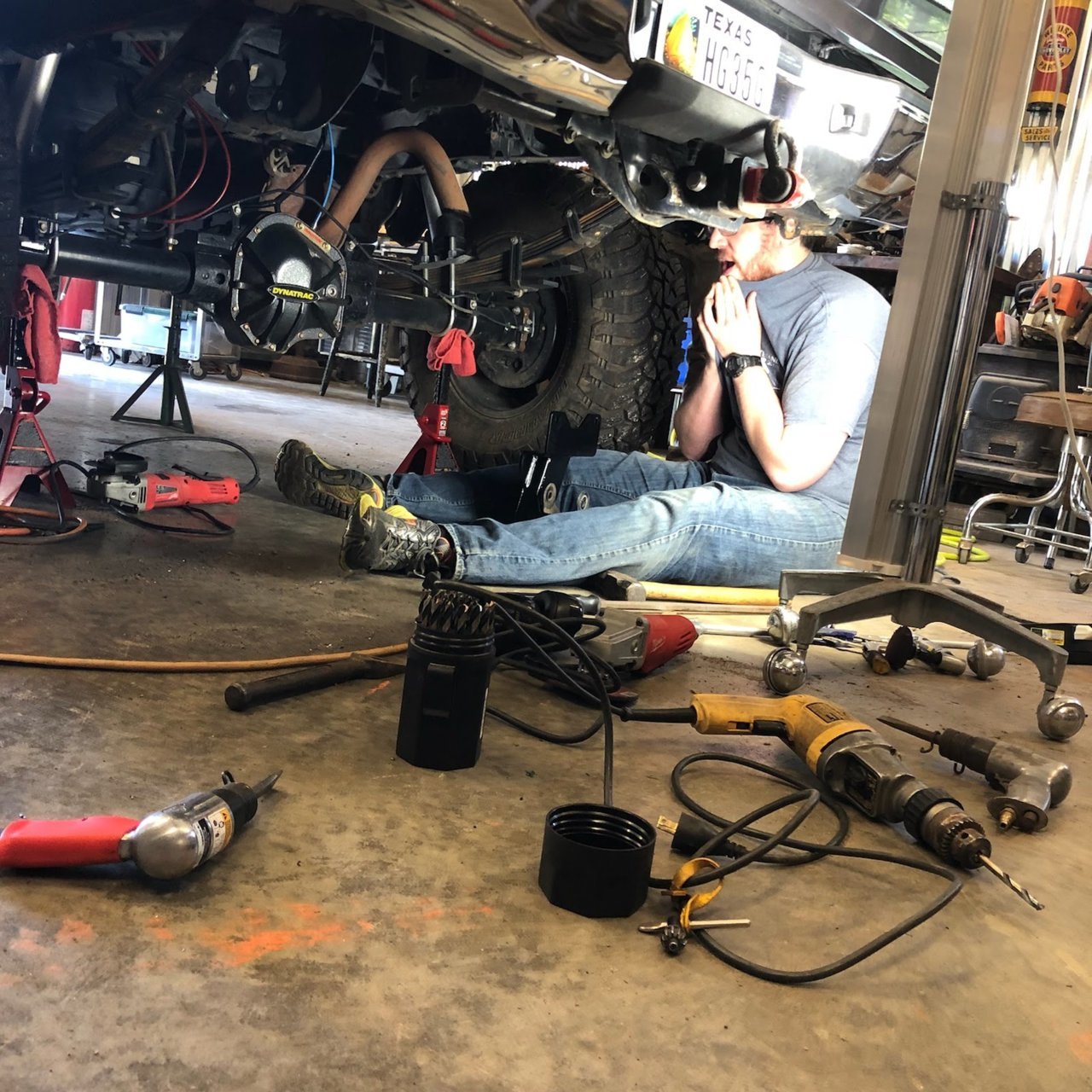

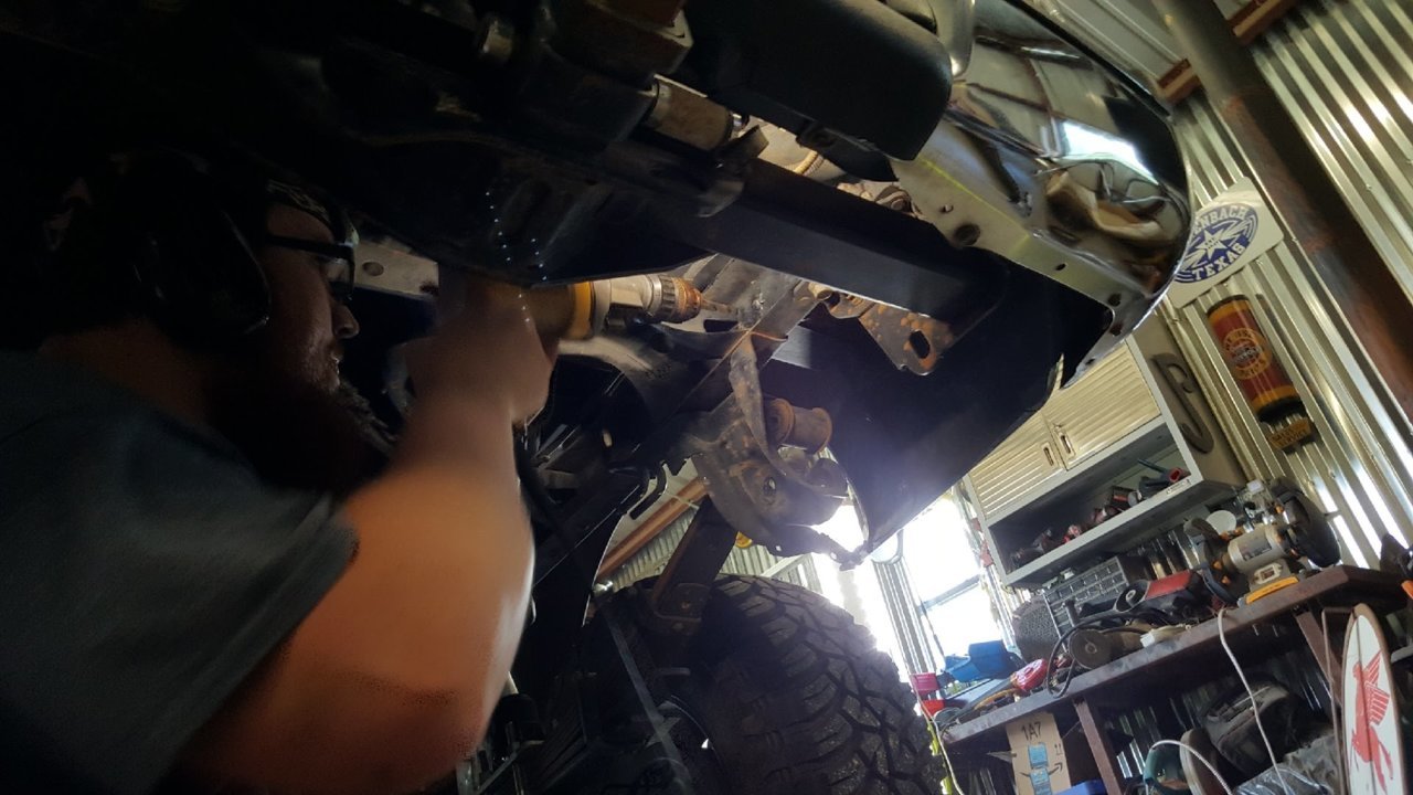

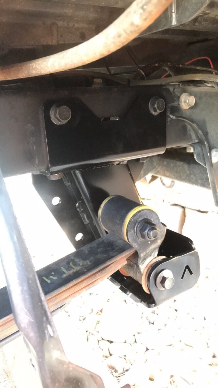

    Got the @ARCHIVE Garage Hammer Hangers installed yesterday, last major project finished before the Lone Star Toyota Jamboree. Only thing left is just minor stuff. Also did an oil change, threw on a couple stickers, and installed one more rock light on the rear of the truck.
    With the help of @Zac of all trades we did the install in about 6 hours or so, as this was our first time to ever undertake something like this, it was a learning curve on what to do and how to do it correctly.
    First off, jack the rear of the truck up and place jack stands as high as safely possible on the frame so the rear of the truck is off the ground. Put jack stands under the rear of the axle so the rear tires are barely off the ground I would suggest. Remove the rear shackles from the shackle hangers, I would also suggest remove the shackles completely from the leaf springs. Honestly, at this point, you could remove the jacks from under the axle, or leave them, up to you. But just get the leafs as much out of your way as possible.
    Honestly, the safest way is to grind the rivet heads down flush with the stock hangers, I would also suggest going ahead and cutting off the stock hanger so you can get to the bottom rivet heads as well. Once they are all smooth, take a center punch and put a punch in the center each rivet and then drill a small pilot hole through each and then go through with the drill and start drilling to say 1/4" or so.
    Side note, once you have the pilot hole drilled in all of them and they are all flush, you can pretty much go ahead and take a pry bar or a ball joint tool and try to pop the bottom of the hanger out of the rivets and then pop the top out as well. Then taking the grinder again and grinding the rivets flush with the frame once more. You can then take a punch and 3lb sledge and push the top rivets out pretty easily, but the bottom ones should be drilled out to 1/2 to be safe as it will bend since the washer is there. Then go through and drill all the holes to 1/2" and make sure all the holes fit well with the supplied bolts. Then grind the frame rust and the give it a good coat of paint and let it dry a little bit before installing.
    Take note as we did not do the above on some of it and it was a pain in the A.
    We also found the easiest way to install them on the truck was to remove the jack stands from under the axle and let the suspension fully go down, install the hangers onto the frame and then using a hilift jack or floor jack, raise the rear of the truck using a attachment point at the hitch or under the hitch to bring the rear of the truck up so the hangers go up enough so that the shackles drop down to be able to get the bolt through the leaf bushing. We ended up having to do it one side at a time, so lift it up, get the driver side bolt through, lower the truck a little and then go to the passenger side so we can get the leaf bushing into the shackle and then lift the truck again so the shackle will drop enough to be able to get the bolt through as if you don't do that, the bolt will hit on the Hammer Hanger.
    I would do it again, but I would at least know what I would be doing next time around to make it go a lot smoother.
    So far, the ride to me is a lot smoother over bumps in the rear and not as harsh, there is a little more lift in the rear from what I can tell, we also had a hilift jack maxed out and the shocks were at 10" and the tires were not off the ground and the shackles were not even drooping down yet, so there will still be some more droop to be gained that I will find out how much on Wednesday when I put the truck on a 2 post lift again.
    I also know that my rear brake lines are not long enough, so I already have some +6 brake lines waiting to go on instead of the +3 brake lines and those will go on Wednesday.
    But enough text... here are the pictures that were taken yesterday.

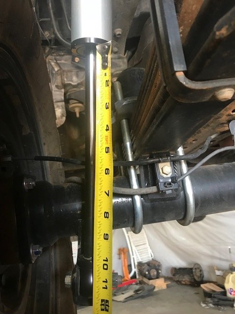

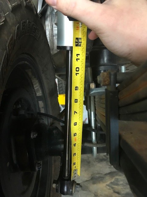

    I put the truck on a 2 post lift yesterday at a friends shop to check the full droop of the rear end, check to make sure I have enough slack in the lines, and to check the torque on any bolt I could get to.
    But here are the measurements before and after the Hammer Hangers.
    I measured on flat ground from the lip of the fender well to the ground both passenger and driver side.
    Before HH - 42.5"
    After HH - 43.25"
    Difference = +.75" in the rear approx.
    Travel measurements
    Before HH - Icon Shock Max Travel - 10"
    After HH - Icon Shock Max Travel - 11.5"
    Difference = +1.5" Travel
    I have enough slack in the Diff Breather Line, ABS Wiring, Air Lock Liner, and with adding some spacers on the bottom bracket for the brake line, there is enough slack in the brake lines that there would not be an issue. I had a set of +6 brake lines to go on... but looking at it, they are going to be too long honestly at no droop, so I am going to try and sell those and get a set of +4 as they should be pretty much perfect.
