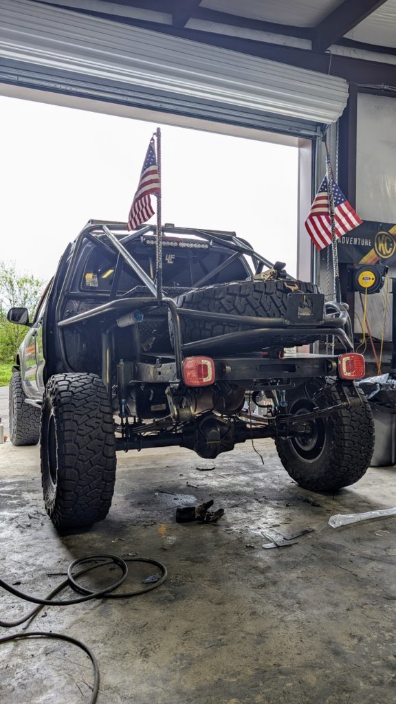

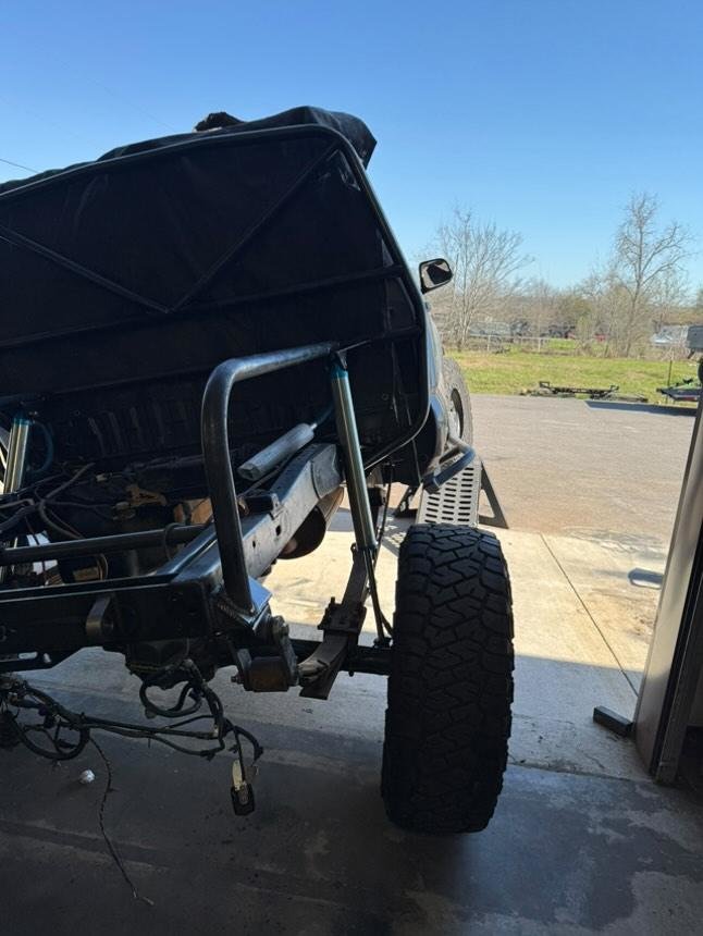

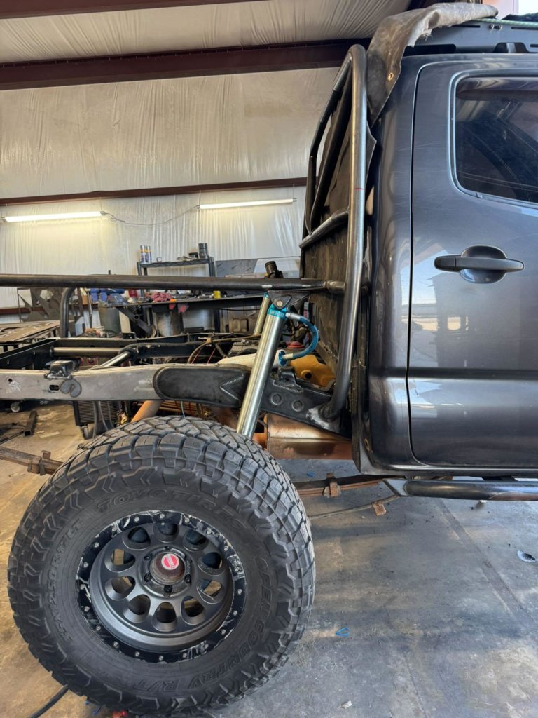

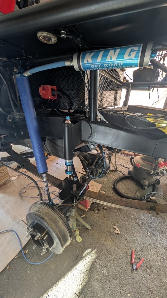

    Going to need longer shackles for sure.... max droop currently and not even all of the shock is being used....
    But... have to figure this out as how it sits right now... will hit the frame at extension and then when tucked will hit the tire...
    Tire rubbing can be fixed with running spacers and then looking at maybe different offset wheels at some point...

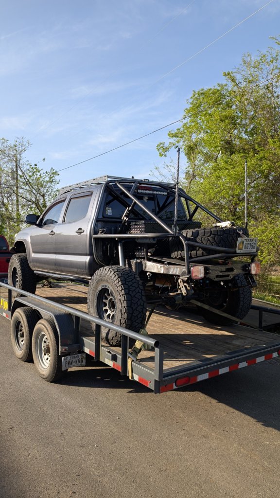

    Picked it up yesterday! Now to take it all apart, clean, prep, paint, route wiring, wire everything up, start installing the long list of things I have...

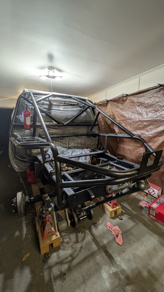

  6. Apr 10, 2025 at 10:24 AM
    #5546
    ETXTacoma
    ETXTacoma [OP] Someone gave me a plasma cutter.
    Feb 12, 2016
    #177942
    16,307
    Steven
    Tyler, Texas
    2014 DCSB Tacoma TRD OR

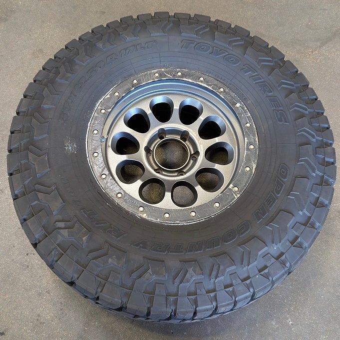

    37s are mounted to the Stealth Custom Series Ray 10s...

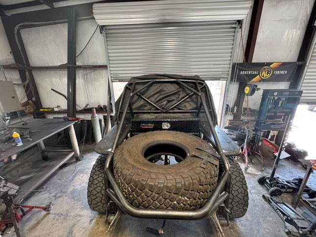

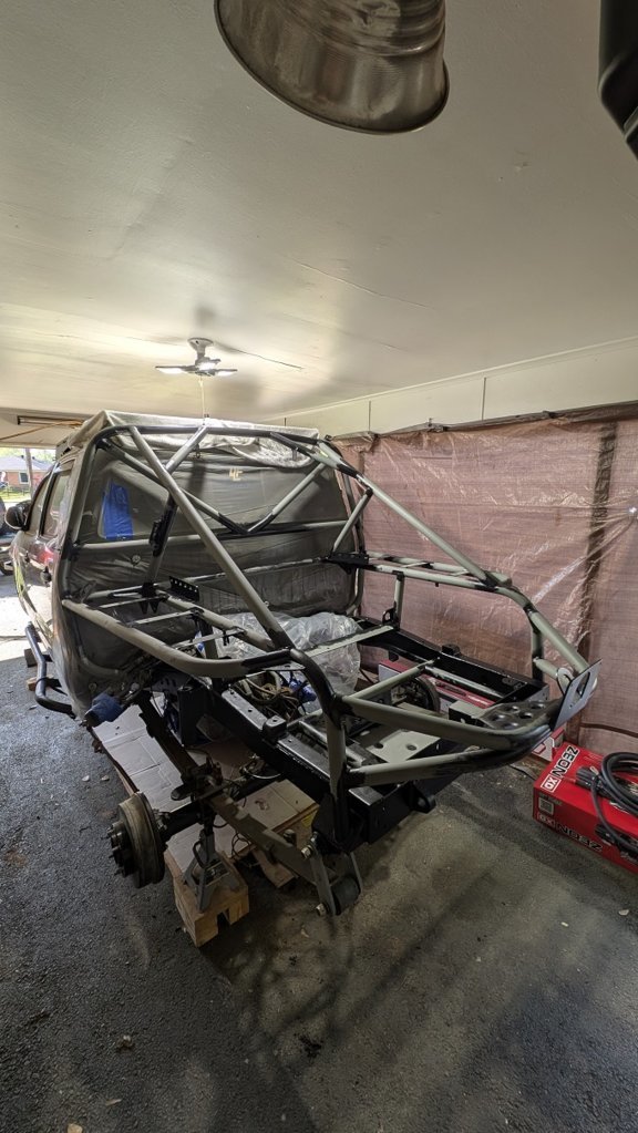

    Bed Cage is pretty much painted completely, forgot to take a finished picture of it... but at this point, I can start doing wiring and all that really fun stuff.

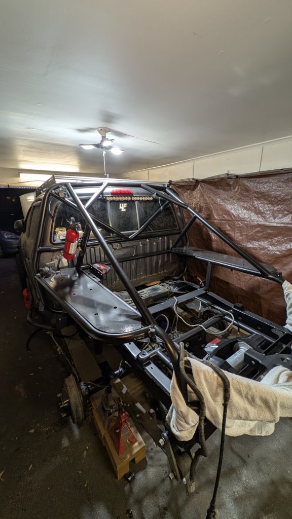

    Cage is all painted... starting to install some of the lights and then start doing all the wiring and everything for it...

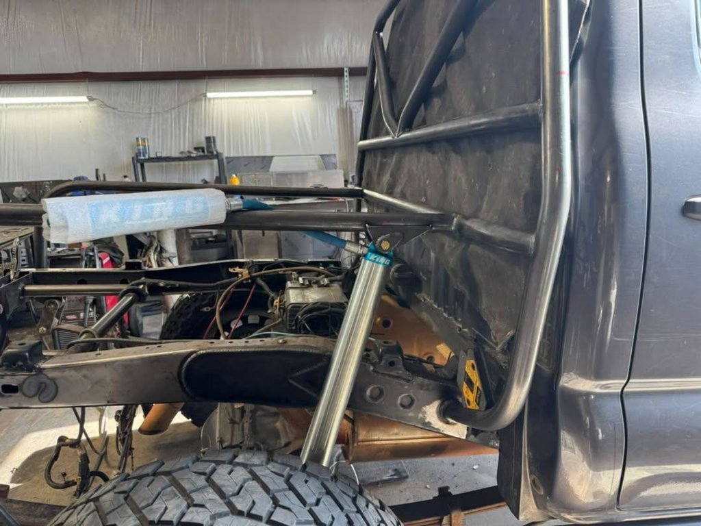

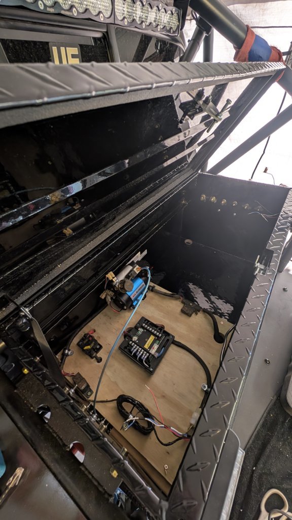

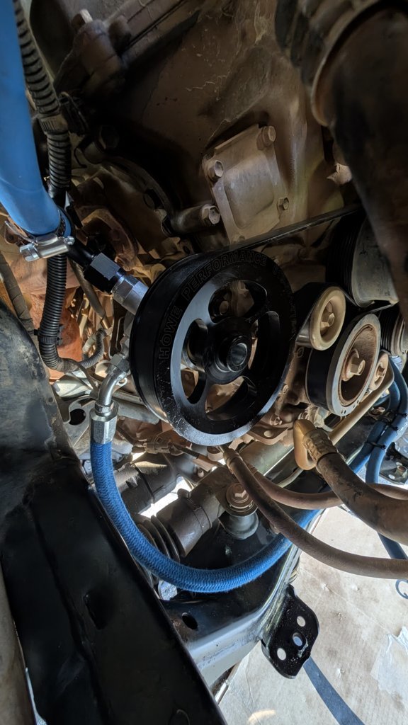

    Lots of progress made over the last week...
    Suspension is fully back installed and ready to go, have just left the rear wheels off to give me more room to work on things.

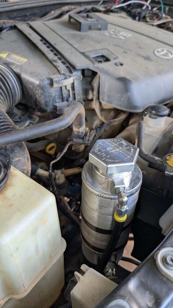

    JD Fabrication / Howe Power Steering Upgrade done besides bleeding the lines - waiting on fluid to be delivered.
    Rear wiring finished up last night with the secondary sPod, relocated the air compressor to the back and reran the air locker air line.
    Got the taillights done, winch rope installed besides fulling spooling it on the drum, whips wired in, all the rear lights wired in, rock lights rewired up.
    Installed secondary electric fan last night and wired in to the front sPod...
    Redid the wiring under the hood with SDHQ Battery Terminals, moved the Baja Designs LP6 wiring to the spod, XL80s wired in, and all that is left for the front is the 40" S8 Bar to wire in.

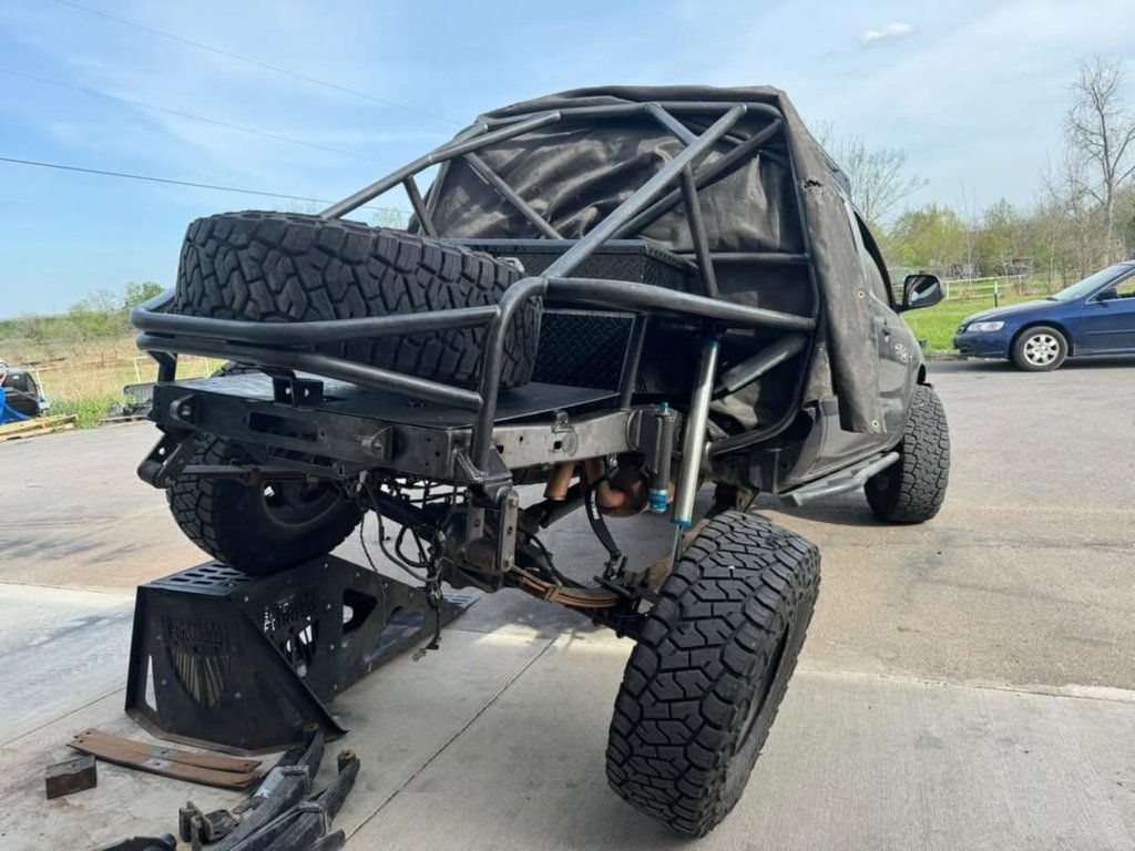

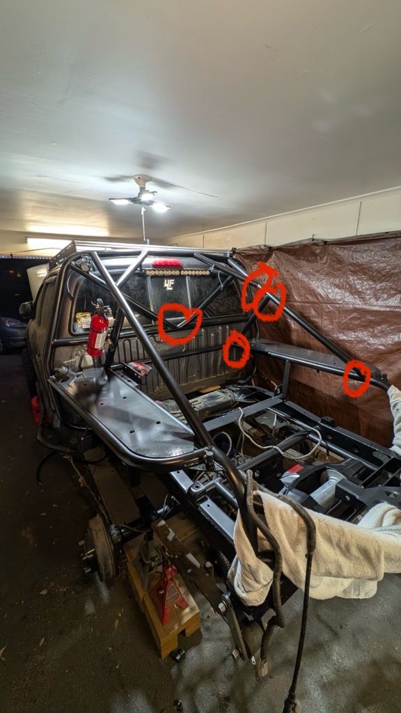

    You've got ALL the dead nodes in that bed/cage design.....
  12. May 8, 2025 at 2:16 PM
    #5552
    Naveronski
    Naveronski Well-Known Member
    Sep 14, 2013
    #112501
    9,517
    Fort Worth
    2014 MGM DCSB TRD:OR
    What is a dead node?
  13. May 8, 2025 at 2:52 PM
    #5553
    Snowy
    Snowy Is neither here nor there
    Feb 5, 2014
    #122349
    3,465
    Connor
    Winnebago, IL
    3 linked 98 Xtra cab
    Stock-ish
    Load paths that just end in the middle of a tube with no triangulation or connecting tube on the direct other side of the load path to prevent shearing or bending. It’s the old joke about more triangulation is always the answer and this one has no real triangulation at all
  14. May 8, 2025 at 2:54 PM
    #5554
    Naveronski
    Sep 14, 2013
    #112501
    9,517
    Fort Worth
    Ahh, okay. Do you think it would fail during a rollover? Or if it was going to be a competition truck, it would need additional bracing?

    If I end up in a rollover, I have more problems to worry about honestly...
    Maybe @Mynameisbrandin can chime in?
