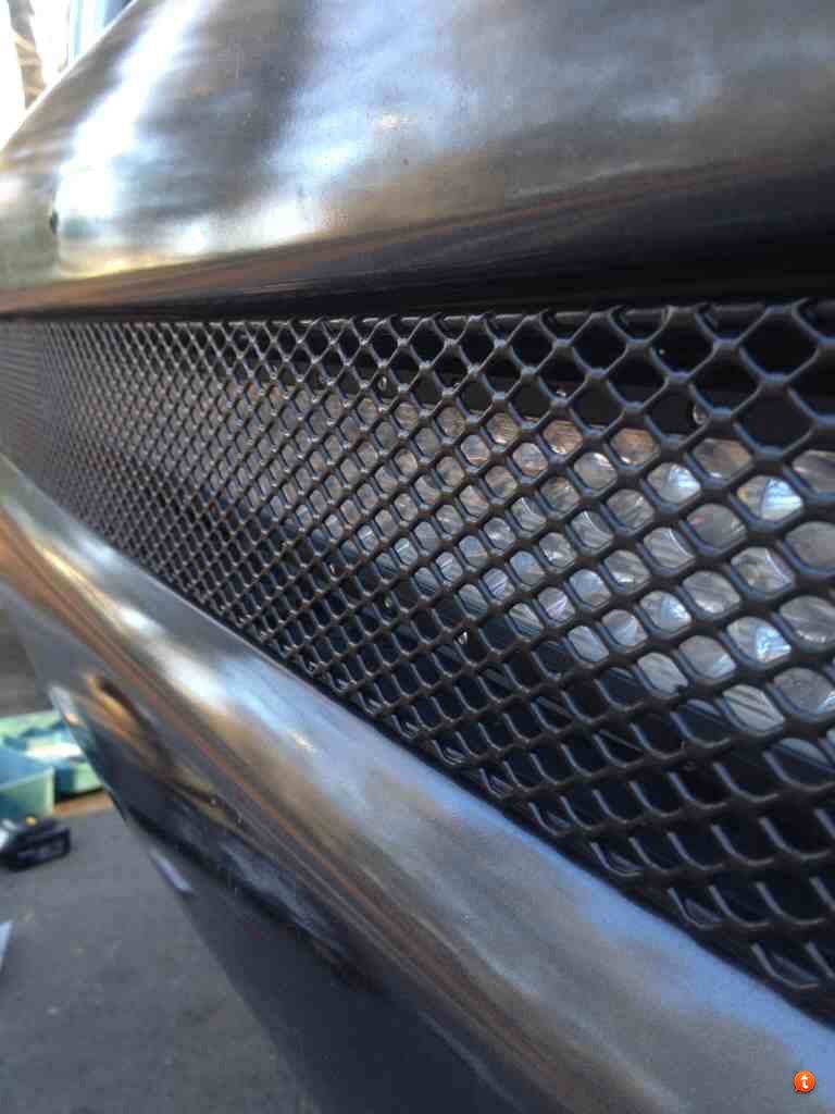

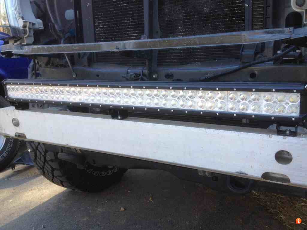

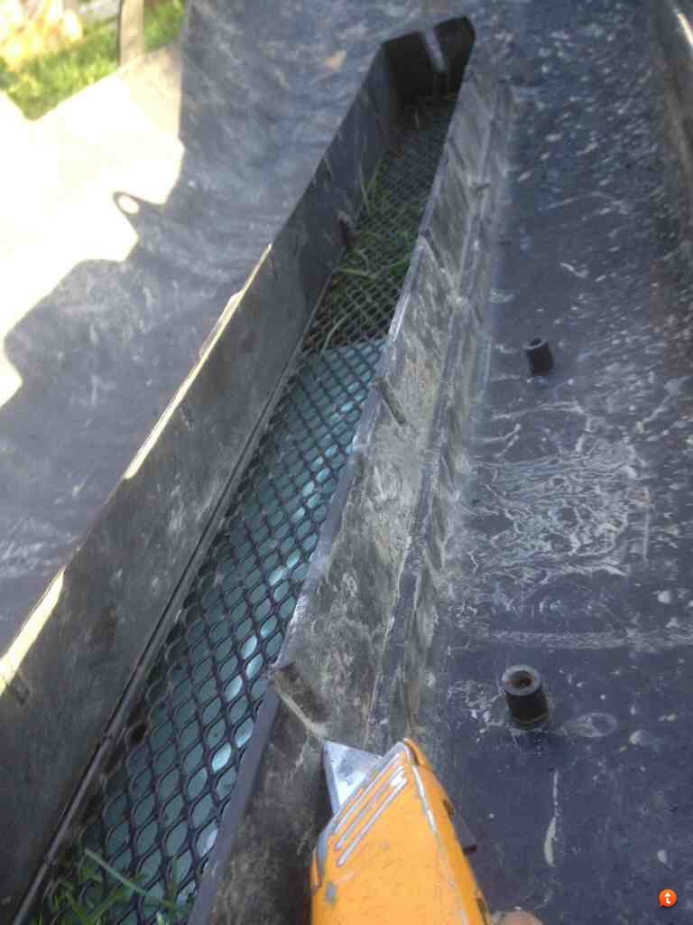

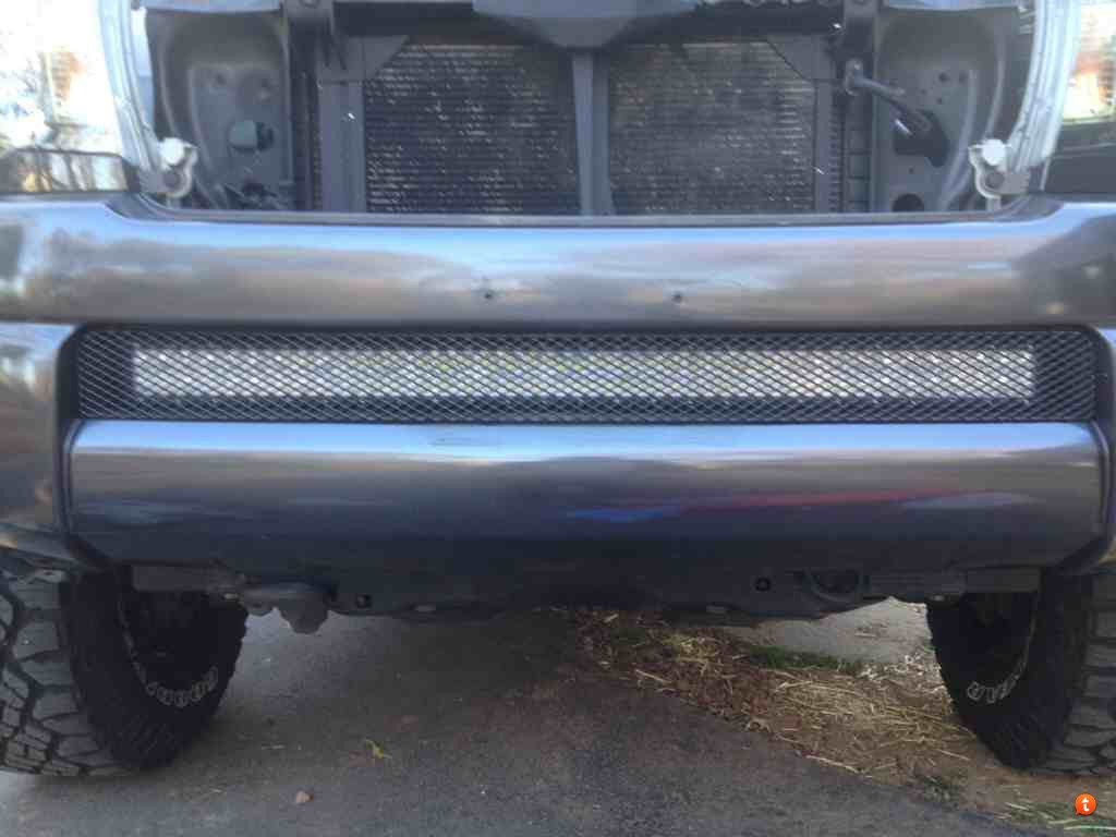

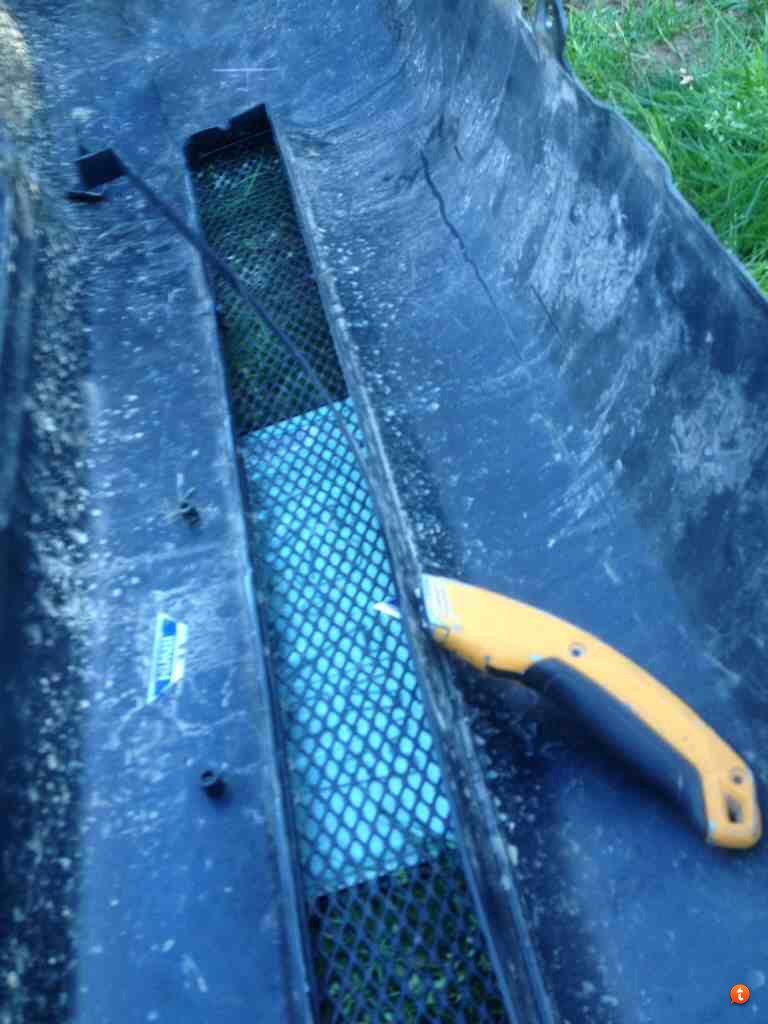

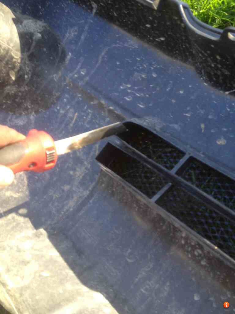

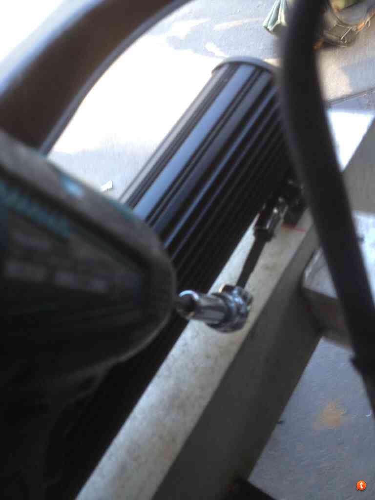

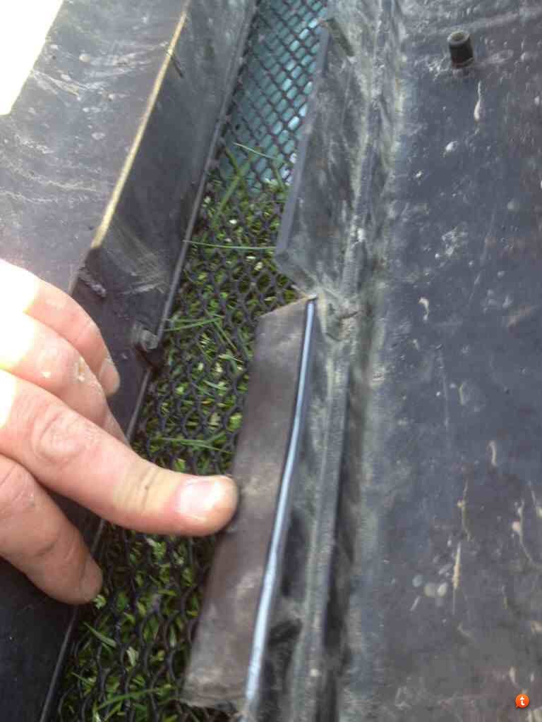

    These might help, i can grab some measurements of the sliding bottom mount brackets i used. I mounted them directly to the aluminum crash bar using self tappers and the height was pretty much perfect
    Score and snap :D

    Very nice! Thanks. Good to hear. So with the spot pattern, I know led bars really don't throw a lot a light down range, but was it decent? Would you have rather gotten all flood?
    Thanks for the pics. Im only worried about the clearance in that bottom bumper due to my superchargers intercooler pump sits down there.
