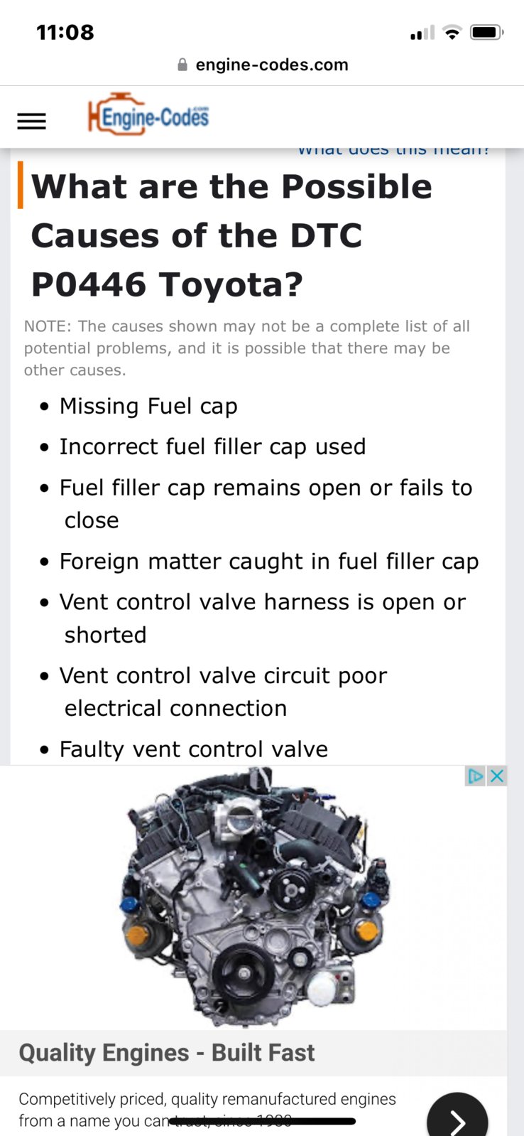

    I know this thread is a few years old but I just picked up an 02 Tacoma and have a engin light on as well. Don’t remember the code but I cleared it and it came back on after 5 days. I’ll go scan again today.
    truck seems to run fine but my issue is filling the tank. The pump pops every few seconds and take like 20 min to fill up. Any idea what would cause that?
    also I do get the hissing when I open the cap like it’s purging the air pressure.
    just scanned and am getting code P0446
    thanks all!

    Try checking your VSV valves first. Here's a thread on it https://www.tacomaworld.com/threads/p0440-p0441-p0446-trouble-codes.200359/#post-24306485
    If they're all good, then perhaps try a smoke test to see where the leak is coming from.
