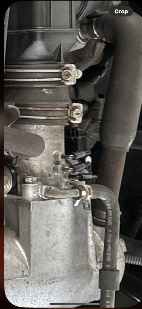

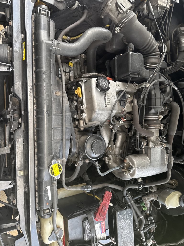

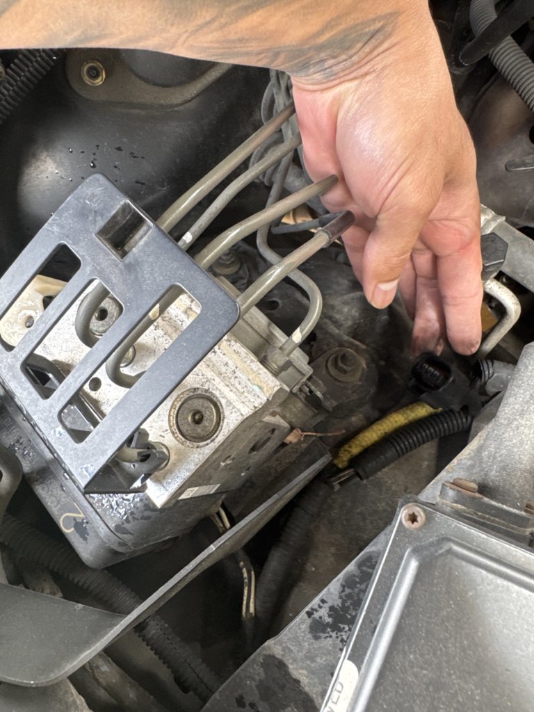

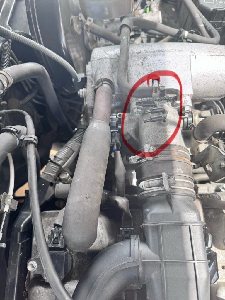

    IMG_5557.jpg need some help tryna figure out if this is normal or part of the problem of my evap leak
    i just bought this truck like 3 weeks ago and i talked about it having some pieces missing
    it drives good just want to make sure if i gotta take it somewhere to fix the 3 small tubes that are just out and the wire connector that’s not connecting to anything and don’t see where the connect it to

    Should have a vacuum diagram on the hood, are u talking about the evap canister, thats something else. U can get issues with evap canister when u over fill your gas tank.

    your right
    just realized that
    thanks i guess it is normal for this model to
    just saw other pics similar to mine who have them connected to something image.jpg

    Those vacuum caps look factory to me, i dont think that there is anything there that they should be hooked up to. The green cap under the brake master cylinder looks like the evap test port, see if that is tight, btw, that is where you smoke test the system. It seems that evap leaks are either a gas cap or a real pain, good luck.

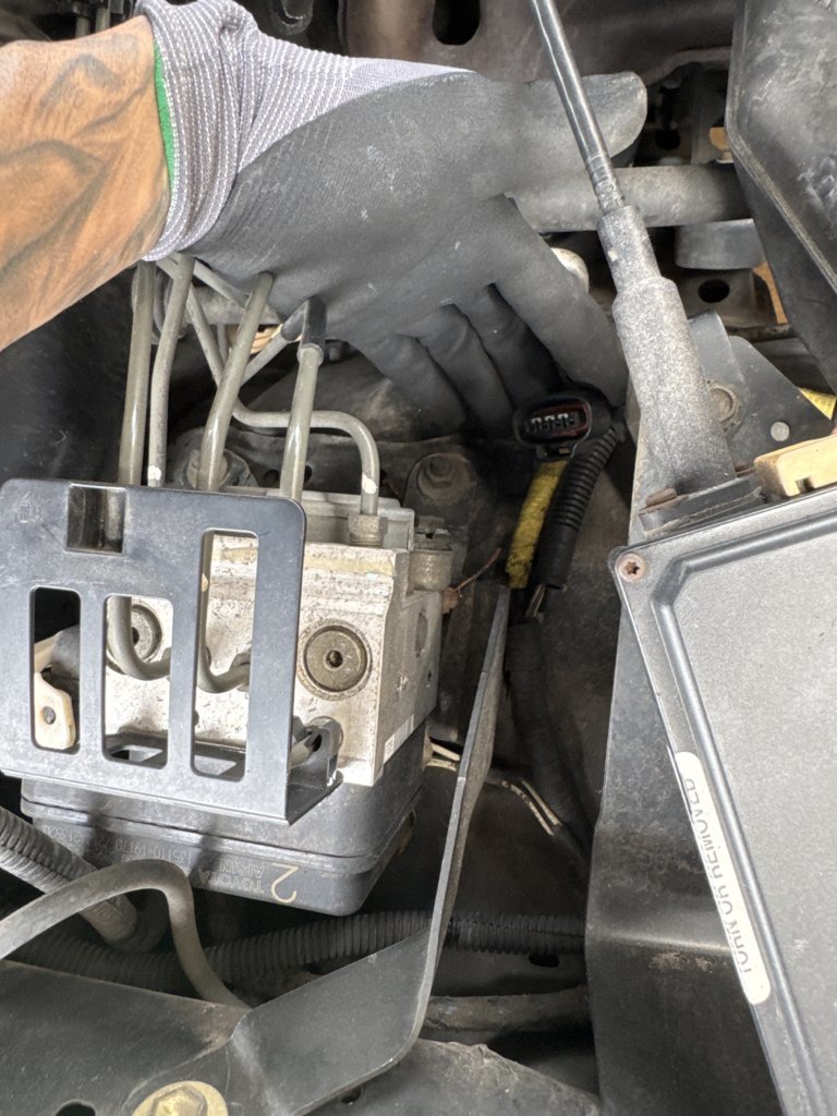

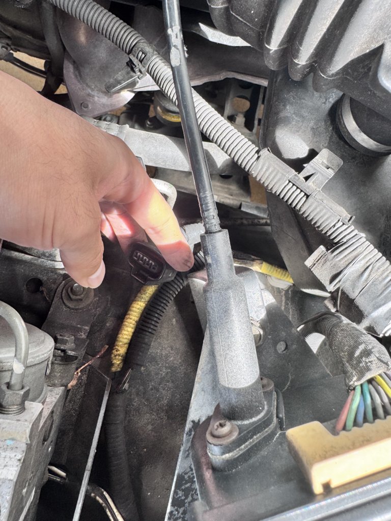

    thank you what about this connector that’s just out?

    On later models they traded the egr system in favor of 2 Cats baby
    those nips would feed egr control modual...on earlier years...
    thats on yours because the TB fits wide range of vehicles worldwide (Hilux)

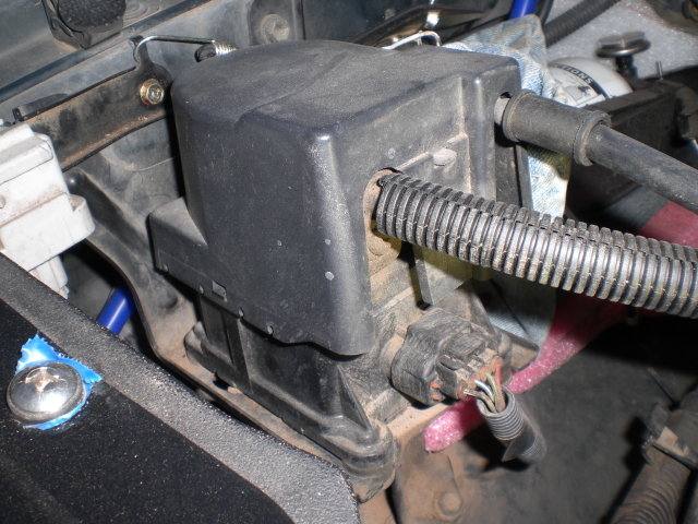

    the other connector is most likely on all the harnesses for cruise control unit
    I'll find you a pic and let you decide

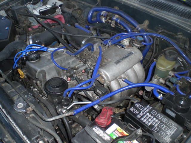

    ControlCar
    ControlCar My Moto: Help & Learn…period.
    Jul 22, 2023
    #429578
    3,101
    Steven
    Sugar Land TX
    1996 Taco 2.4L 2wd Automatic

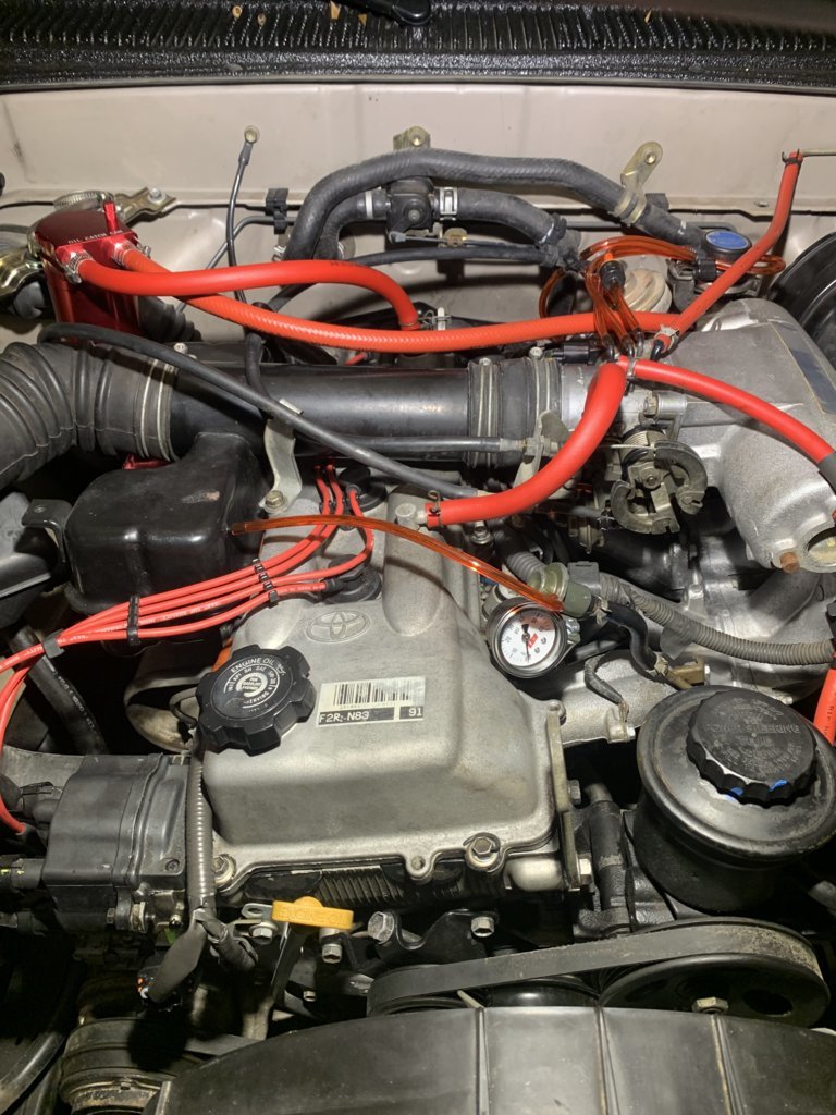

    Clock Volt meter/LSPV Delete/Hyundai 16’s/FP gauge/after 9months of wrenching ZERO oil leaks
    OS and Thatt helped me alot replacing all my 29yr old hoses
    I bought my new hoses from Ace Hardware
    (Multiple different store trips)
    But now I hear complete hose kits available from Amazon
    Not counting gas for trips pretty much a wash price wise
    CARLITOS JR95[OP] likes this.
