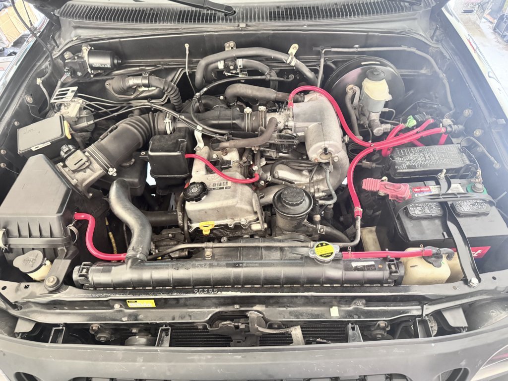

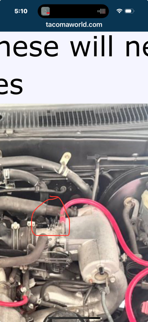

    @ControlCar
    thanks a lot for the help fellas
    replaced all the vacuum hoses first from what the diagram says
    and will start the other hose next but i’m sure some of these will need different style hoses
