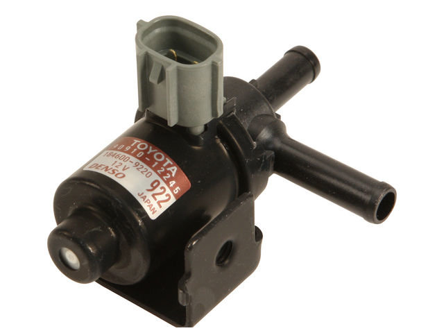

    So my evap system has a small leak so the first thing I checked was the vacuum lines, which looked ok, so then I checked the valves and I wasn't sure what the normal state of the evap obd canister closed valve is. I would assume closed because it is in the name but when I disconnected the hoses I could blow through it which means it is open. This part is around $80 so I just want to make sure that it is supposed to be closed or not before I buy the replacement.
    I attached a picture of the part that I am referring to.

    Answer: It is supposed to be open when the car is off

    My check engine light was on and the diagnosis was a small leak in the EVap system. I removed the valve and hooked it up to a power source to close it and when I blew in it a small amount of air was going through. This valve is the test valve so when it is testing to see it there are any leaks it closes and since there was a small leak it turned on the check engine light.
