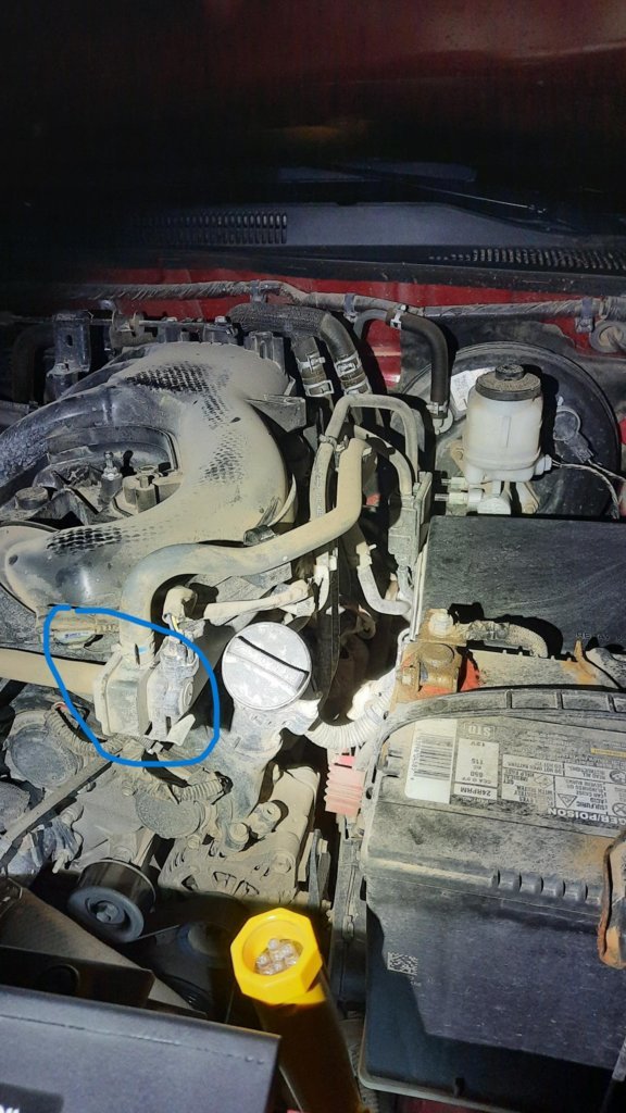

    Can you take a picture of the front of the engine, driver's side. Looking for the purge valve state.

    Is this the Purge valve??

    Charcoal filter is still there but I think it has been bypassed. This is not an emissions inspection. it is failing because they say the emissions equipment was "Tampered with".
    It is not failing due to the code, but due to the fact that the inspector can see the taped up monstrosity that is hanging under the hood.
    Wonder if I clear the codes, cover the hole and drive 100 miles if it would pass?

    No. Mode 6 monitor will not be ready and will fail you.
