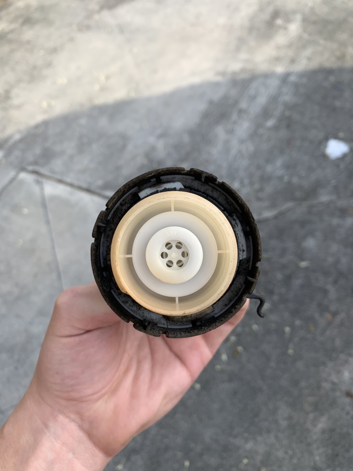

    I inspected the gas cap and the gasket is worn but otherwise in decent condition (photo attached).

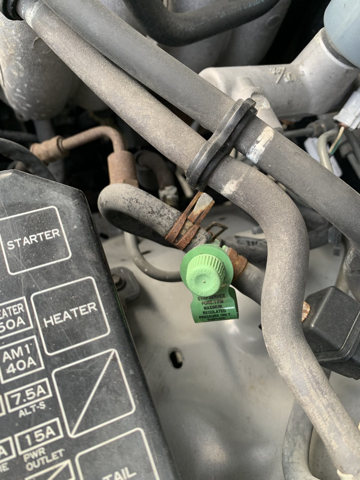

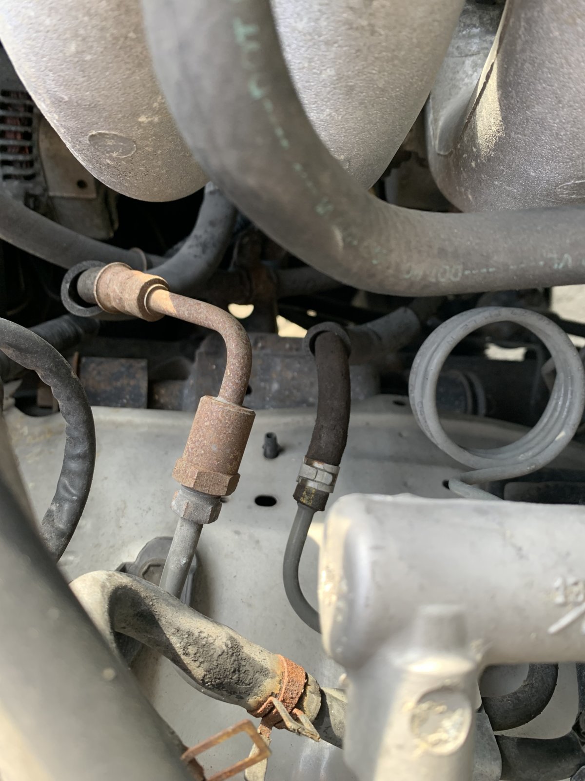

    I noticed that the hose connected directly to the service port, as well as another hose that comes from that general area and connects to the engine are deteriorated (photos of both attached).
