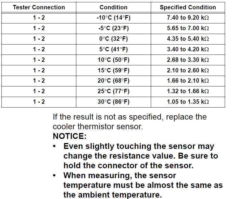

    Looking for the spec for the evap temp sensor for my 2007 tacoma.
    Also can i use a scan tool to test it?

    I don't think a can tool can be used, here are the values:
