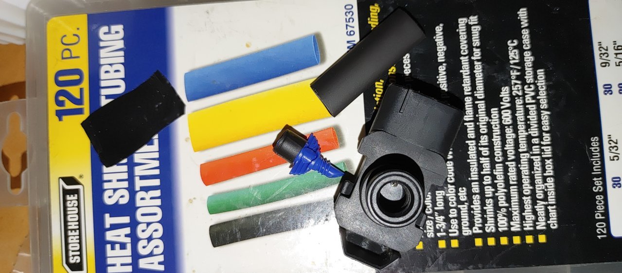

    i had a P0450 with my 2001 tacoma v6 prerunner. it wasnt the gas cap so it was the Pressure Vapor Sensor.
    i ordered a used one from fleabay with part no. 89461-33020 i didnt notice it was the wrong one til i got the part.
    but what arrived instead was a 89461-48020 for most (2003-2020) newer vehicles. since i already have it, i decided to roll with it and test to see if it works.

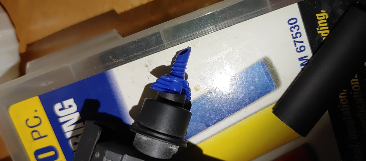

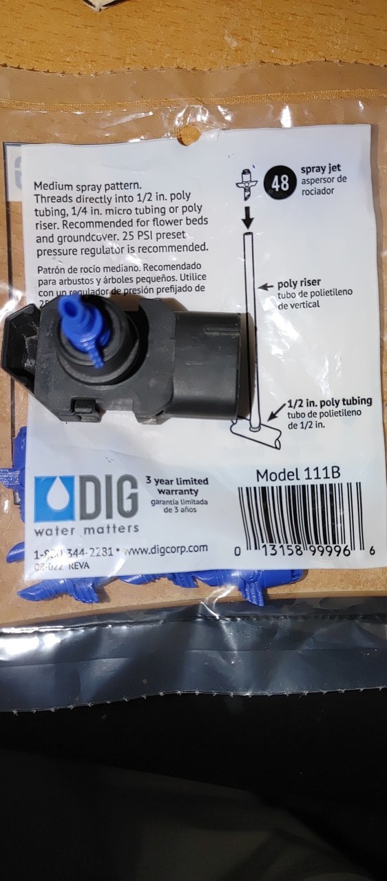

    i made it work by going to HD. i looked for a piece that can fit the bigger opening and adapt it to the 1/8 vacuum hose.

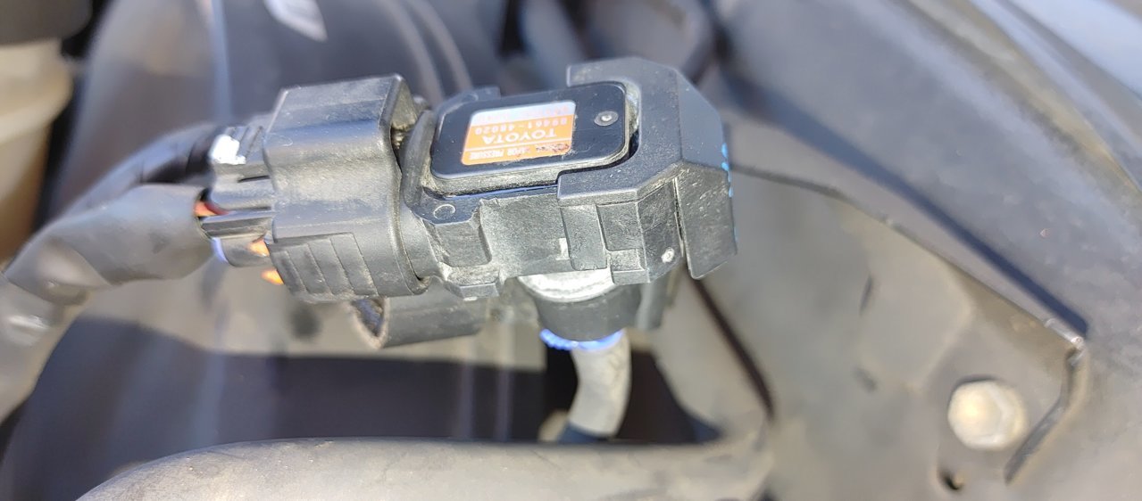

    i found a drip irrigation piece (DIG model 111B) that fits great. added a shrink tubing to seal it well. stuck it in and tested it. 2 days now and no CEL.
    the piece should be RTV'd to seal better. but i have it installed with no RTV at the moment and no problem. will update if any new info.
    have a few pics to show below.
