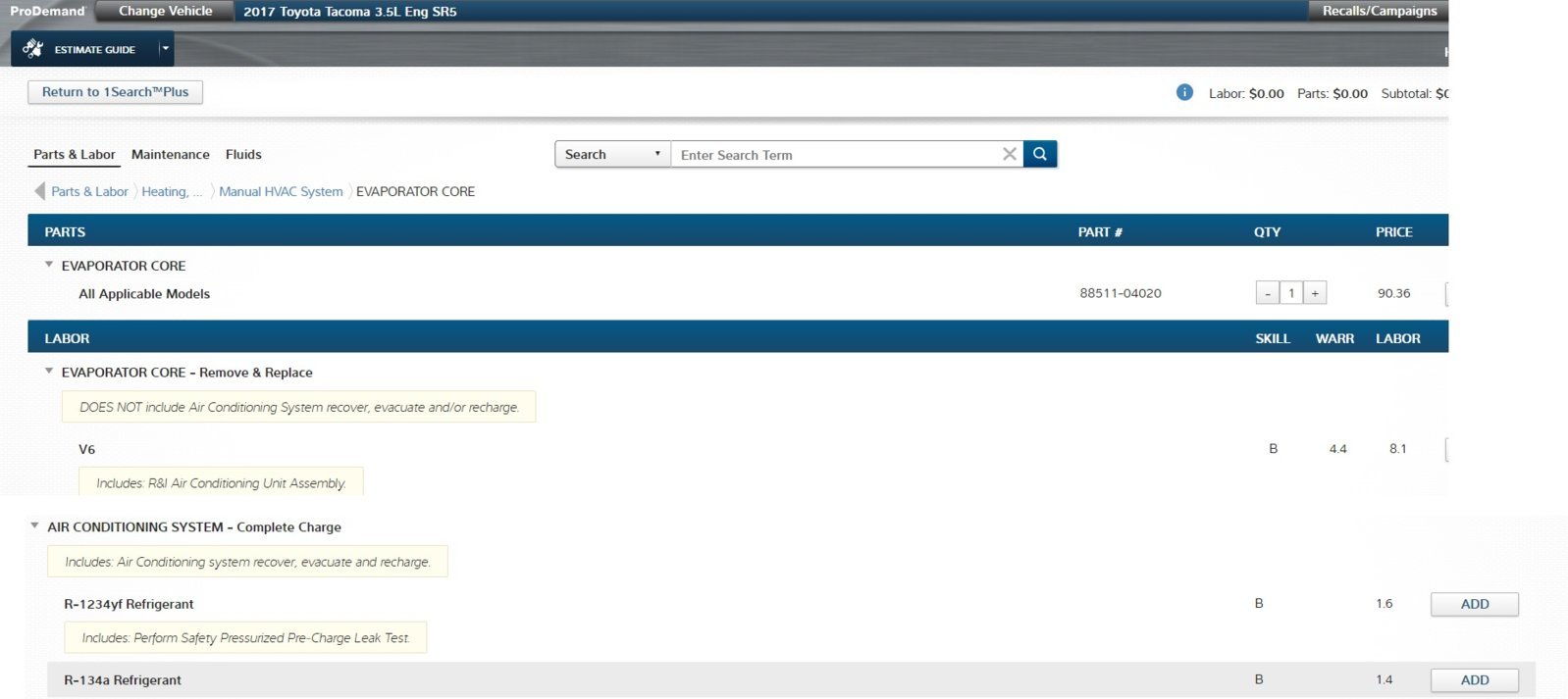

    That sounds about on par for an evaporator replacement depending on labor rates in your area, it pays 8.1 hrs for the evaporator R&R because the dash has to come out plus 1.6 hrs for evac and recharge.
    It seems evaporator leaks are pretty common on newer vehicles, I've done quite a few in the past few years although I've yet to do one on a Tacoma.
    Pretty common to smell the refrigerant oil inside when the evaporator is leaking, usually you can also see dye coming out of the A/C drain as well (the dye glows bright green under UV light).
    It can be a daunting task for some people, I enjoy doing them on most vehicles.
    Being it's a 1234yf system it's pretty cost prohibitive to keep adding refrigerant to it as 1234yf costs around $5-8/oz.
    Never put stop leak in an A/C system, it typically won't stop a leak but it will wreck the system if any moisture or air ever enters the system.
