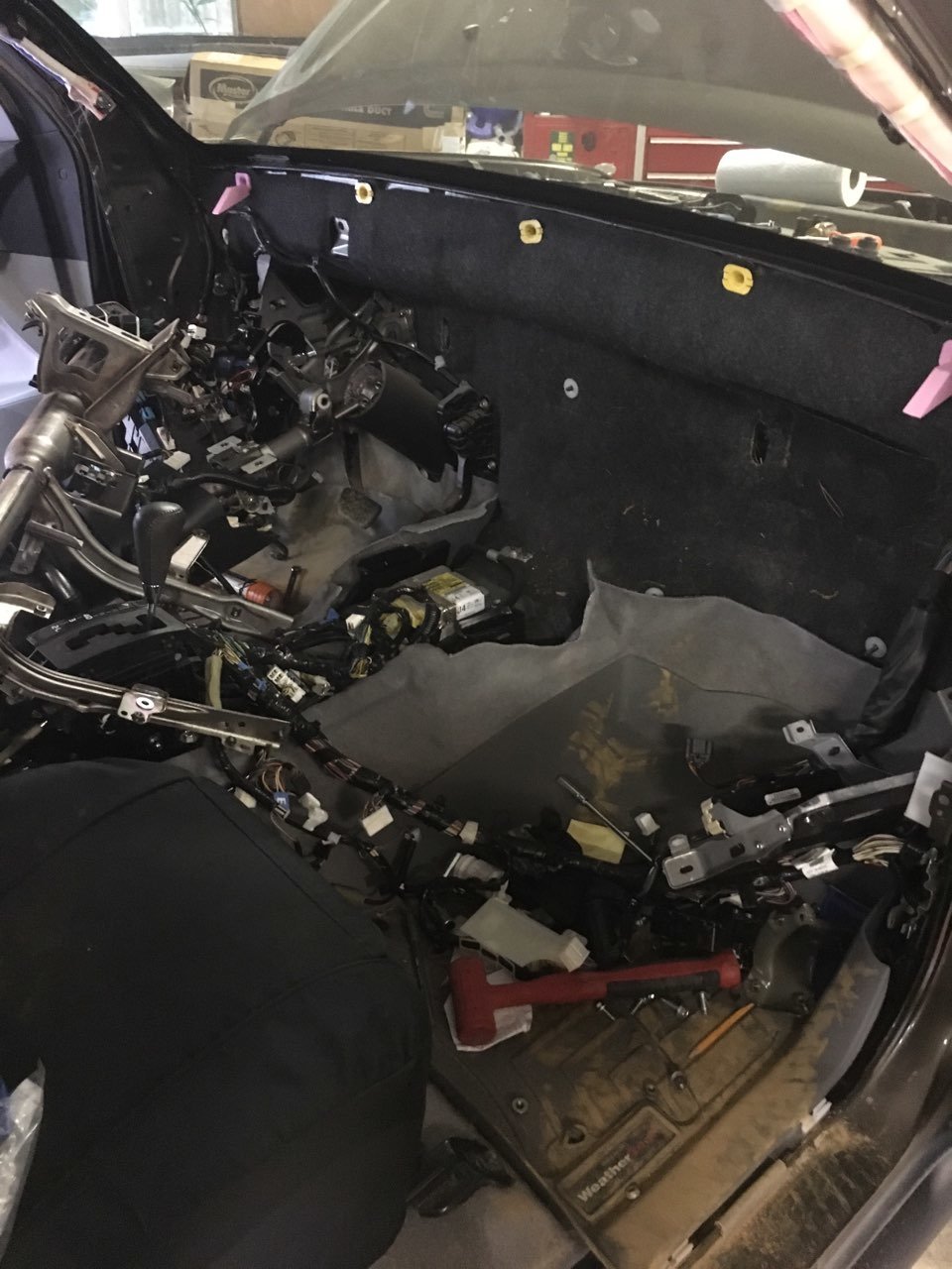

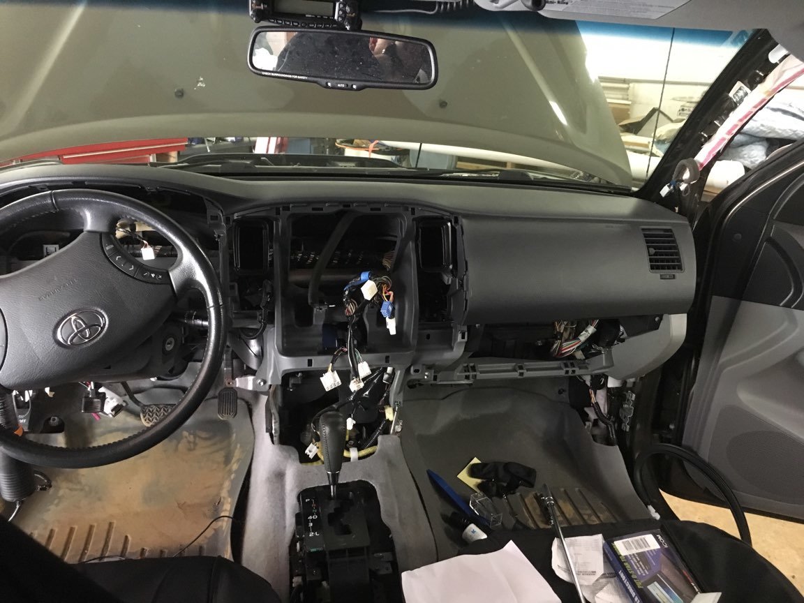

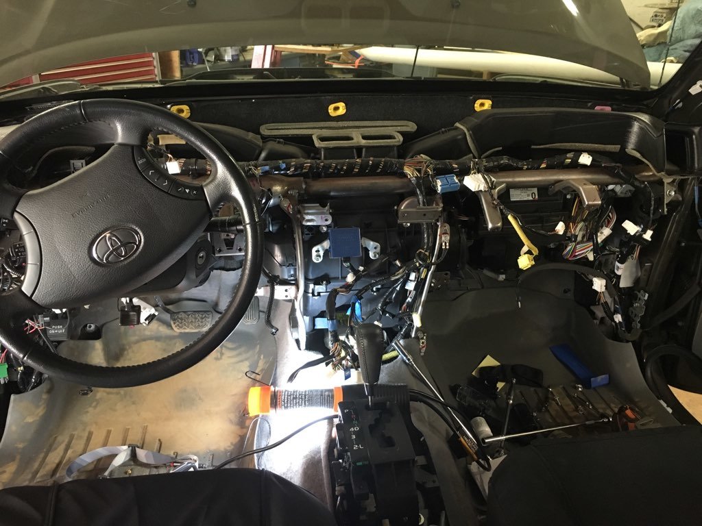

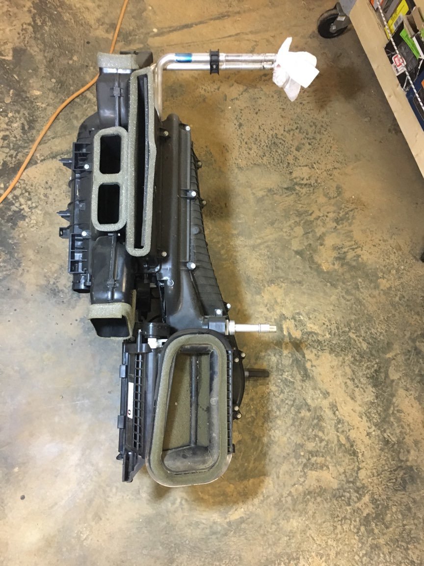

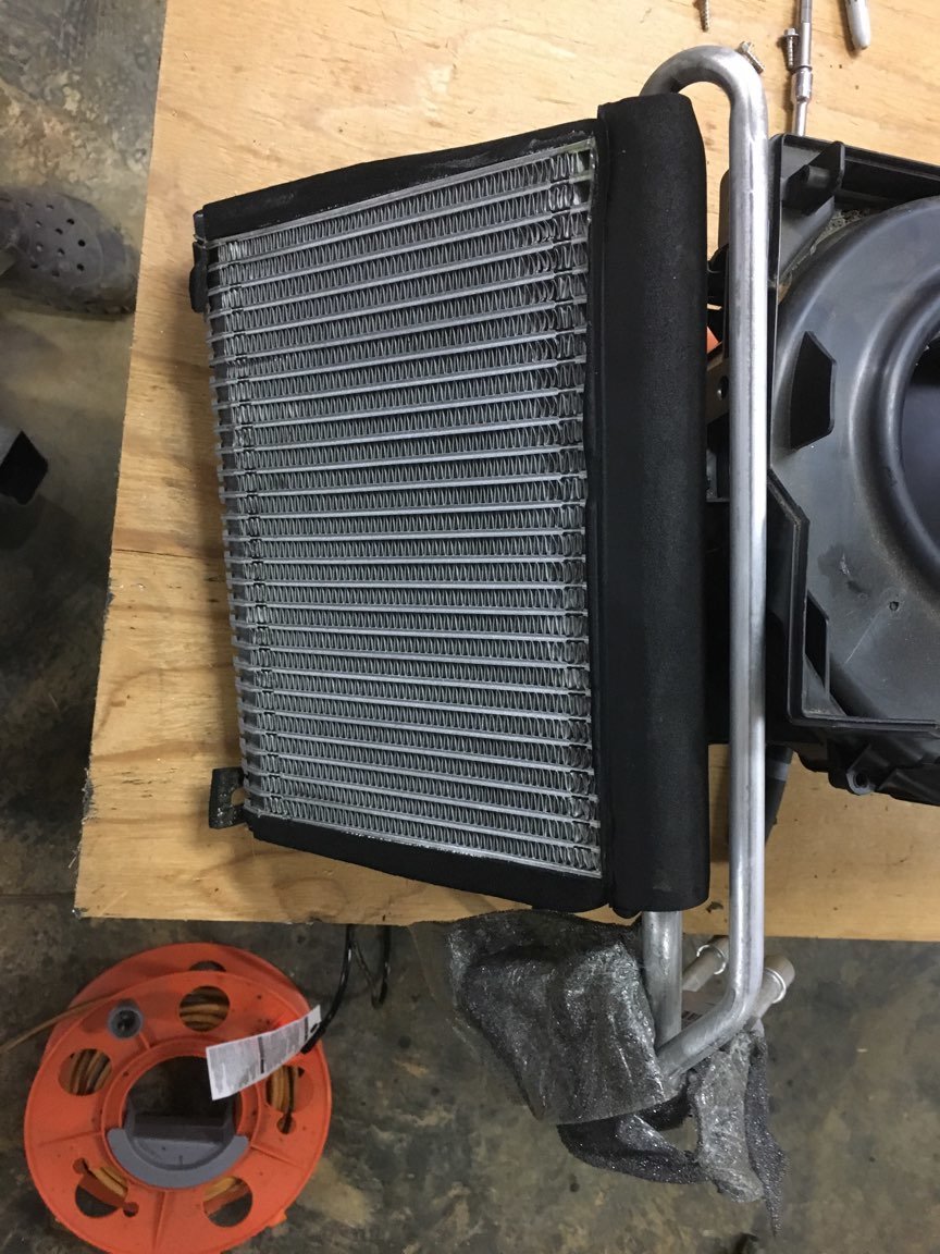

    Well, I finally had some time to put the evaporator core in. I started it yesterday around 2:30pm and got it wrapped up around 1:30 am. That included stopping for phone calls and eating supper. It really wasn't as bad as I was anticipating, but the most challenging part was getting the crash bar out.
    I decided to install a new heater core while I was in there just because I didn't want to run the chance of having it crap out on me after I just had it apart. I still need to get it recharged, but I consider my part to be finished.
    Thank you to everyone that helped and provided information.

    Hope you locked the steering or marked it, I usually wrap it with shipping tape to keep it from turning when I remove it

    The wheel was locked, I never disconnected the shaft. I just removed the nuts and lowered the shaft out of the way.
