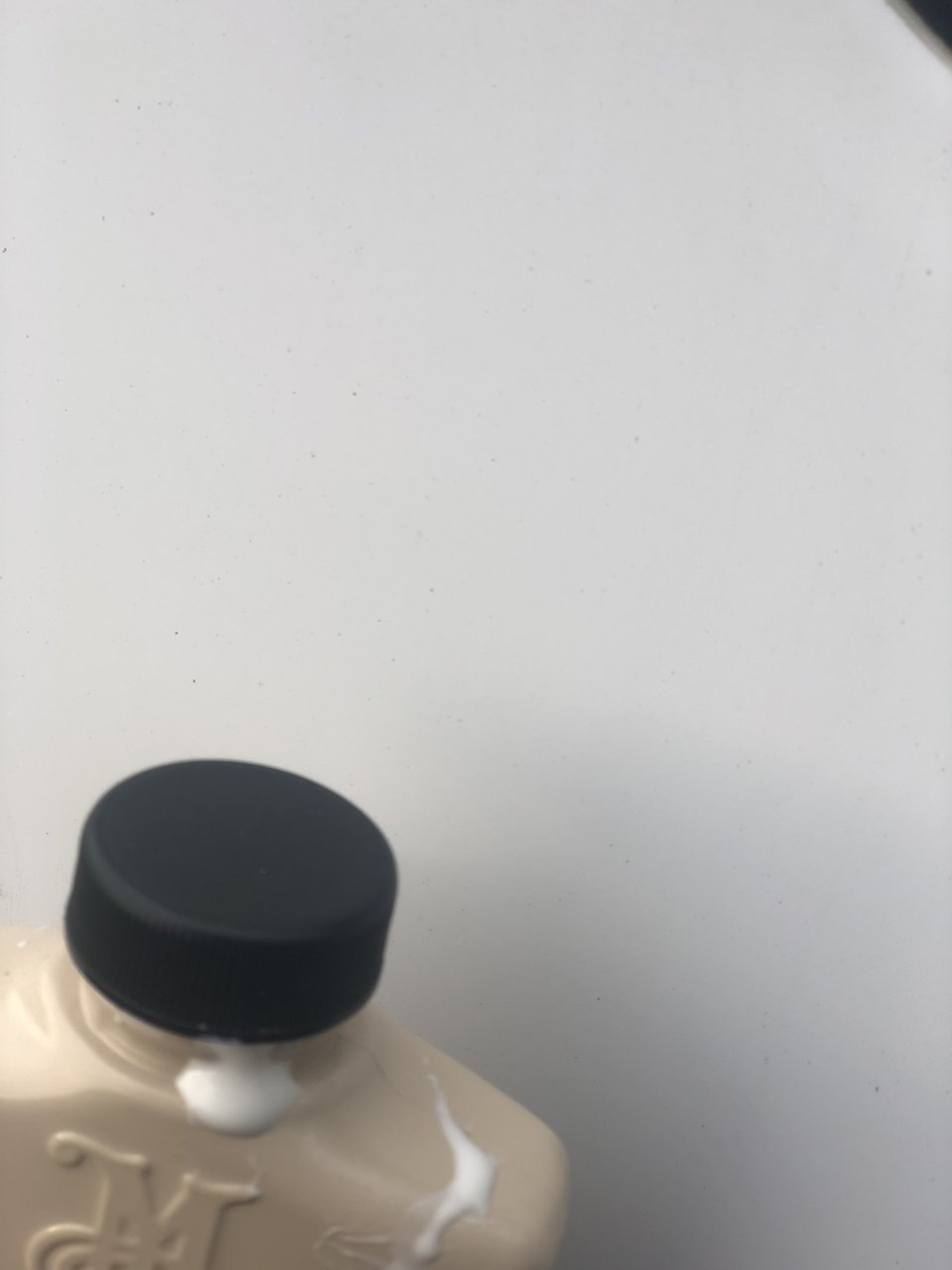

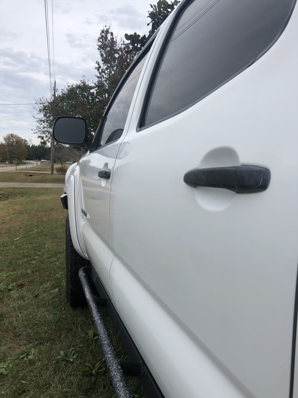

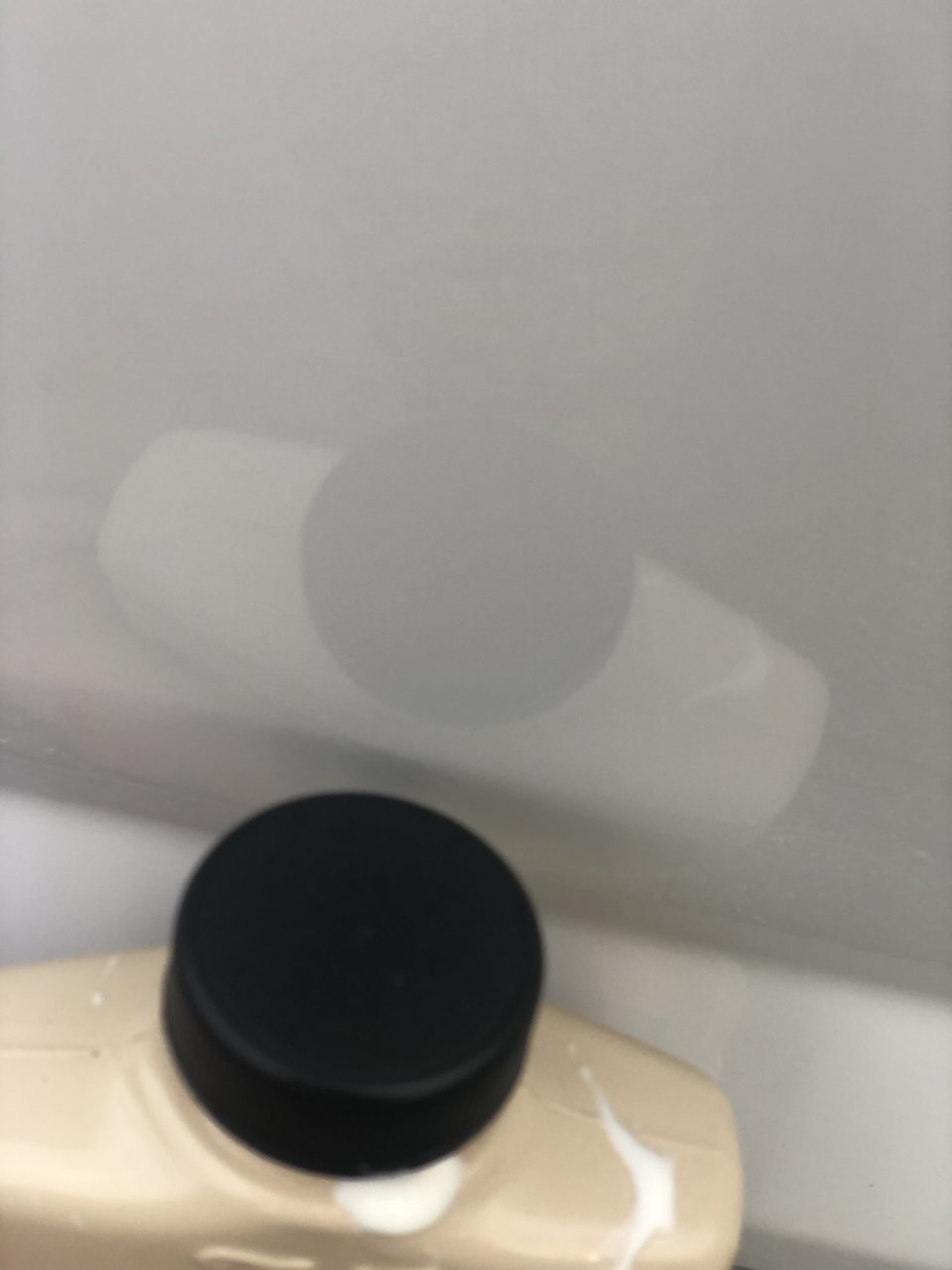

    I can relate.
    before:
    After:
    Side:
    Single stage paint. Thanks Toyota! It can be fixed if chalking and dull. As far as the sun fading around the vinyl probably not but worth a try. Never know though, might get lucky. I’d do it myself with compound, polish and a wax rather than take it somewhere that will cost you a pretty penny.

    I did forget I polished my truck. It definitely helped. But mine was already still fairly glossy. Ceramic coatings can sort of help.
    I love toyota single stage paints.....
    Not
