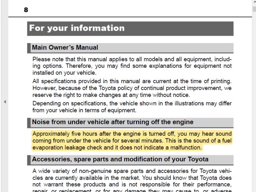

    Thanks for the replies. When this happens, how long is a reasonable amount of time for the sound to continue? 5 minutes? 30 minutes? Hours? It just seems odd that I heard it about 5 hours after shutting the truck off from about a 20 minute drive. I don't know whether it just started right before I heard it or was going on for the entire 5 hours (and the battery drain thereof).
    edit: Ah, found it in the 700 page owner's manual:
    "Approximately five hours after the engine is turned off, you may hear sound
    coming from under the vehicle for several minutes. This is the sound of a fuel
    evaporation leakage check and it does not indicate a malfunction."
    The key was knowing to search for the word 'evaporation' so thanks for that.
