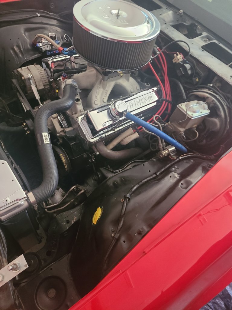

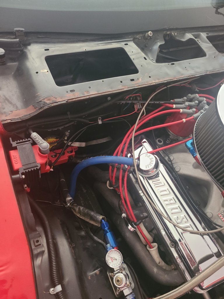

    I'm running a Moroso Pan evac set up !! , the blue hose attaches to the valve cover breather and to the header collector were a diverter valve is inserted into the header collector

    I'm running a Moroso Pan Evac system were a hose from each valve cover breather to a diverter valve welded into each header collector . A pan evac allows a tighter ring seal in ea cyl
