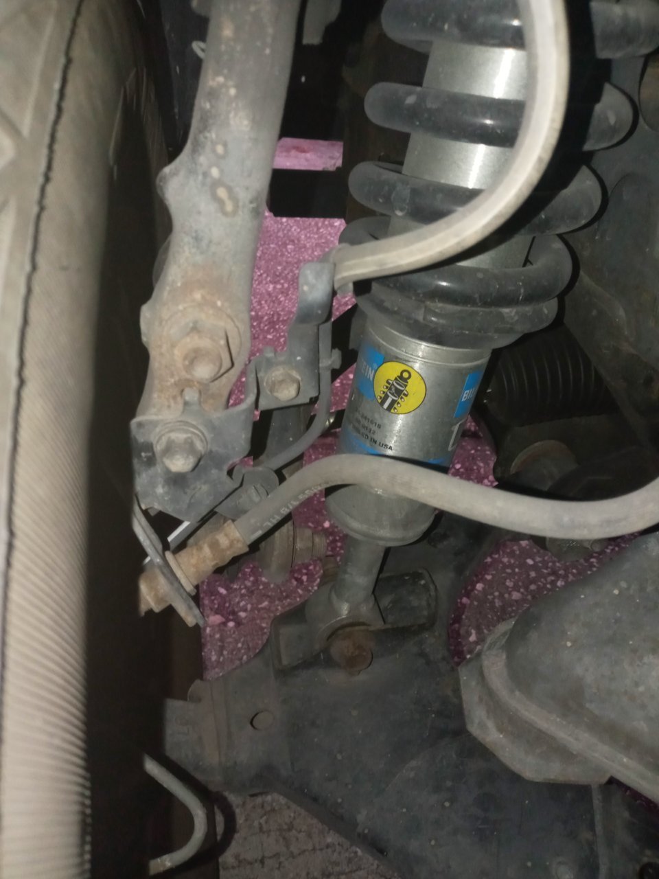

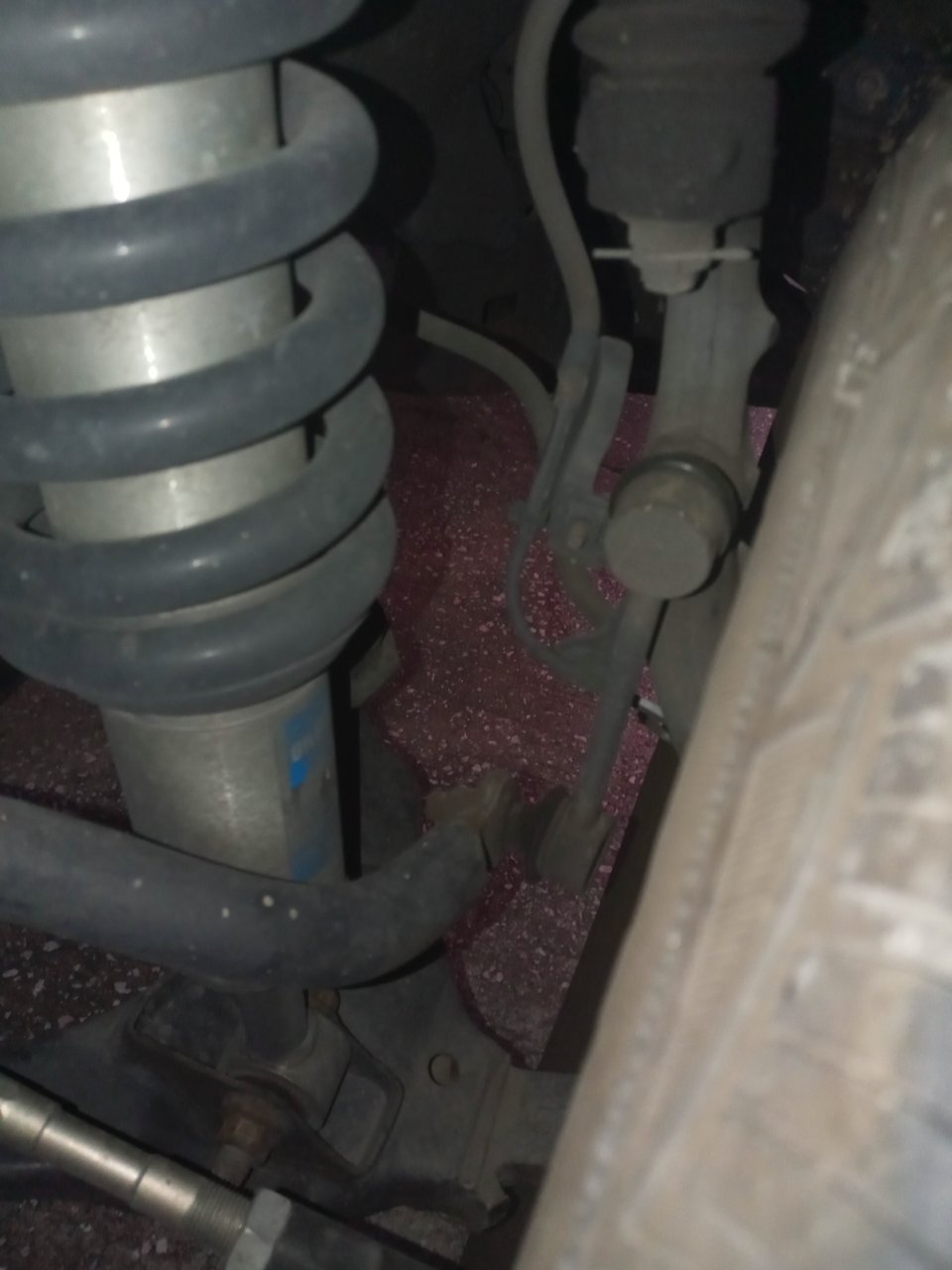

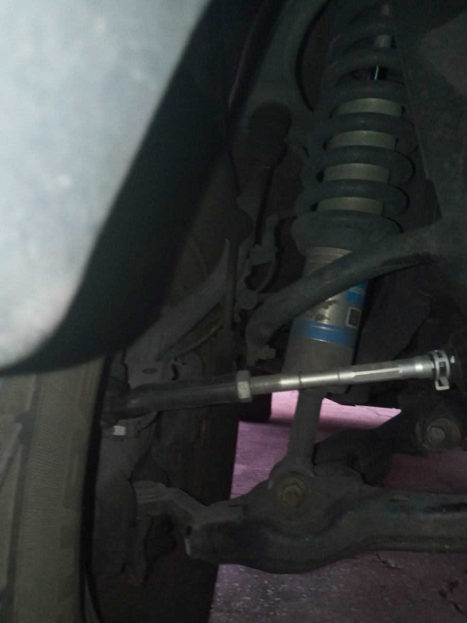

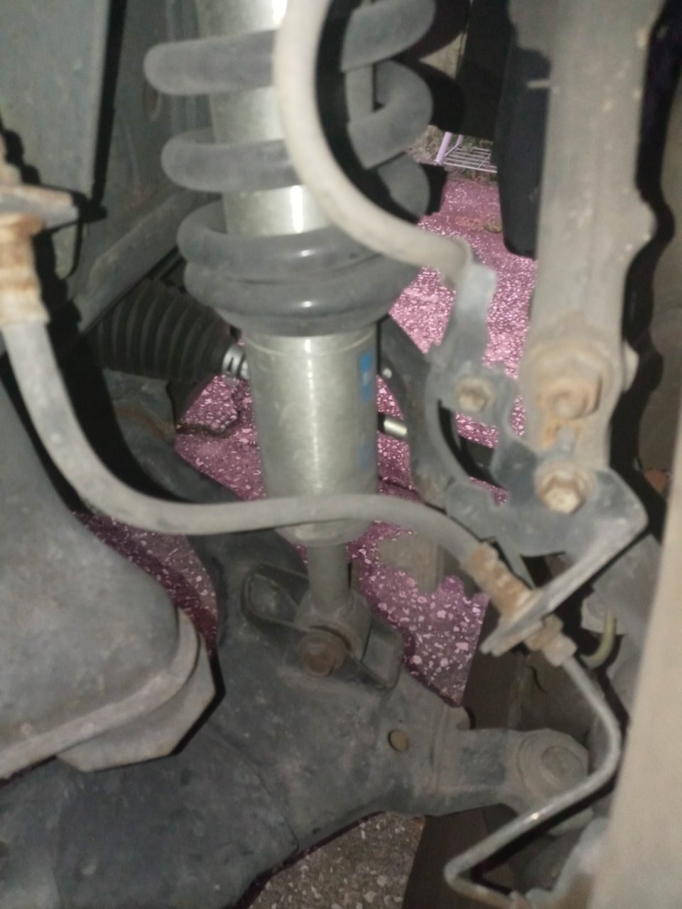

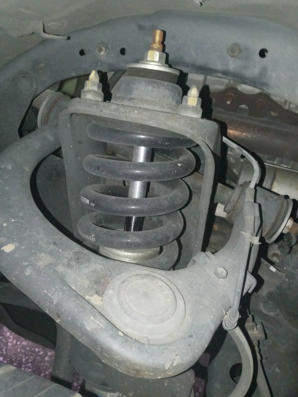

    Here are some pictures
    davidstacoma and 604 like this.

    Do a little troubleshooting / mod day meet up! Extra input in person is always a huge plus. Also, someone may be able to spot something by jiggling the undercarriage around while someone else watches the ends of that component for excessive play.
