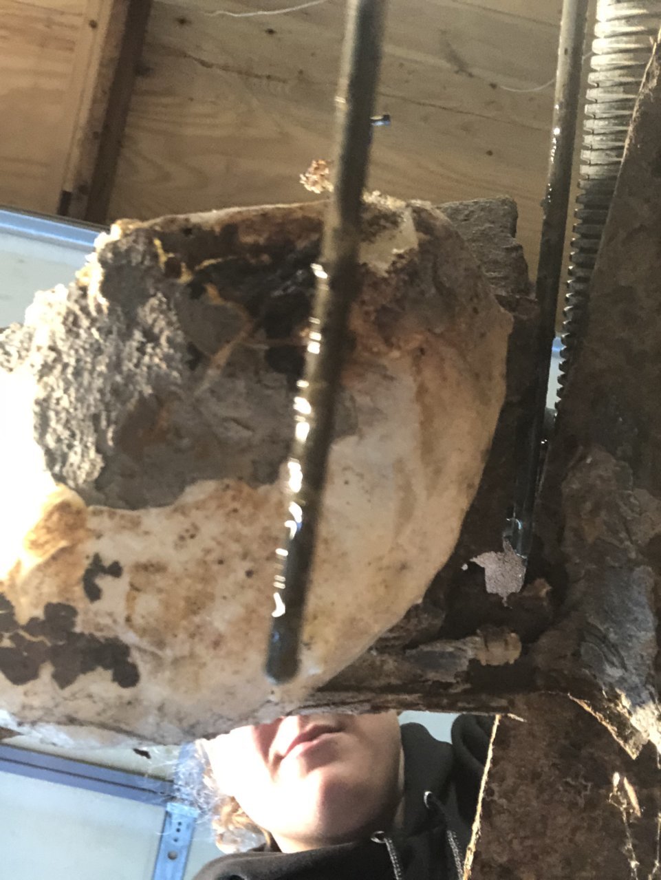

    So this is my first restore type project ever. Here's basically what I'm starting with! On the list of TO DO is replace/rebuild the frame. Prio # 1!!! Once we get that, gonna work on repairing the more minor rust bits, then more to cosmetic things like repairing the bed-side dmg and making it pretty again! Super excited!
    I am curious tho, are there any cross reference part #s for body panels from say 4 Runners or such that could work and might be cheaper/more easily available?

    Looks like someone has already patch the frame numerous times. You have a really big (and costly) decision to make about that. Replace it...probably $4-5000 if you can find one. Plus your gonna break many, many parts in the process. You'll want brake lines, fuel lines, probably the tank and straps,... This gets discussed pretty regular here on TW, and the dealers seem to be charging $10-15,000 for a frame swap.
    Or, you can clean it up, patch it anywhere where it's weak, still replace many of the parts I mentioned, and assume it will last 5 years or so, depending on how you plan to use the truck. I've patch (multiple spots) two of the three 1995s in my family and they are still on the road. However, we don't go off-road and really stress those frames either. Just mild off-road mud and Winter snow/ice. I doubt they would survive a strong flex without cracking somewhere.
    I just make my own patches, but a lot of people have said good things about these:
    https://www.autorust.com/product-category/toyota/tacoma-xtracab-4wd/

    We have access to a sheet cutter so if we can get a decent CAD file with the precise measurements and angles, we're basically going to rebuild the frame from scratch with our own pieces. The plus side of having several metal workers in your sig other's family (including your sig other xD)
    The tank isn't in *terrible* condition, mostly want to clean it up. The brake lines and fuel lines for sure need to be replaced but they aren't too terribly expensive.

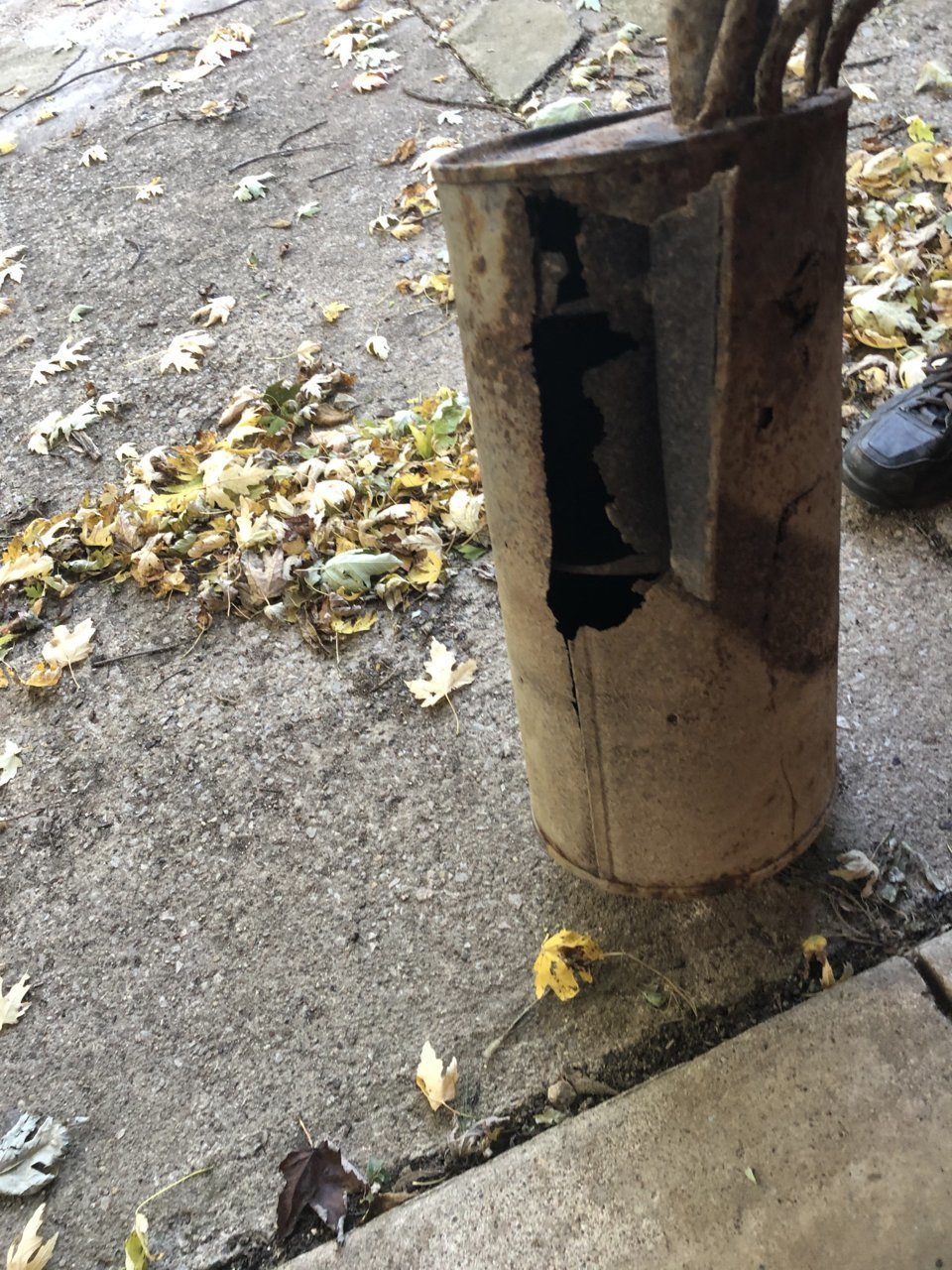

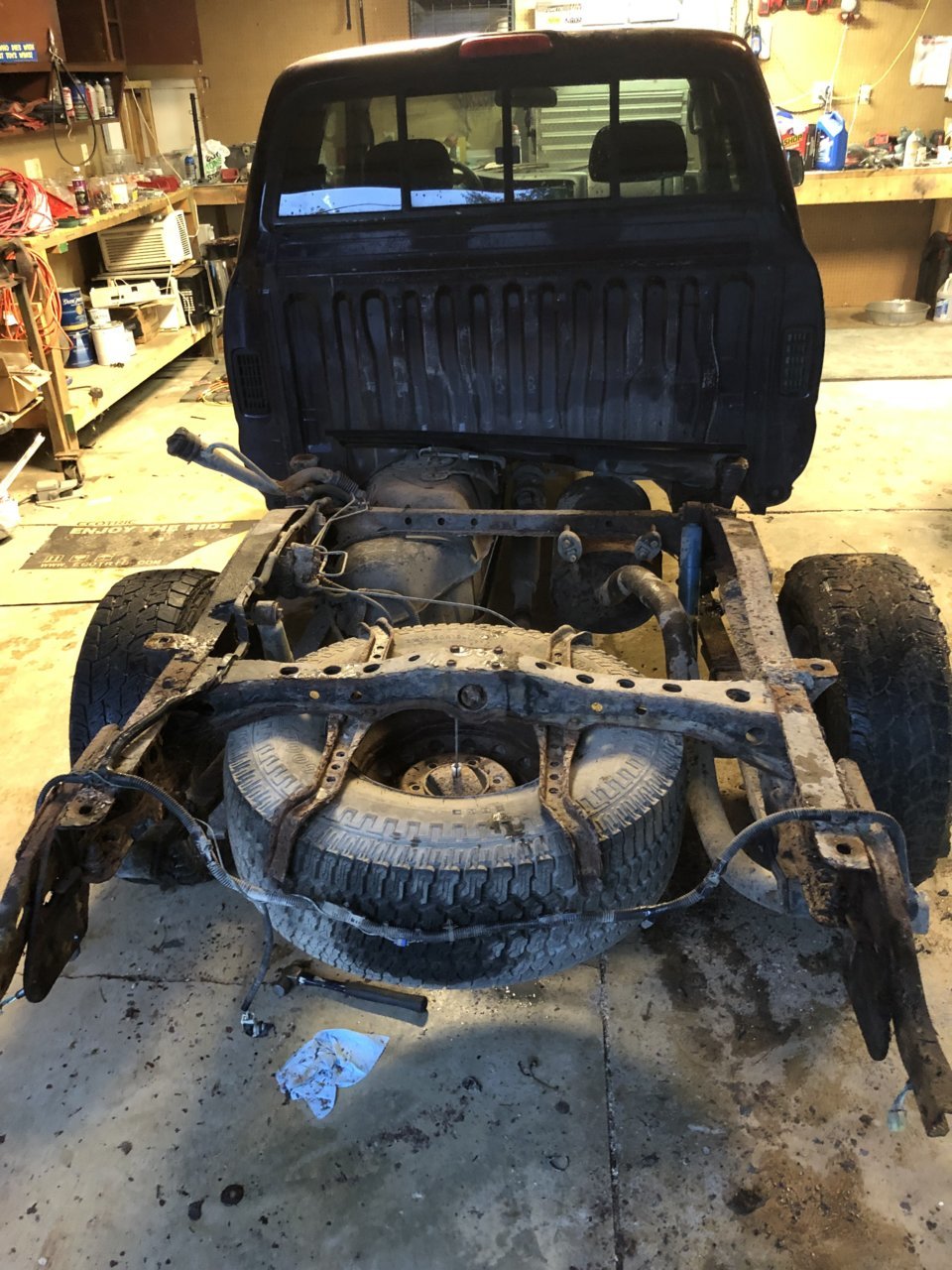

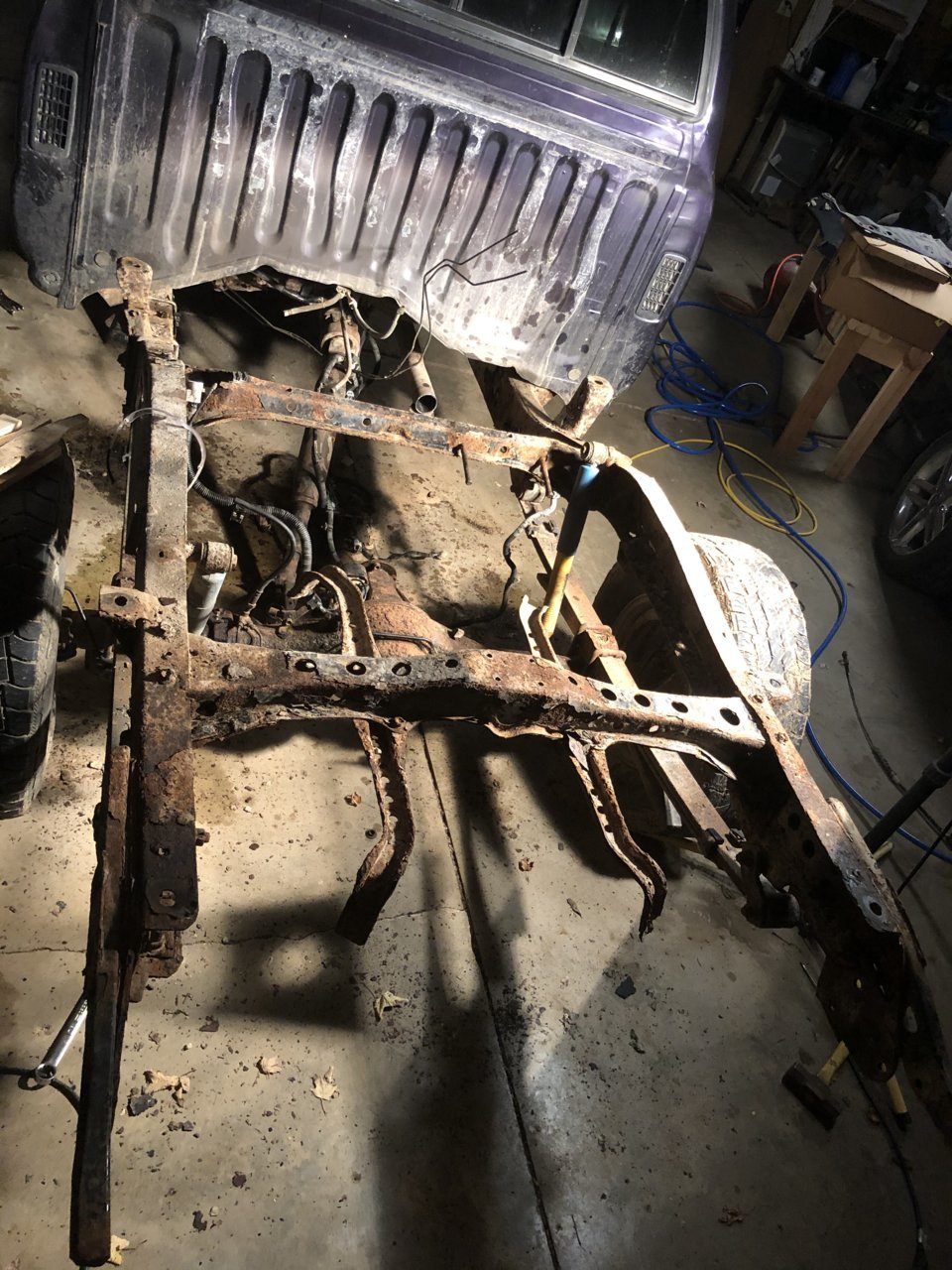

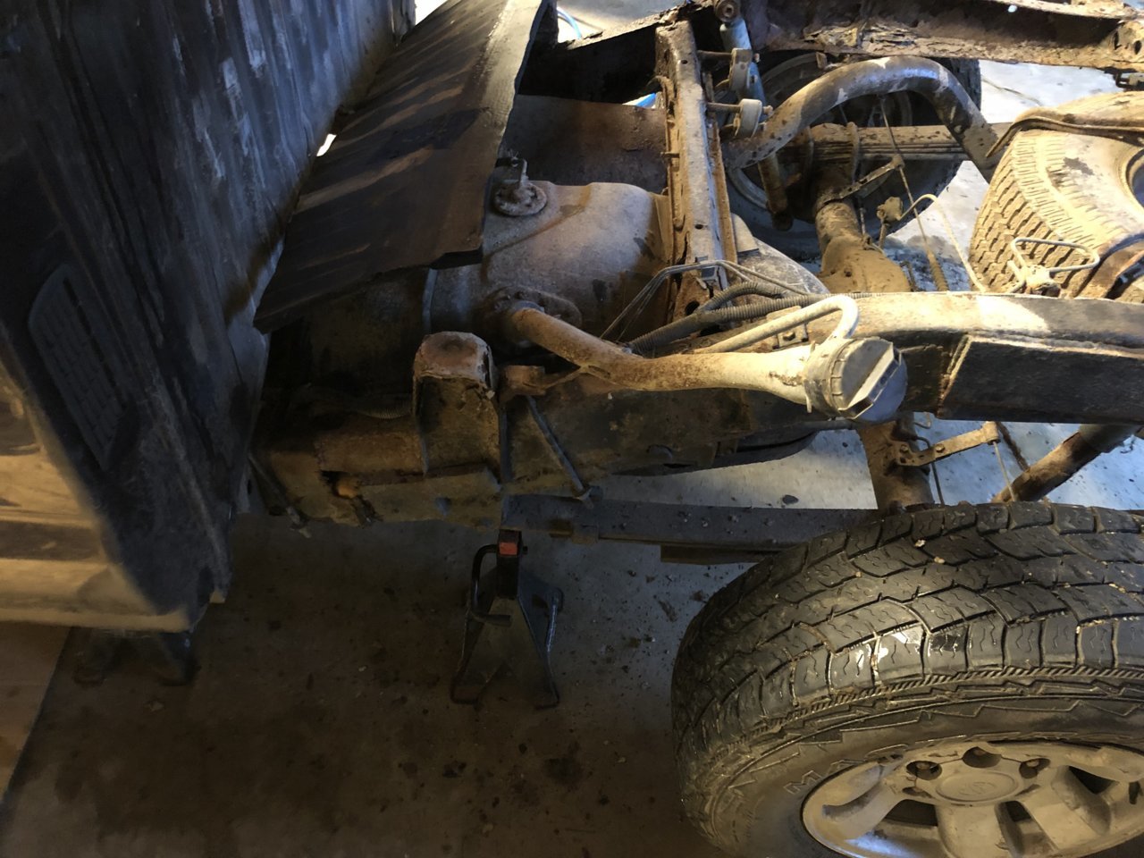

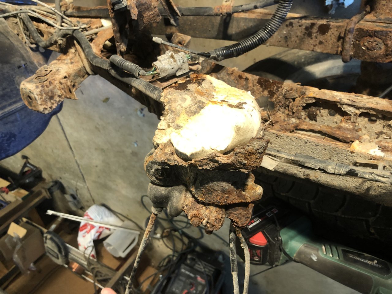

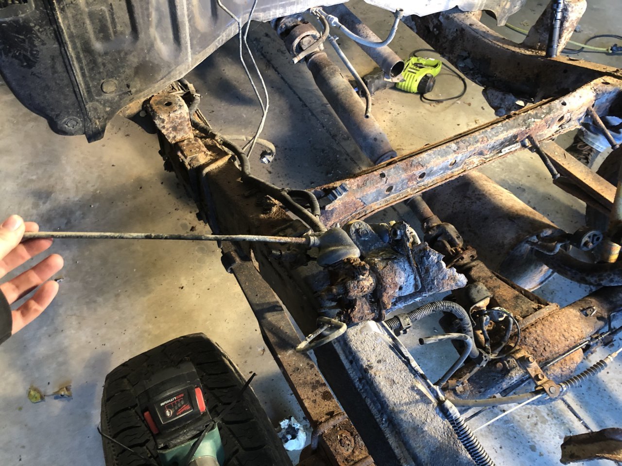

    So progress bump! Working on getting the frame cut/removed. Got the brake lines removed, spare tire, gas tank, muffler, and other tid bits! (Just a TINY exhaust leak and yeah, expanding foam fixes EVERYTHING!!!) =)
