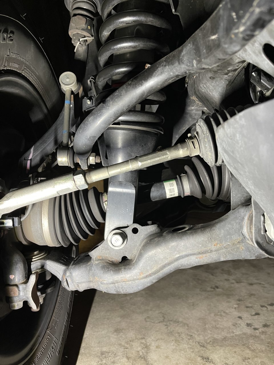

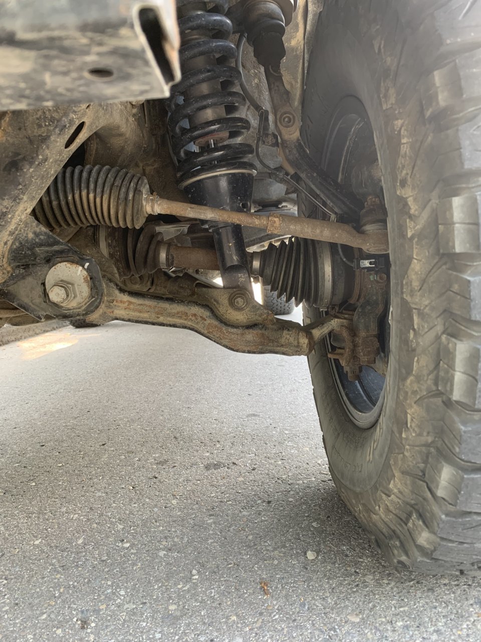

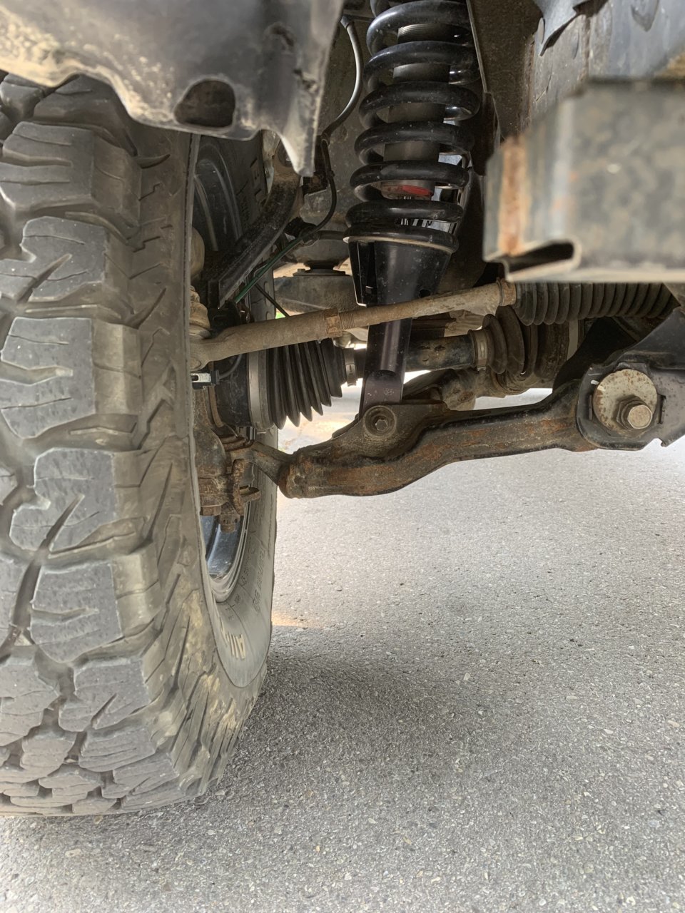

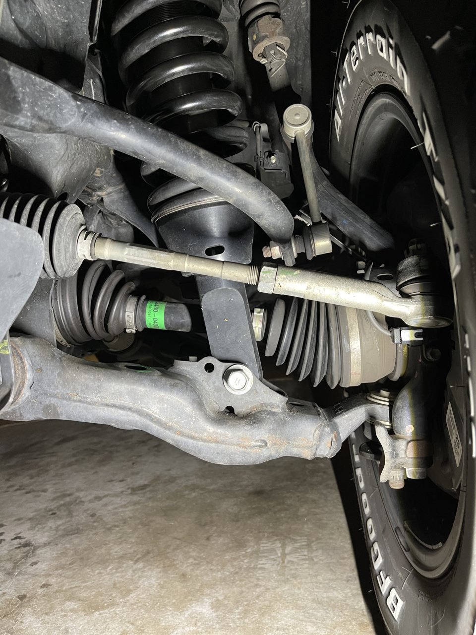

  11. Jul 23, 2021 at 2:48 PM
    #231
    idriveabox
    idriveabox Well-Known Member
    Dec 6, 2020
    #348807
    86
    Calgary, AB
    2015 BRM SR5
    I’m right at 23” passenger and about 23 1/4” driver, hub to fender.

  12. Jul 23, 2021 at 5:10 PM
    #232
    Jays19TRD
    Jays19TRD Well-Known Member
    Mar 17, 2021
    #359642
    72
    Just to comparison. My drive is right at 23 1/2 and passenger is 23 3/8. Also running swaybar without clearance issues.
    idriveabox, dpele and TacoPandaTRD like this.
  13. Jul 23, 2021 at 5:43 PM
    #233
    idriveabox
    Dec 6, 2020
    #348807
    86
    Calgary, AB
    2015 BRM SR5
    These angles look reasonable to me. Maybe others can chime in.

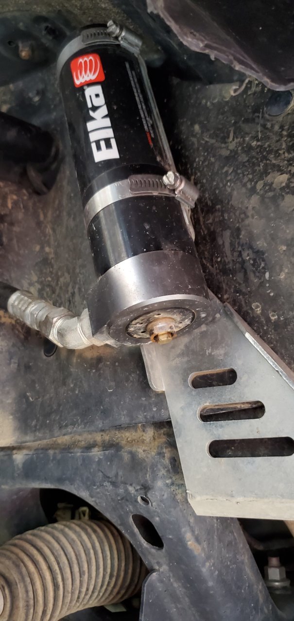

    Well crap, look what I discovered yesterday
    Hopefully it's just something they can send vs. having to pull the coilover and resi 20210806_183705.jpg
  17. Aug 7, 2021 at 10:41 AM
    #237
    TacoPandaTRD
    TacoPandaTRD Well-Known Member
    Jul 24, 2020
    #335442
    395
    TacoPandaTRD
    Chilliwack, British Columbia, Canada
    2020 Toyota Tacoma TRD Off-Road
    Always looking to modify! Check out my Instagram @TacoPandaTRD
    I think it’s just a 2mm or 2.5mm Allen bolt that holds the knobs on. Shouldn’t have to remove anything

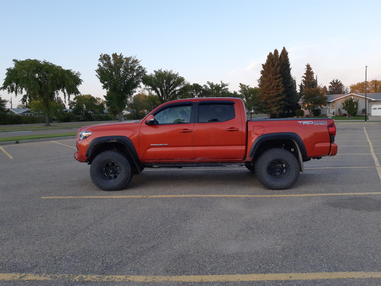

    Hey all, I've been following this thread for awhile now. Had Elka 2.0 2-3" coilovers installed at KRave 2 months ago. I have the popping/knocking on both the driver side and passenger side up front when the tires drop off into a hole at slow speed.
    I'm running SPC UCA'S, ECGS bushing, 650# 14" springs, 2 3/4" lift up front, diff drop, 33's, no sway bar, and Elka rear shocks with dakar heavies in the rear. I have full steel skids, steel rock rails, stock front and rear bumpers, no winch. Front coilovers make this pop/knock both unloaded and fully loaded with camping gear (4914 lbs unloaded, 5951 lbs loaded).
    I have no idea what this popping/knocking is. It sounds like there might be some bump stop limiter inside the front Elka coilover or something that is making contact under full droop. CV angles look ok to me. All bolts/nuts and components torqued and checked by both myself and KRave. Photos are how the truck sits when loaded.
    Will update if I figure out anything.
