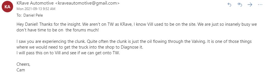

    Lol, "Just oil flowing through the valves" That's a perfectly normal clunk, don't worry about it. Actually clunking is a sign of high quality suspension.
    Weird how "just oil flowing through the valves" didn't make a clunk when they are new.. hmmm
    Blowin smoke.

    Just got off the phone with Elka. From what they told me, the clunk noise is "normal and it's the way the shock works". This does not make sense to me. Elka told me to contact KRave. It feels like I'm being given the run-around...

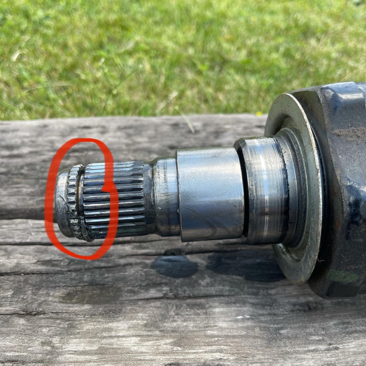

    I’m running a similar setup. I didn’t have the clunk when I first installed my suspension. Few weeks later the noise started occurring regularly and I couldn’t find the source. I checked all nuts, bolts, and fasteners. Took my truck in to a shop because my CV shaft going into my diff was leaking at the seal. That was a month ago and to this day I don’t have any clunking or weird noises.
    I honestly think the noise comes from the CV axle clip slipping/shifting within the diff. By adding the lift we are lengthening the axles and putting the shaft at an increased angle going into the diff which causes the clip to move. My buddy’s 4Runner with 3” Dobinson suspension does the same thing. He can’t pinpoint the source of the noise after going over everything to make sure it’s all tight

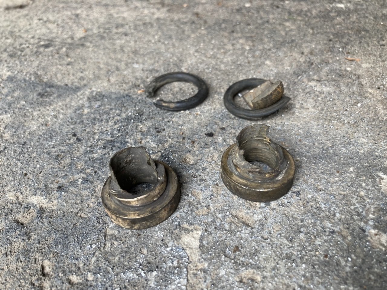

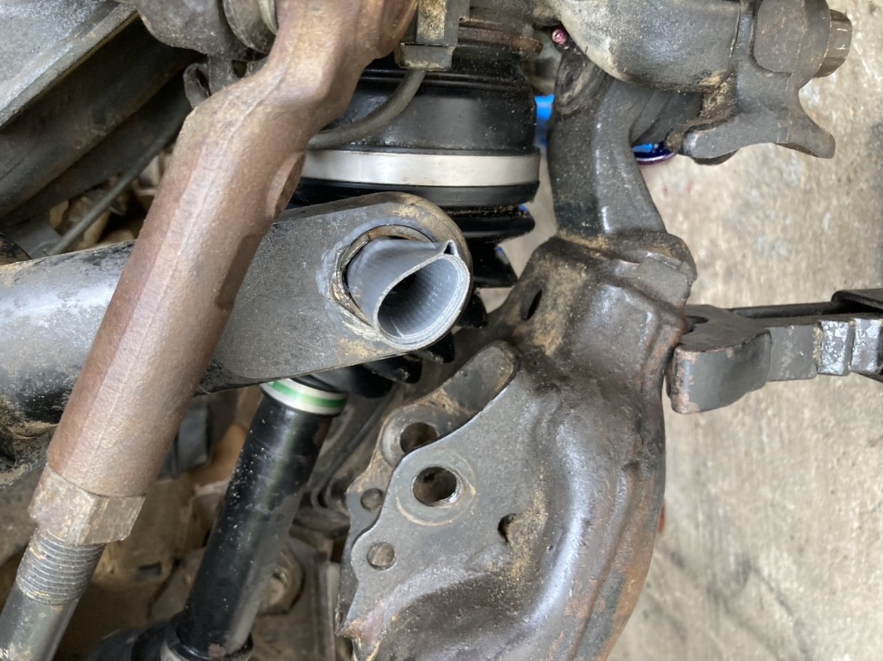

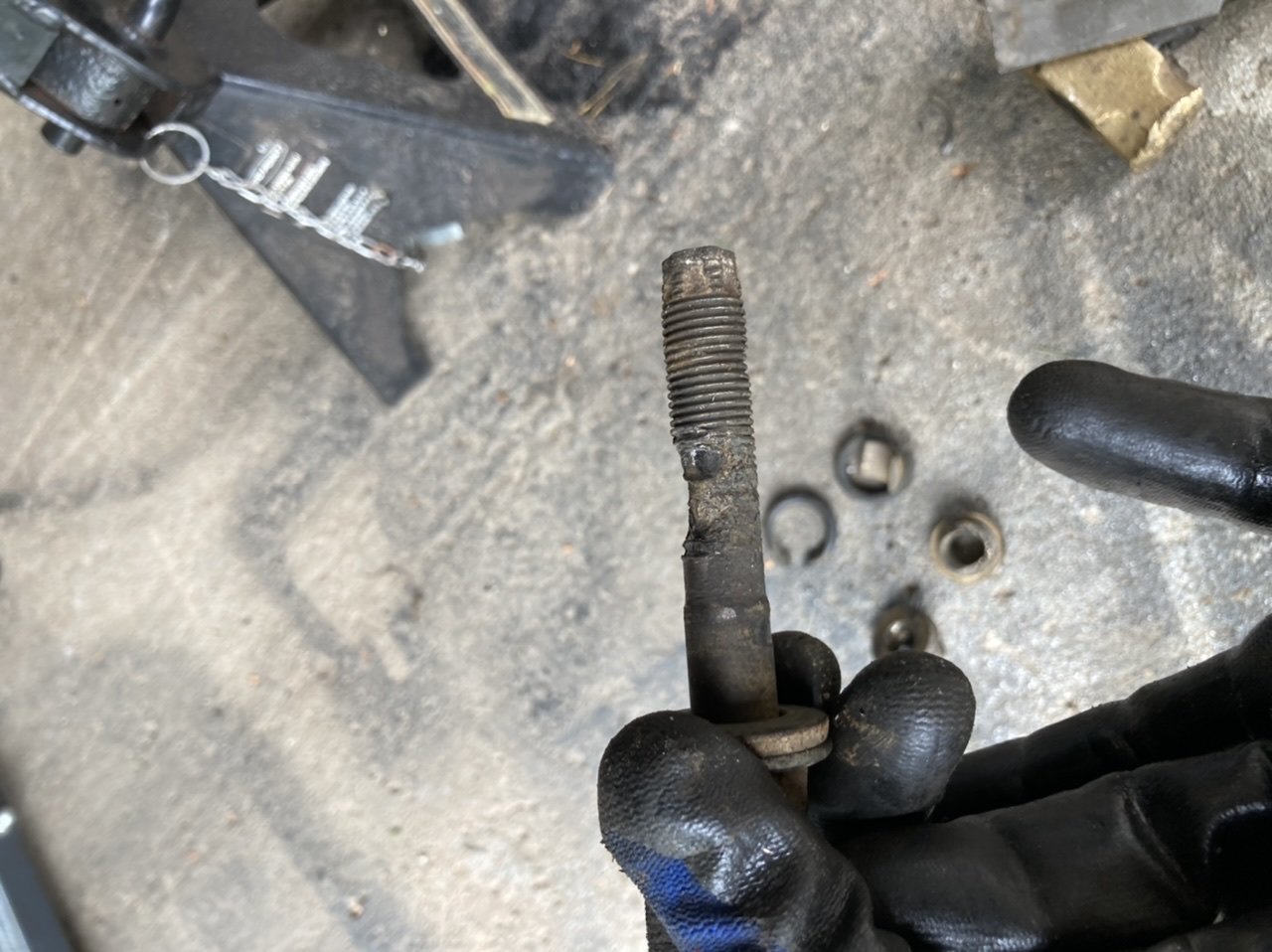

    Didn't last long, under 2 years and this, they told me to deal with Krave automotive which is further from Toronto then Quebec (where they shipped mine initially), go figure. Not happy. Probably backordered now with 128 months of wait time :bananadead: Fixed it with duct tape for the time being to move it around when need room in garage.

    Is that the lower mount bushings just destroyed??? I'm wondering if that's where all the clunks everyone has is from
